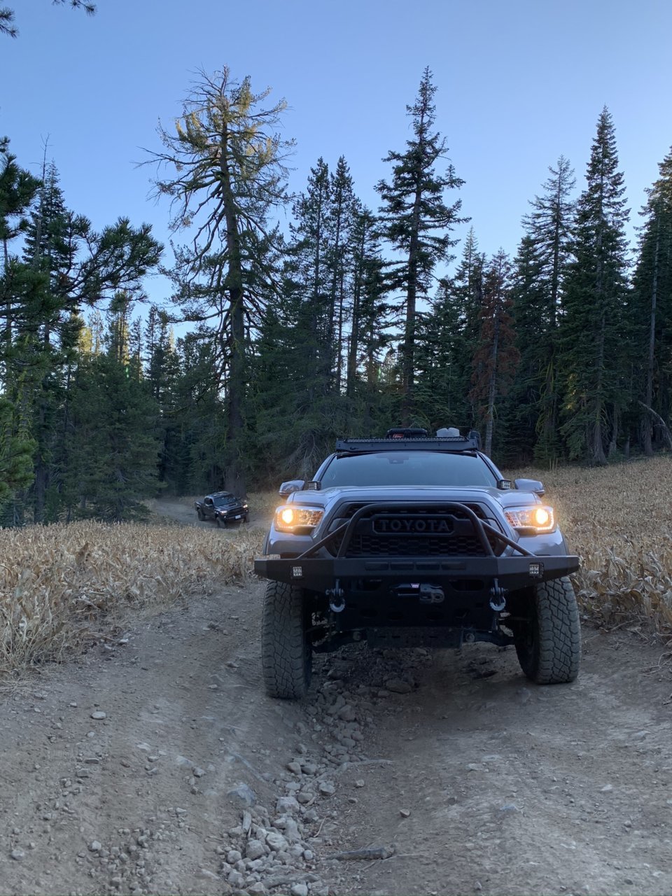

    I have about 50k on it. I replaced them because the driver side one was making noise and worn out and that’s what people recommended
    I understand where you are coming from but I don’t think that’s right. If you look at how these cracks are forming, they are starting at the bottom and also cracking at the top. That indicates that the sheet metal is being twisted or bending up and down (not just accounted for by extra battery weight). I believe that when you have the factory body mounts there is enough flex in them that they aren’t able to transmit the energy from the frame flexing to the sheet metal. But when I put the more rigid polyurethane bushings in there, that minimizes the flex and more rigidly connects the body to the frame. So the energy is now transmitted to the body and the sheet metal can’t take it.
    Even when my body mounts were shot I had no cracks. Within a year of switching them to poly it’s cracked to shit. I have read three or four threads on this and so far have not seen anyone say they are on factory body mounts and have cracks. Hopefully I’m wrong and it’s just bad luck!
    Here’s an example of much flex is going on in the frame. Look at the bumper gap on the passenger side vs the driver side. That is not there when the truck is flat and this pic is with factory bushings.
