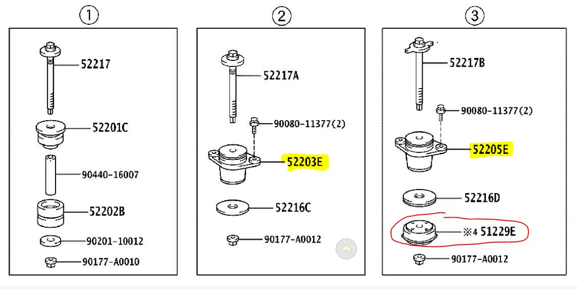

    If anyone has a link handy to the OEM front radiator bushings that'd be sweet

    Position 1 of the image below is all the components

    Note to those people ordering OEM body mounts. The front and rear cab mounts look identical, but are different durometer rubber. This alone should tell you there is engineering and flex built into the system. I don't know if front is harder or softer than rear, but I have my suspicions.
    Also, can anyone with a TRD offroad show/tell me what the part is that is circled in red? I have a sport, not familiar with why this part is in place. I know the bolt isn't extra long or different between the two, and this part goes on after the main thick washer so I don't think it changes how the bushing flexes? I dunno, but maybe it is some sort of stiffener or travel limiter that some of us could benefit from?

    I think that is the harmonic device to help with the diff whine. There is a TSB about it.

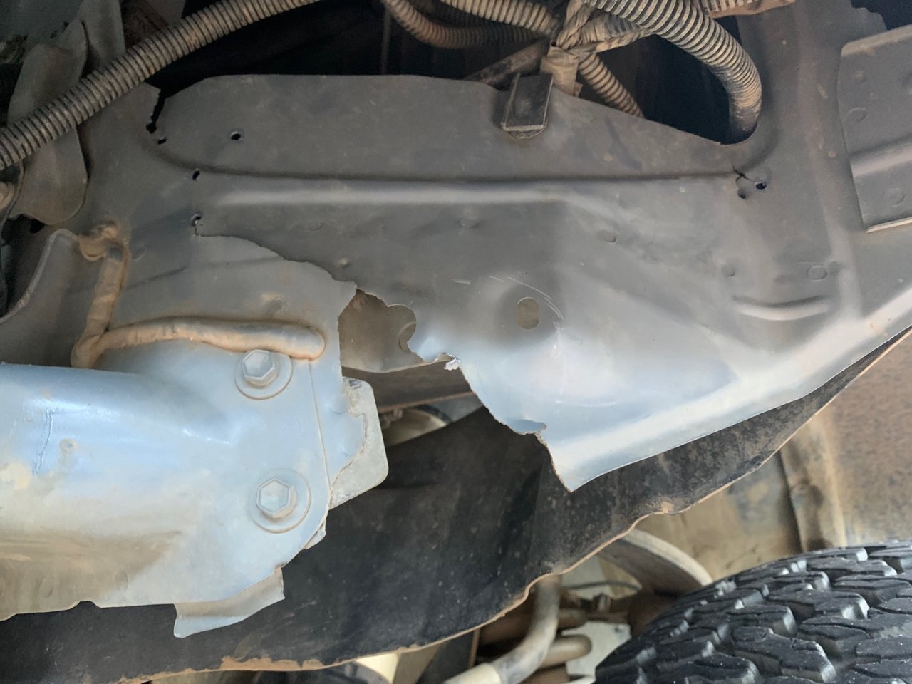

    My whole front core support cracked, and inner fenders cracked in half basically with oem bushings. Almost every plastic piece has cracked as well (headlight tabs broke off, grille hardly stays in, etc)
    Tubbed the front end and did poly mounts throught, no issues since. No creaks, way less body movement, and my front end doesnt flop around after fixing some of the clips/headlight falling out with zip ties.

    Got any info on the TSB? that part is nowhere near the diff, seems odd.

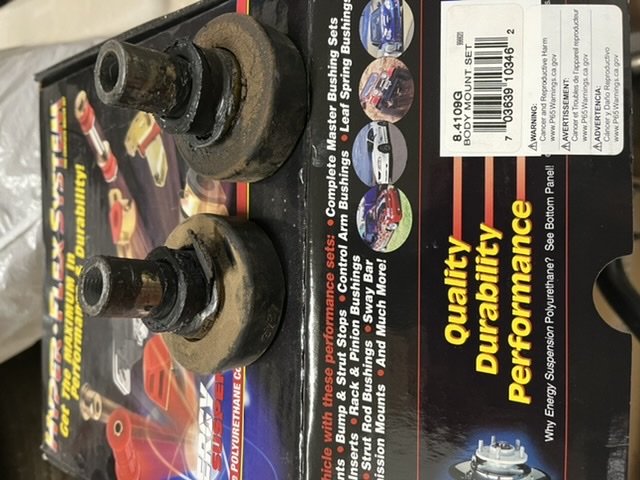

    I bought the kit, as well as the "universal" larger mounts for the rad core support. I hated it, not only did it make a shit ton of creaking and noise, but the bushings self destructed as well, and I saw a bunch of different issues related to cracking and such. Tried super lube, as well as torque values from 25 all the way to 85, no good, just sucky and noisy. Dunno what I did wrong, maybe they needed to be installed dry. The core support under the headlights started cracking like crazy fast with the poly in, presumably because the metal was forced to flex when the bushings didn't. The only reason I put a energy kit in was because I had a collapsed radiator bushing from a 'send it' accident, and I wanted a bit of body lift when I moved to 35's, figured poly was better, stronger, less flex, and get the body lift at the same time. My 4 cab mounts were fine, I should have just left those in and replaced the radiator core bushings. When I pulled the poly bushings out, I bought all new oem, and used some of the energy washers as my body lift. Never looked back
    If anyone wants my energy bushing kit that I took out, I'll gladly send it to you for the cost of shipping, maybe you can use a spare sleeve or puck... Also, if anyone has the poly bushings but wants to go back to stock, I'll help your cause by selling my old oem body mounts for cheap...
    Wow. That seems extreme. Glad the poly are working for you. I'd guess you have a different usage model, driving style, terrain, or you had severe mount degredation that allowed the cracking and breaking to happen. Maybe now with it all cracked up it flexes enough to not need the rubber bushings to do the flexing? I dunno. Yours is a good data point though, on the opposite end of the spectrum as me. My truck is really really heavy, full camping/expedition rig for family of 4, and I do ask a lot of it, but I'm rarely slamming it into rocks and high speed stuff to cause hard bottom outs or air time. So it is important to note that there is no one solution for all.

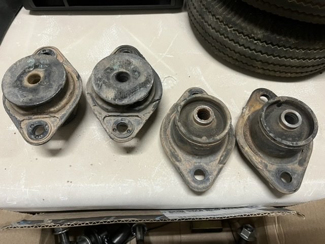

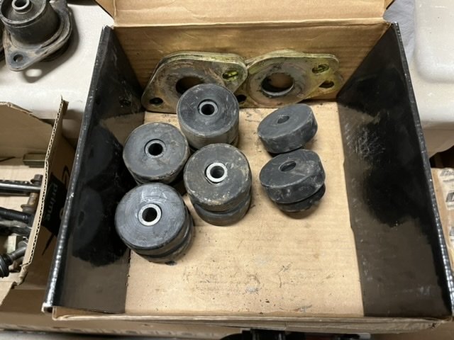

    54636906-D400-4B41-AAE6-B27D74D524E1.jpg B091E4B6-A6EF-4C29-BAFB-ED52B9EF5A28.jpg FD528F0D-D8F5-4E90-A694-E0AC1209C4BD.jpg
    Here is the stuff I took out. Let me know if anyone wants it. As you can see the energy kit didn’t work out that well for me, and the reliability (even if you have to replace stock core support bushings often) and simplicity of stock is way better than aftermarket. Although I do know I am in the minority, I say oem for the win on this one.

    thanks. I’ll look at the TSB. For the cost difference I’m surprised folks aren’t water jetting or plasma cutting new plates in small batches.
    Edit: the TSB is interesting, it is a active noise or harmonics damper, the TSB is for 2016-17 trucks only. Being a 2nd gen, and fuuuulllllly modified suspension and diff and drive shaft, I don't think I have any applicability to that TSB.

    Those are fine, but your sheet metal is beyond the point of no return. All that weight is sitting there and will just keep ripping the rest of it unless you patch it all up.
