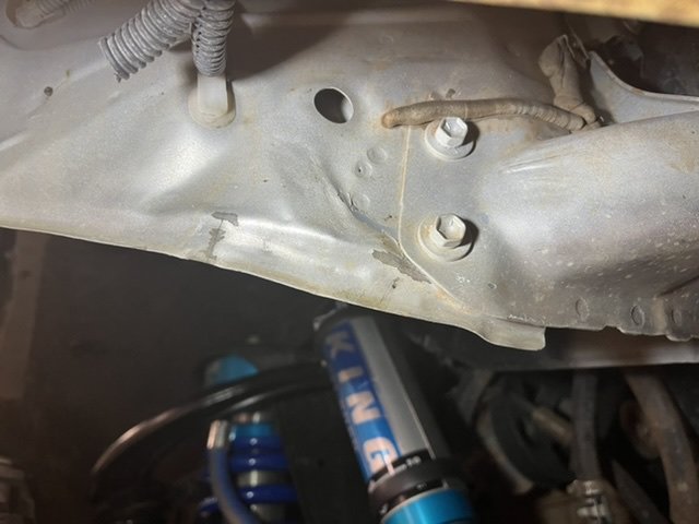

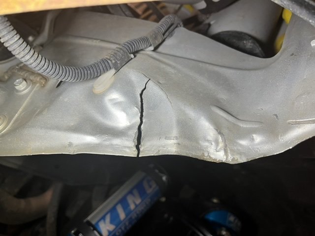

    Stop drilling can be more about how well the holes are drilled. Reaming them after drilling will reduce internal flaws that can create more cracks.
    I agree what @Buttskevin21 said also. You need to regain strength closer to the original edges.

    Cheers, thanks guys. Don't think there's any hope for getting a reamer in there w/out pulling the front end off. Planning on patching it up sometime this fall. Hopefully it holds up until then.

    Yours is worse than mine, although my cracking started where yours did. I'd agree there is no hope for that one and patching is probably a band aid at best. That is going to continue cracking right past the drillings. Seems like ordering those side panels and coming up with a plan on replacing them is in order for both of us. I was thinking of running a 3/16" or 1/4" rod from the bushing area, welded along the rolled edge across the bottom side of that wing, and tying into the fender area. I think that would stiffen up the section of metal that is flexing and cracking. I don't know if it would just shift the cracking to somewhere else though. Maybe I'll try that on my existing, and if it doesn't work well then I will be replacing the core support metal anyway...

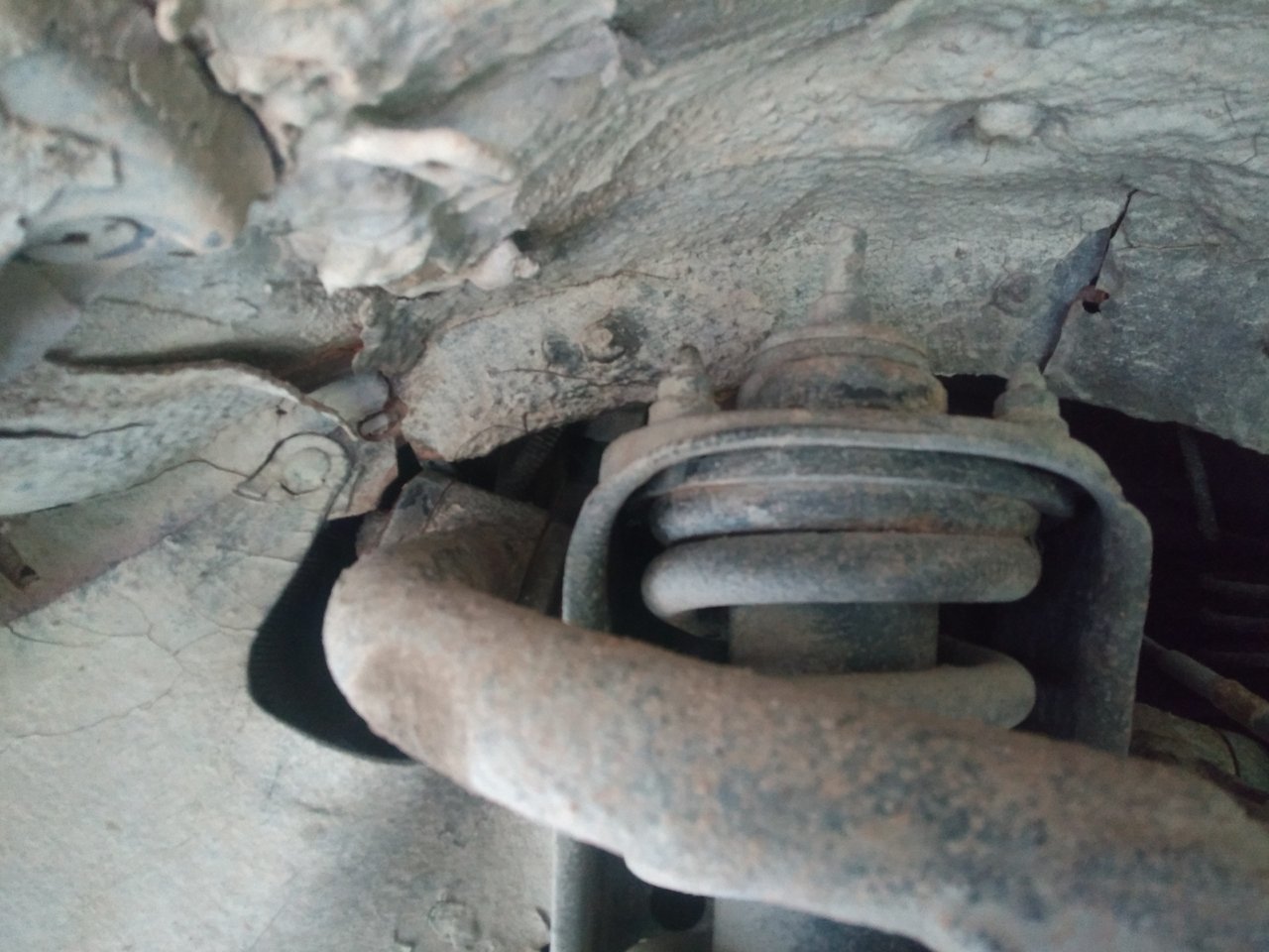

    https://www.carparts.com/radiator-support/replacement/T250120?dclid=CJGGn_Lr8e0CFa0pfgody9oH4Q
    I bought a core support, similar to this one. It doesn't appear to be as good of quality as the original, so it isn't a case of the aftermarket part being the identical part from the same factory/dies with a different brand name on it. The question though, is what to do. I think that replacing both side panels that are available is significantly more work than replacing the whole thing. Even though there are still spot welds to drill, there are way fewer, and either way you still have to take the entire front of the truck apart including of course the radiator, but also the air conditioning and trans cooler, whose lines pass through the openings.
    Is it worth it to put in a new aftermarket piece? The metal is thinner, not as well formed IMO. So if nothing else is done, it would tear easier than OEM. But starting with one that isn't cracked, and reinforce some with the steel rod around the perimeter/openings, as well as relocate the battery (in my case dual batteries), that might be better than trying to resurrect a stock cracked up one with patching and welding and body panel glue?
    What are your thoughts?
    edit: pics of mine. Mind you mine is 2005, 175k miles, and about 50k miles being heavy loaded expedition type stuff. About 100 miles with poly bushings where the majority of this damage happened, but it did start when there was a collapsed oem core support bushing:
    E6B72B6D-916A-4E34-8C65-0446C5188A43.jpg 80C262A4-2812-4275-957B-6192E06FD045.jpg
    Much less damage on passenger side, it didn’t suffer as bad of bushing damage at the 150k miles point like drivers side did. And, I don’t have cracking I can see coming down from headlight yet or on the upper tie bar across the top yet. What would you do?
