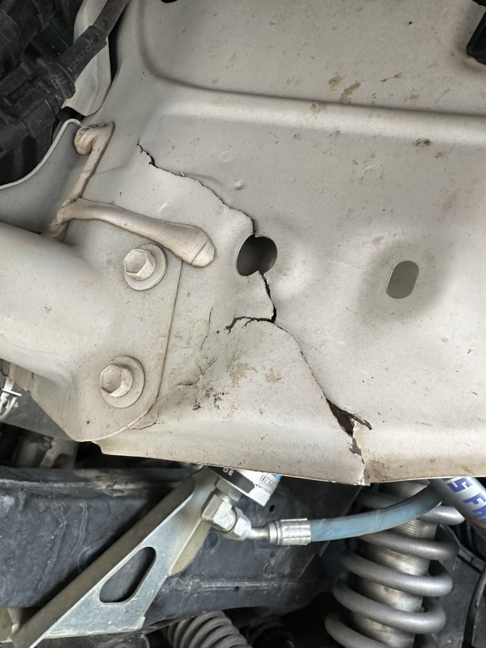

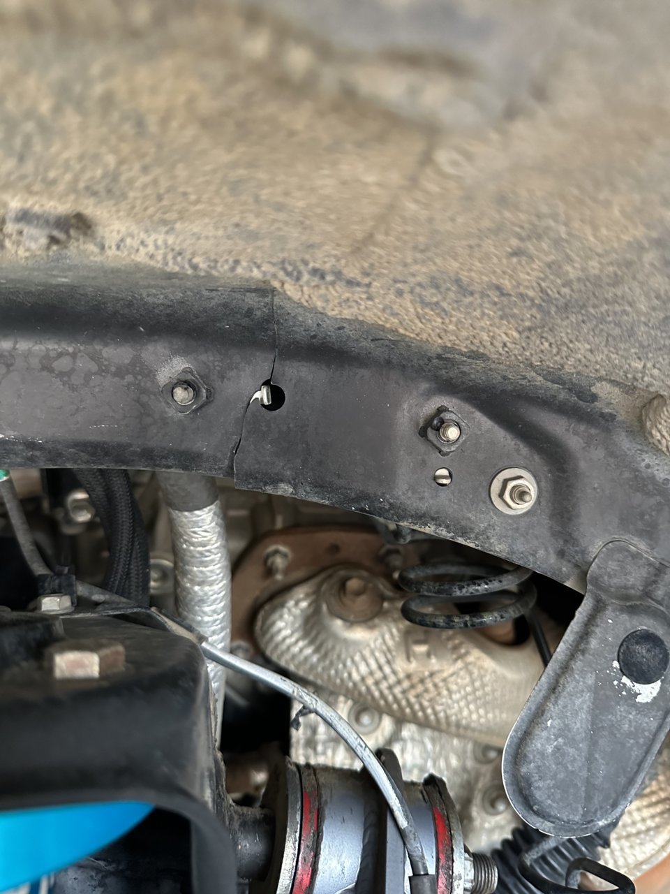

    Installed new OEM bushings and patched up the cracks with some 22ga sheet metal. I used 3M DP420 epoxy to adhere the patches instead of welding given what I’ve read about other people’s luck with welding on that. Those are epoxy drips by the way, my quick spray paint job isn’t THAT bad :D
    I also took a closer look at those body mount bushings. There is a lot more engineering than I had considered before. It seems they are specifically tuned for a certain amount of compliance given the different diameters, asymmetric lengths, and different durometer materials.

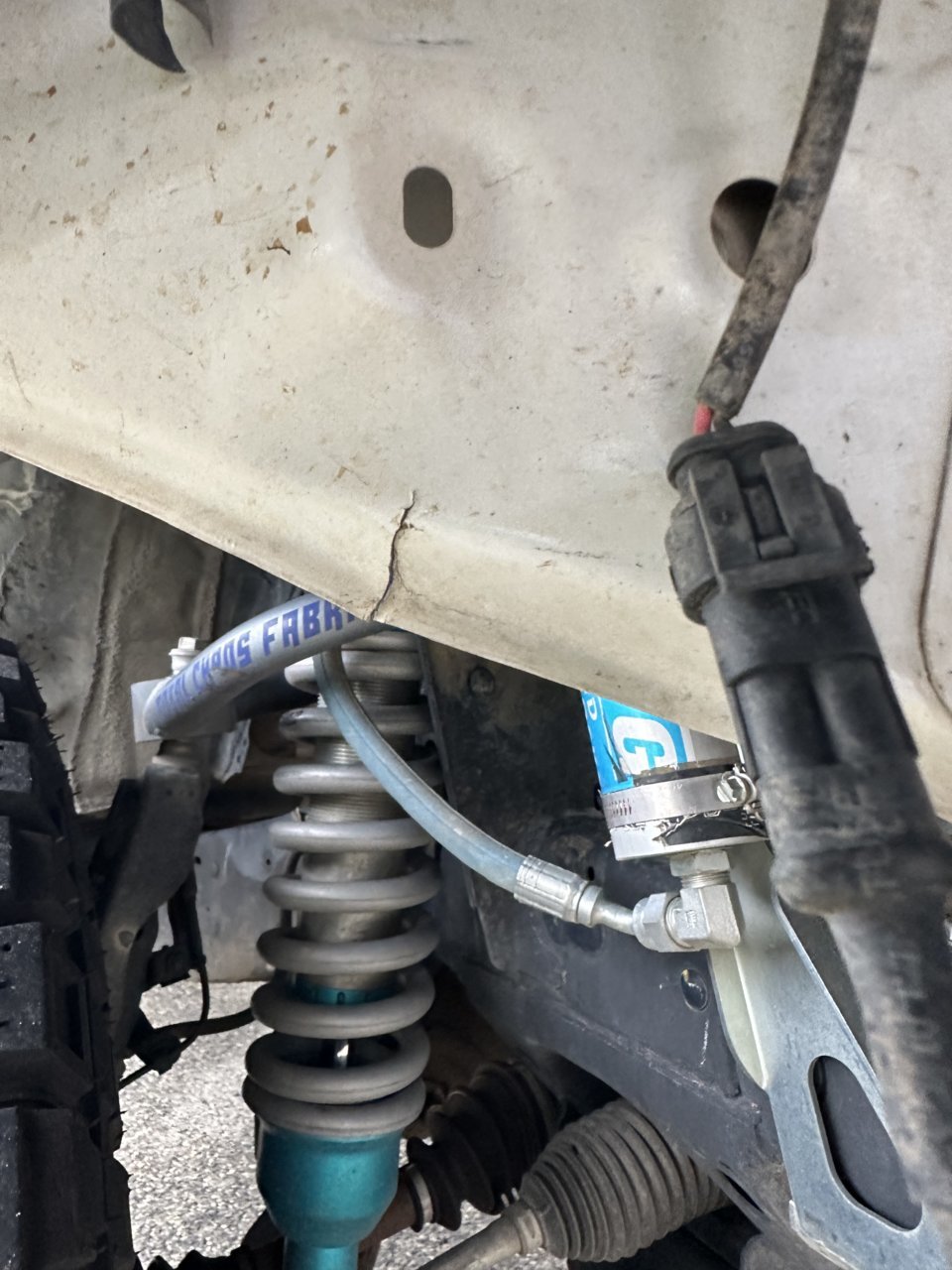

    Nope, even with an access cab it will still end up tearing.
    AF6E5DCB-8002-450F-97D0-58EAD00373A7.jpg 9BDC1E4C-81B0-4395-B242-F99A59A4CC21.jpg E2132D41-3941-4CD1-A063-4CBF1D0AE3AD.jpg
