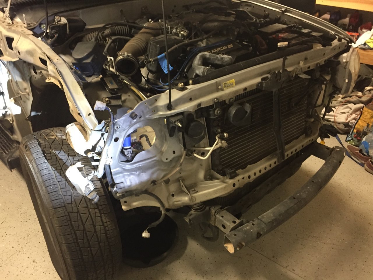

    Does anyone have a picture of the complete structure? I'm having a hard time seeing how this is all put together. I'd look, but they kicked me off the lot last time.

    Here's a couple pics that paint a picture. The radiator core support is one big ass piece, spot welded in place I believe. It'd be a PITA to replace it.

    So the core support is tryingng to move independently of the rest of the body?

    You can't stop it once it has already started. At this point the name of the game is patching and band aiding the trouble areas until you can either afford and or have the time to rectify the issue entirely with an engine cage.
    I've been driving on a damaged core support bulkhead since 2014. Tons of cracks everywhere but since relocating the battery and doing the bushings the issue has not gotten any worse. I did, however, pull the vehicle from off-road duty since that time.
    If I were you I would do the same until you can cage it if it is your DD.

    cut back to fire wall and build engine cage with core supports. Tie it into the cab cage down the road if u must.

    Plated it and relocated the battery
    no cracks since

    Yes they did, then they doubled it up and all issues stopped.

    Yes it was but it was from the same problem, flex and weight out front.

    I beat the hell out of my rig, 98k and not a single issue like this!! I did upgrade the radiator support bushings @30k when I did all my mods, highly recommend as that is a weak link on 2nd and 3rd gen trucks.
