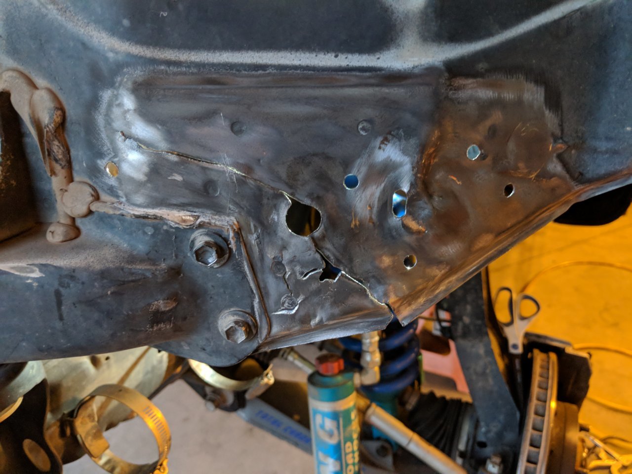

    So I pulled the front end apart last night to get a better looks around. As I suspected, the only pieces that are cracked are the pieces I previously mentioned, the cleverly named "side panel". PN 53029-04010 and PN 53028-04010.
    There are 8 spot welds holding each panel on. My plan is to drill out the center of the spot weld so I can pull out the cracked pieces. I will then be able to place in the new side panels with 1/4-20 SS hardware or something of the sorts. The only modification I will be making to the side panels will be to add a thin strip (1/4"-1/2") of 16 ga sheet metal to the edges of the panels to hopefully prevent tearing on the edges which leads to much larger cracks.
    My thought behind doing this is nothing will be overly reinforced which should hopefully prevent the next weakest link from "going out" thus minimize gremlins.
    Thoughts? Good Idea or am I hopelessly optimistic?

    Its pointless. Only way to stop the cracking below the headlights is to plate the whole area like I previously showed. Adding a strip will either just concentrate the fatigue to the center of the area below the headlight or just crack through the strip.
    Realistically the cracks won't affect most people and those that do have cracks, won't grow very fast. Mine appeared to grow about 3/4" over 400+ miles of dirt abuse. Most people won't do 100miles of dirt in a year.
