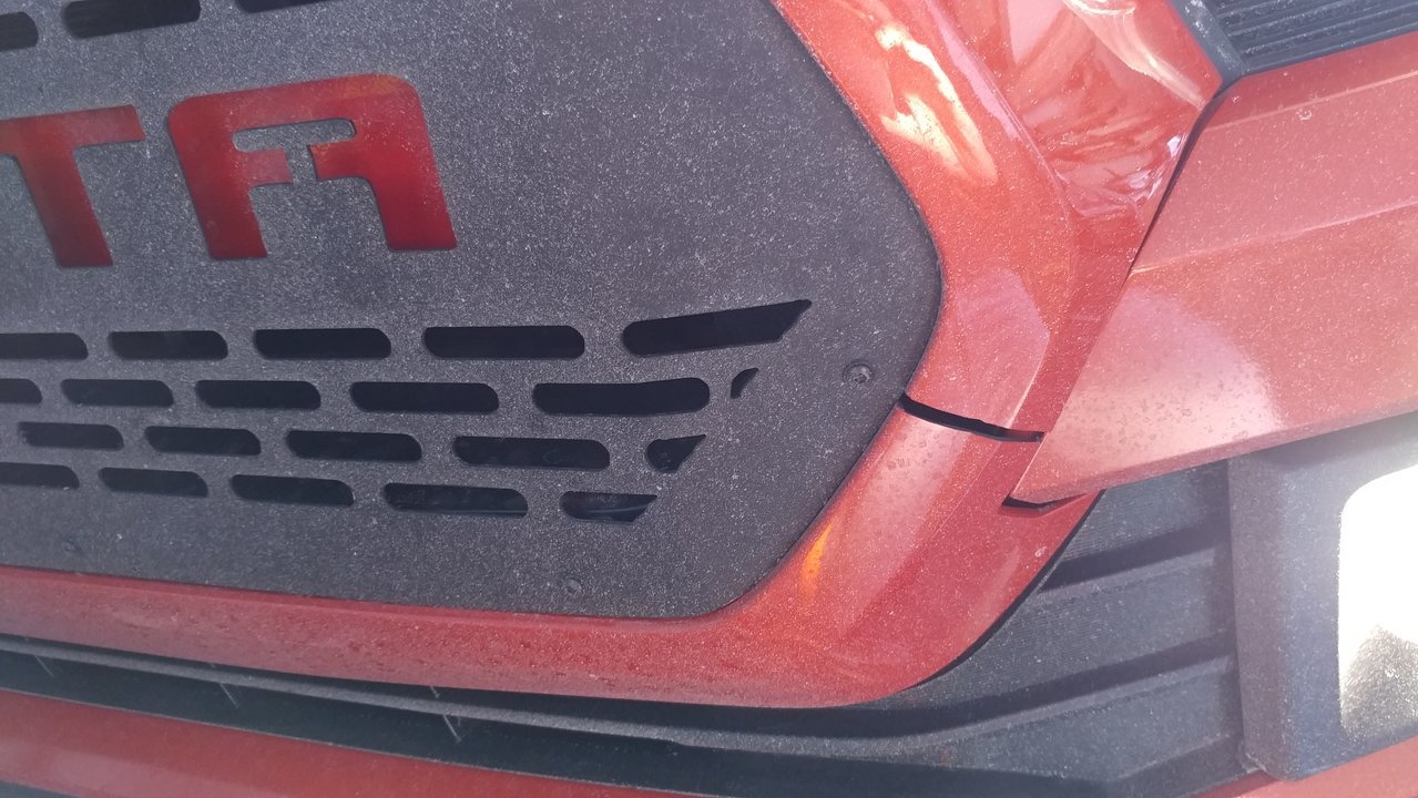

  12. Jan 3, 2018 at 6:31 AM
    #52
    Rownan
    Rownan Well-Known Member
    Jul 22, 2016
    #192637
    485
    Tim
    Highland, MI
    '17 OR DCSB 6MT *Quicksand*
    Sorry to bump an old thread but I wanted to add mine to the list of affected.
    It's been super cold up here for a few weeks now. No ice buildup at all on mine though. Just one day it cracked. I've had my BAMF grille in for about 6 months.

    Bummer! Exact same spot as well! :annoyed:

    This happened to my 2016 with bamf grill right before I traded it on a 2017

    Sounds like it is the BAMF grille + low temps that is doing the cracking. Not seeing this on any stock grilles.

  17. Jan 6, 2018 at 7:00 AM
    #57
    Kreitzmtaco
    Kreitzmtaco Well-Known Member
    Aug 18, 2016
    #194898
    137
    Canton, Ohio
    17 Taco TRD OR/DCSB, Prem & Tech, JBL,& Tow
    I joined the cracked grill surround club this morning. I figured I was ok since it hadn't cracked by now. Fuuuuuuuuq. I would definitely not suggest a BAMF grill if you live in cold areas.
    Interesting how it is always the same spot too. Well, guess I will have to fork out $400 for a surround. Definitely will be ditching this grill when I do so I can hopefully get back some money.

  18. Jan 6, 2018 at 7:11 AM
    #58
    MESO
    MESO Major Modder Vendor
    Feb 16, 2015
    #148809
    16,292
    State of Jefferson
    2016 DCLB TRD HELLCAT SWAP
    For sure. Plastic heats/shrinks in temp change.. And with beefy grill it's not going to give. Another reason could be the BAMF is a reallly tight fit to the factory surround. I think if they designed it with ~1/16" gap all the way around it might be ok.

  19. Jan 6, 2018 at 7:55 AM
    #59
    ELT2JV
    ELT2JV Well-Known Member
    Jan 6, 2018
    #240411
    117
    17 TRD OR ACLB
    8112 front 8100 rear. Method NV with 265/75/16 KO2.
    Any of you guys with cracked grills have steel or aluminum? Mines aluminum and doing fine so far

    Joe
    Colorado Springs
    Ford F350, Lexus RX450h, FZJ80, Jeep YJ, Jeep LJ
    Probably doesn’t matter.
    I had a BAMF grill and it never made it on the truck. During the install with the plastic surround the fit was so shitty I knew just by trying to install it that it would create too much stress on the plastic. Sold it the same day.
    shakerhood likes this.
