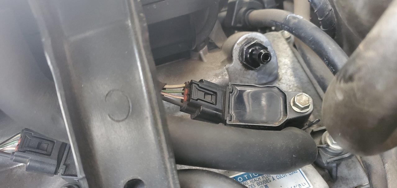

    Everyone,
    So I was tightening my new pcv valve and when I got to the end, I heard a small pop noise. Lord and behold I noticed a small crack just below the pcv valve. It is tiny but I am worried. Can I use jb weld to repair this crack since it is small?

    It's worth a shot, the valve cover is likely damaged.
    So cram as much jb weld in, thread in the pcv, then after it cures, run it and see if there's a vacuum leak from the crack.

    The crack is under the pcv valve, it didn't even affect the actual pcv and threading. Would I be able to drive for a day and fix after work?

    I don't see why not, just be aware it may leak some oil and/or vacuum and/or set an engine light if it is leaking vacuum.

    In that case, I'll apply the jb weld tomorrow after work. Thanks for the input.

    I have not replaced mine?
    But I think a lot of PCV are NPT tapered thread?
    I bet that’s what did, the tighter you crank on it, the more you are “wedging” the hole open in the valve cover. About park plug tight is good enough for me on PCV.
    Basically, once you JB weld it. Don’t crank it down again:thumbsup:
    BTW, don’t feel bad man. We all make mistakes.
    Who knows, maybe your cover was weak?

    Everyone, I cleaned the area and then applied the jb weld using a cotton swab. It should hold up well.
    It's the coating under the valve
