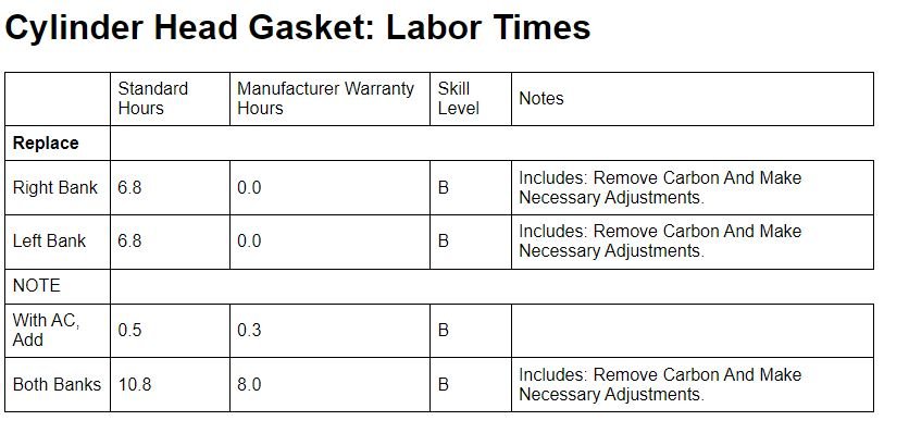

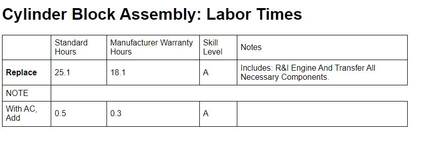

  2. Mar 4, 2024 at 9:37 AM
    #22
    mechanicjon
    mechanicjon They call me "Jonny Stubs"
    Dec 2, 2016
    #203828
    10,149
    Jon
    Scottsdale Arizona
    04 Taco SC 4dr SR5 TRD Prerunner
    Supercharged, AEM FIC/6, Meth Inj, ION Alloy's, Radio & Phone steering Wheel controls,Fabtech AAL, Billie's wrapped with 880's , Tundra big brake conversion, bully bars and Pioneer DDin Stereo/dvd with exterrnal usb ports. 290K and going strong.

  4. Mar 5, 2024 at 2:36 PM
    #24
    ControlCar
    ControlCar My Moto: Help & Learn…period.
    Jul 22, 2023
    #429578
    3,491
    Steven
    Sugar Land TX
    1996 Taco 2.4L 2wd Automatic
    Clock Volt meter/LSPV Delete/Hyundai 16’s/FP gauge/after 9months of wrenching ZERO oil leaks
    thanks so much for link.......Pure Gold.
    saved on favorites
    mechanicjon likes this.
