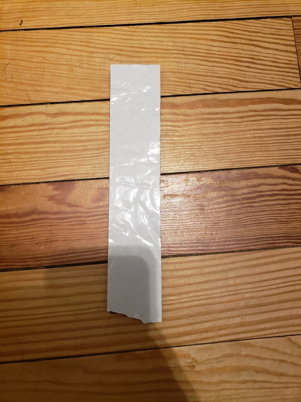

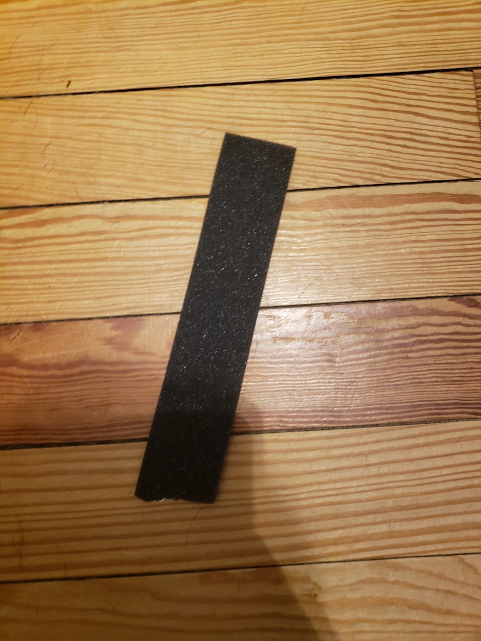

    I know this is an old post and really my first post on the site, but I felt compelled to post this. I have had the truck for four months-ish. This sound drove me nuts. I spend two hours a day in my truck and couldn't help but focus on the sound. Brought my truck in for its 20k checkup and finally had a tech that also has a Taco and knew exactly what I was explaining. This piece of foam is the cause of the sound. They cut it out of the A pillar and spray foamed it. Gone. Fixed. If you crinkle this foam because of the plastic on the back it makes the exact sound everybody is explaining. It meets the glove box, A pillar, speaker housing on passengers side. Hope it helps.
