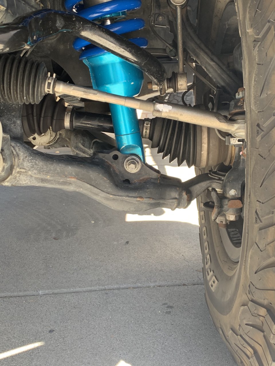

    D492B151-D01E-4503-B655-6D7899B5A498.jpg Here is a picture of the truck parked. Honestly it Doesn’t look that bad.
  5. Aug 24, 2019 at 3:42 PM
    #25
    tcjacado
    tcjacado Well-Known Member
    Aug 29, 2016
    #195947
    41,570
    When its parked it looks ok, but when its articulating as you are driving it is going beyond its limits.

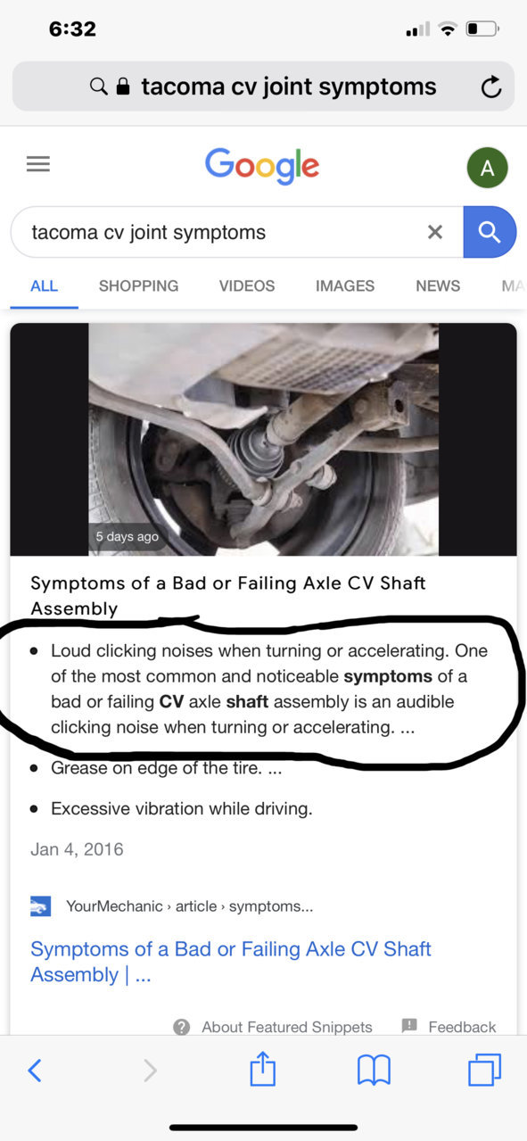

    787B76CD-E3CF-4052-9702-5D83C4F4B63A.jpg Clicking noise
  14. Aug 24, 2019 at 6:36 PM
    #34
    EatSleepTacos
    Mar 24, 2015
    #151688
    59,838
    Randy
    West Valley, AZ
    2017 4Runner
    Ha, alright man, good luck. You seem to have it all figured out.

  15. Aug 24, 2019 at 6:49 PM
    #35
    AramsTRD
    AramsTRD [OP] Well-Known Member
    Mar 25, 2017
    #214326
    548
    Aram
    North Hollywood
    2017 Tacoma Silver Sky Off Road 4X4
    6k LED headlights Baja Design Squadron Sport R fog lights CaliRaised Ditch Brackets w/ Baja Designs Squadron Amber Baja Designs Squadron Pro flush mount on Rear Bumper Kings 2.5 with Resi’s Front and Rear Icon Tubular UCA’s with Delta’s OME Dakars Leaf Springs Timbren U-Bolts Flips kit with Timbren Bumpstops Demello Offraod Front Bumper Smittybilt Winch9500lbs W/ Synthetic Rope TRD PRO Skid Plate for the front Pelfrey Mid, Rear and Gas Tank Skids Pelfrey Rear Bumper with Wilco Tire Carrier Welded on SCS F5’s 16x8 -25mm Wheels BFG KO2's 285 75 16 Prinsu Cabrac AllPro Rock sliders Import Equipment Red & Dark Grey Light Decals
    Not trying to say your wrong man, just I have checked everything possible and the only thing left is the CV axle.
    I took off the sway bar and nothing changed.
    I reTorqued every bolt possible, greased UCA’s.
    The only thing left is the CV
