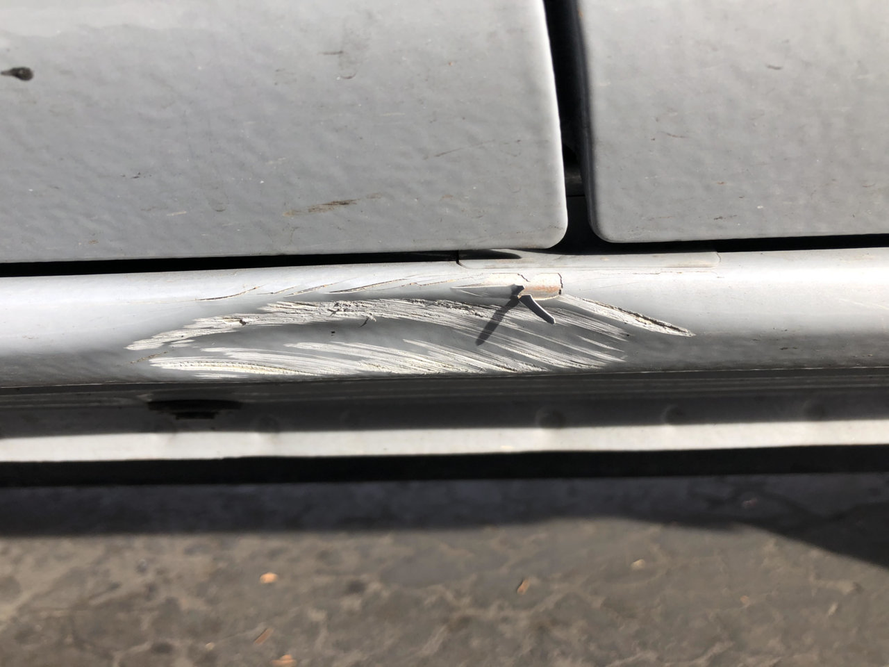

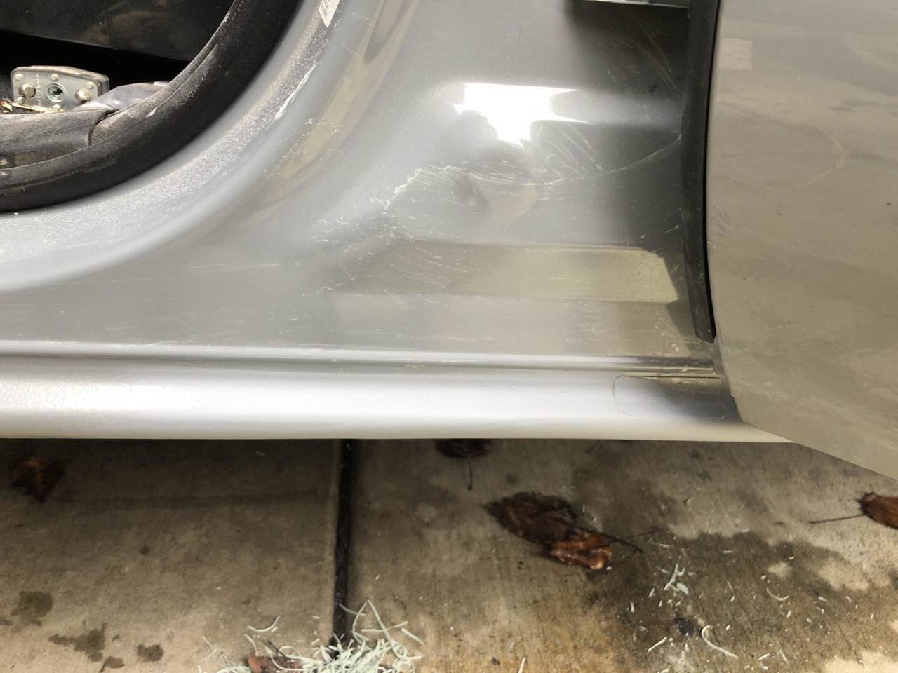

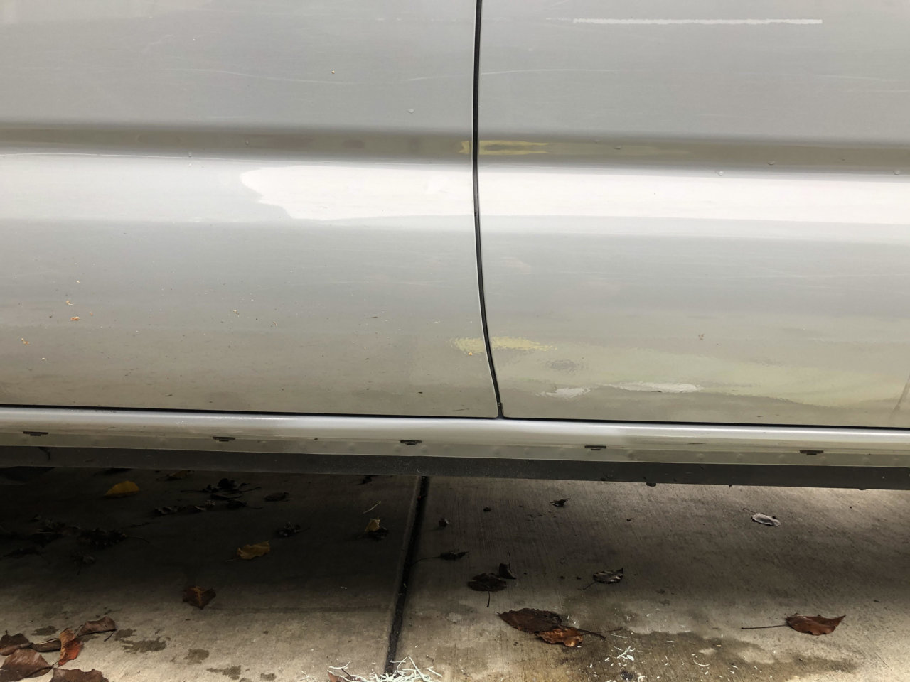

    Soo.. My cheap ass hired a guy from craigslist to fix dent.... costing me $400. The dealership was charging me $1,200. I really regret that decision..... cheap work ain't good work.... I know I know I should've bought sliders.... :(
    before
    after

    I mean, it doesnt look bad, if it was shiny I bet no would notice.
    EDIT, make sure you pop the rubber plugs out of the rocker and spray the living hell out of it with fluid film or some sort of rust preventer. Any paint cracking on the front will also have paint cracking on the back.

    Looks like they just slathered the Bondo on

    That's pretty thick. Tempted to say get it redone because Bondo that thick can fail. But it can also be fine. Just keep an eye on it.
    Throw some 20 degree sliders on it. That will help hide it and protect from future bumps

    he did poke some holes and pulled out the dent. then put some bondo.

    water will get in there eventually, just the moisture in the air will cause rust
    But, since there was enough metal bending to crack the paint on the outside, I would spray fluid film up in there to cover any area that may of cracked.
