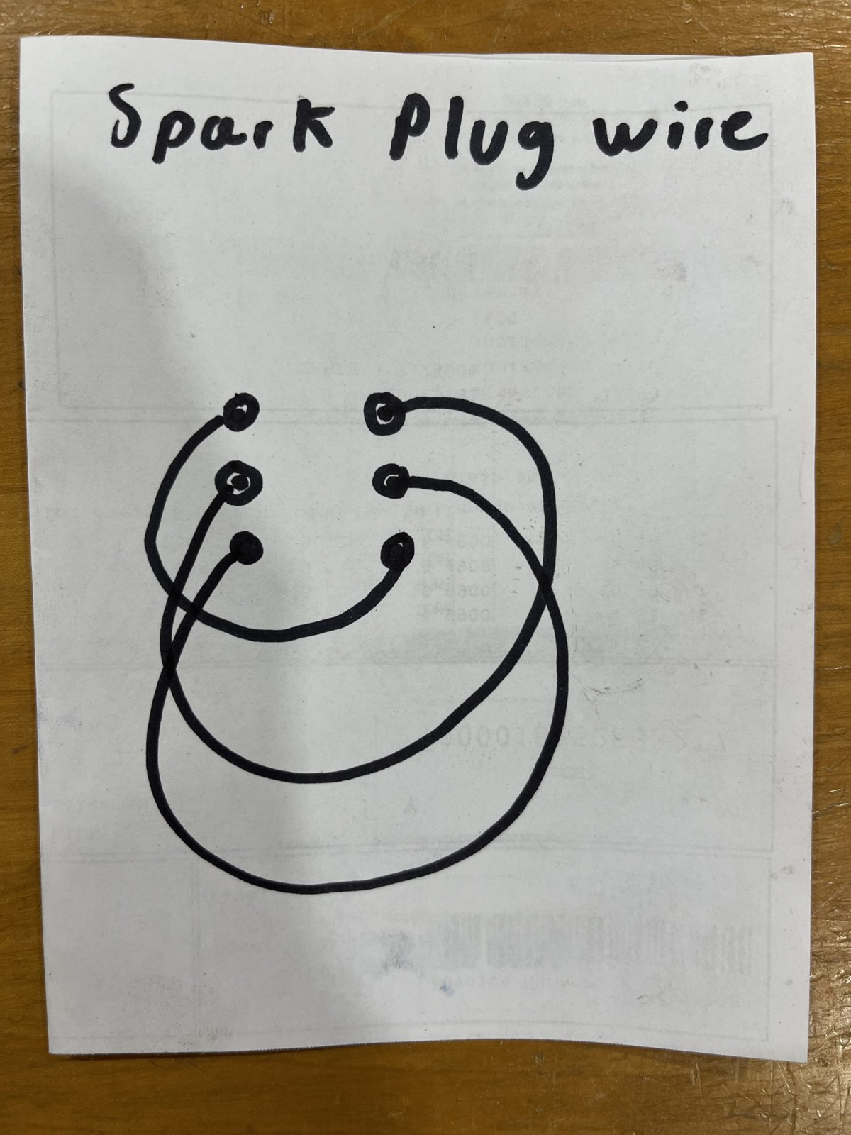

    Hello! I drive a '97 3.4L V6 manual 5-speed Xtra cab Tacoma, and I just replaced the valve cover gasket seals on it, but the engine would crank without starting when I turned the key in the ignition. I took off the intake runners again and checked my electrical connections, but everything seemed to be in order, and then I sealed her back up. Now she cranks slow and rough and still won't start. Any ideas what it might be? I made sure the ground wires are attached and quadruple checked the plug wire routing, and I'm at a loss.

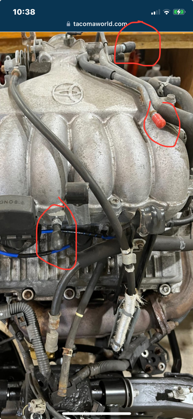

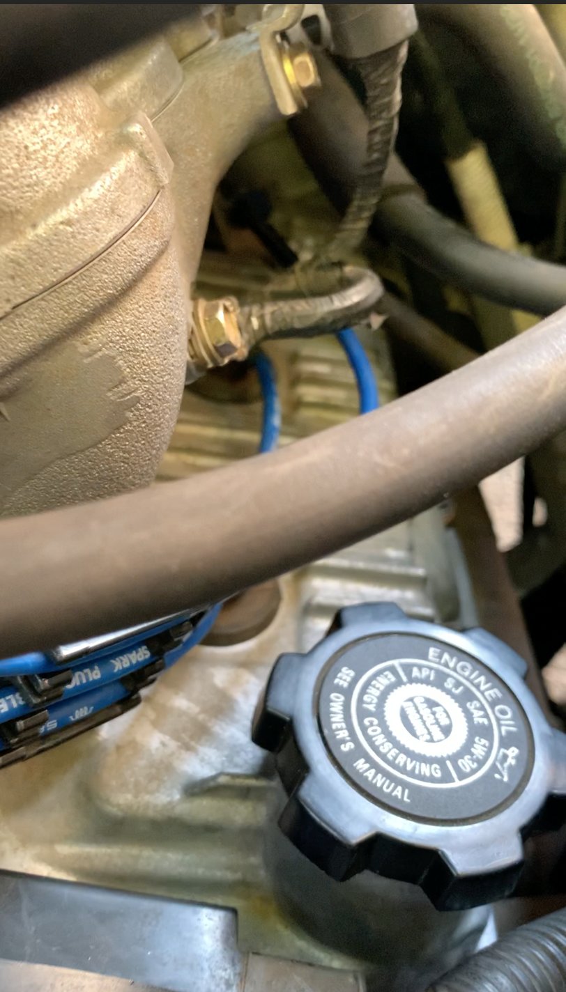

    Verify you reconnected the grounds on the right side of the air intake plenum. Some people miss those on re-install.
    *pictured below from an old photo

    Yeah it's right below the diagnostic port.
    Have you triple checked your plug wire routing, and basically everything you touched or disconnected to make sure it's all back correctly? if it ran before... it still should now.

    I did, yeah. Quadruple checked the plug wires. It did manage to start up for about a second, once, if that helps. I'm just at a loss what the problem could be.

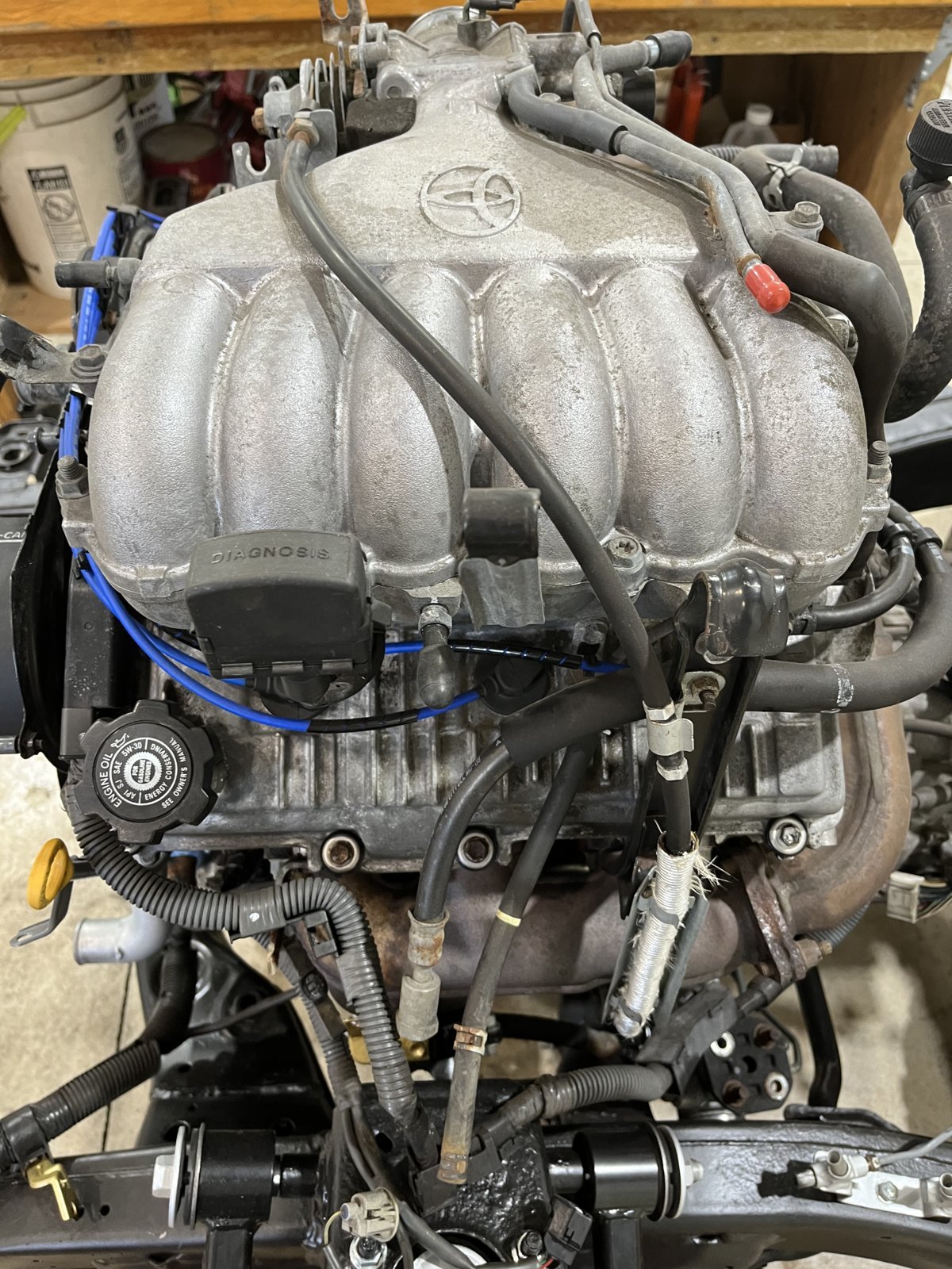

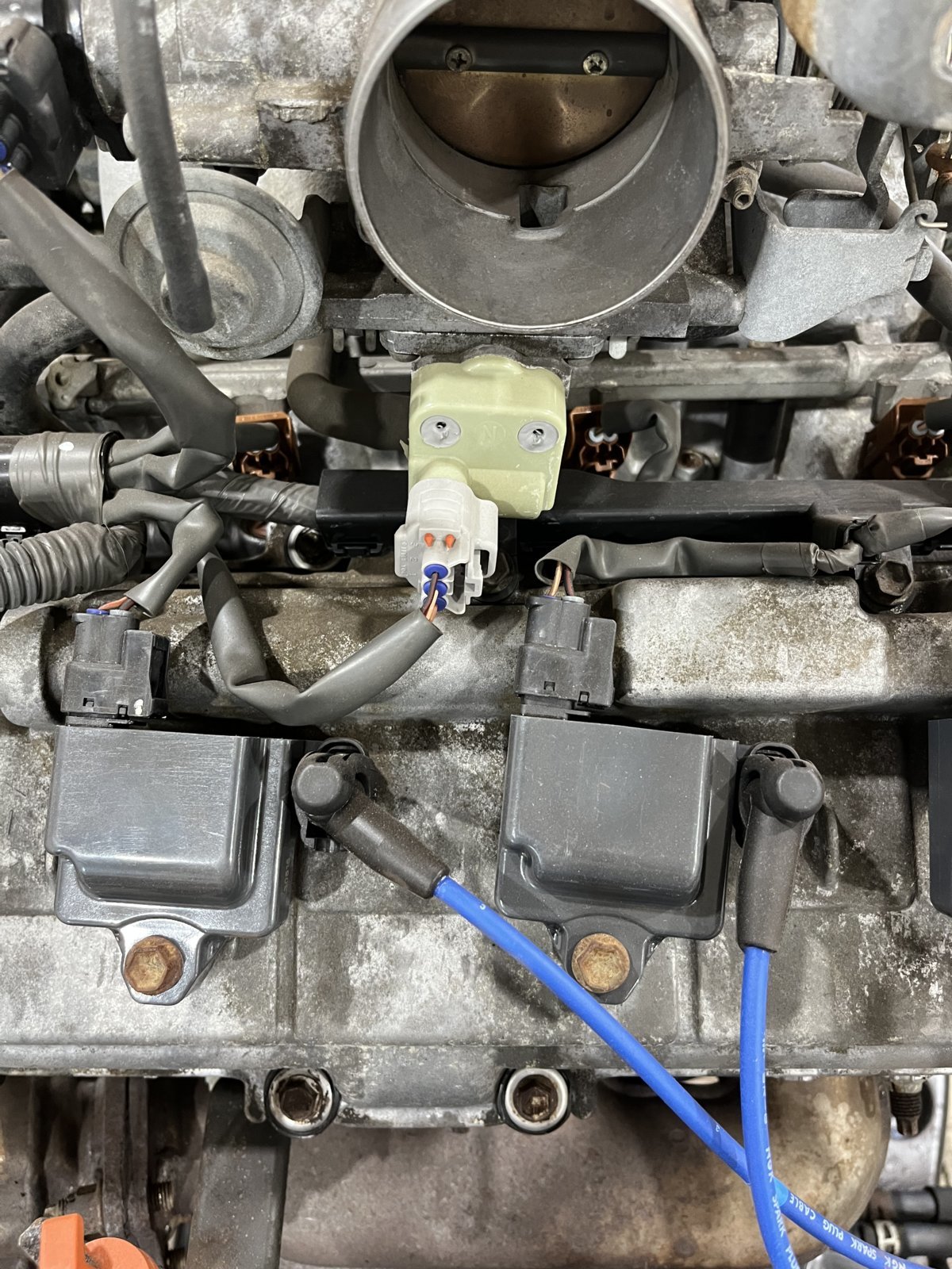

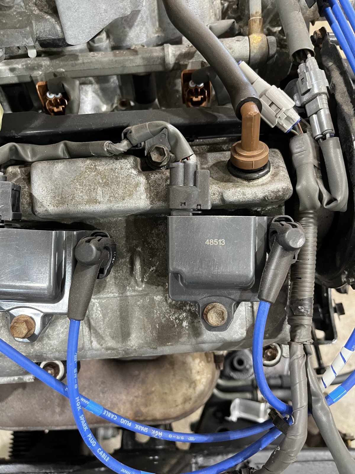

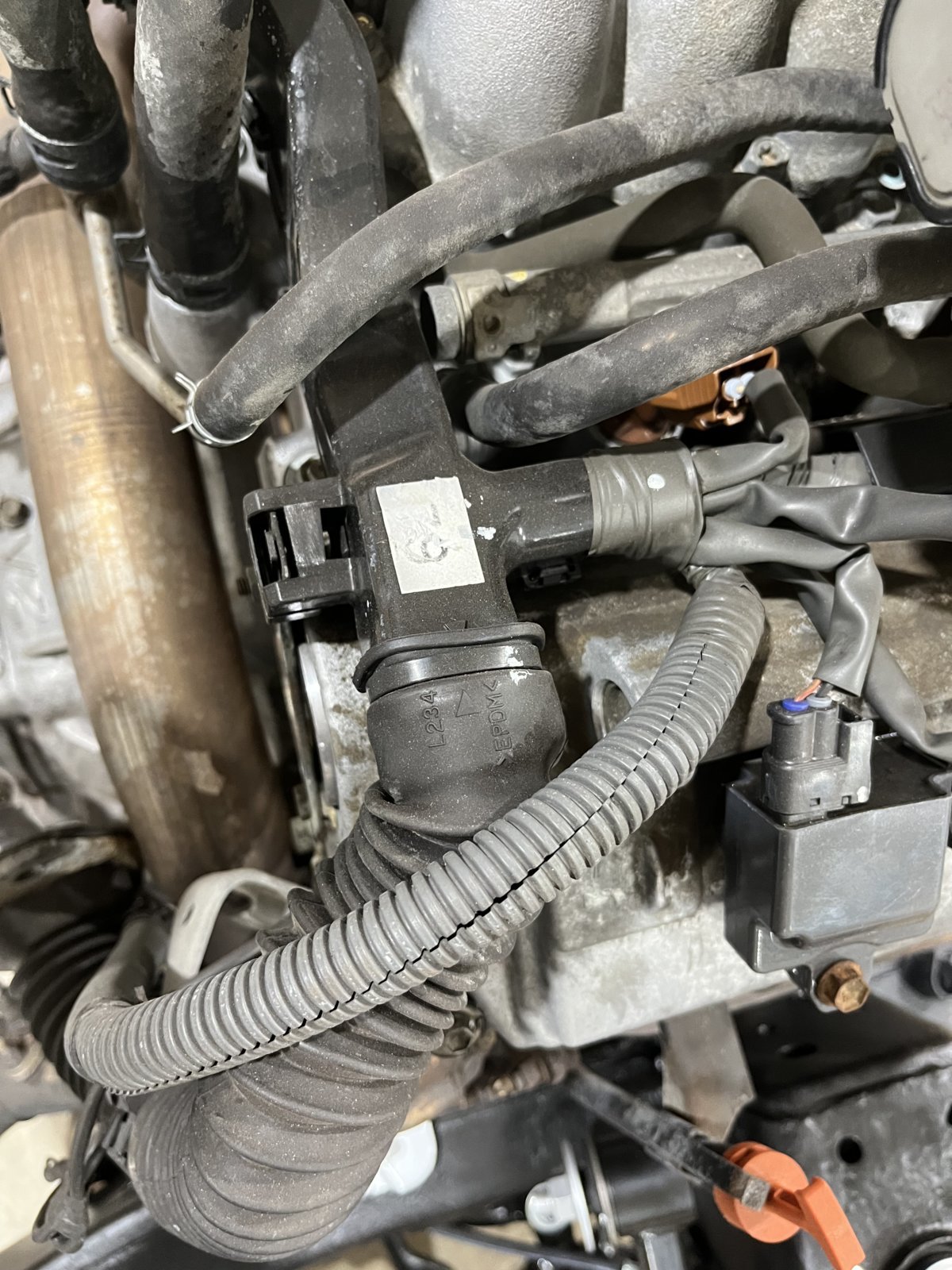

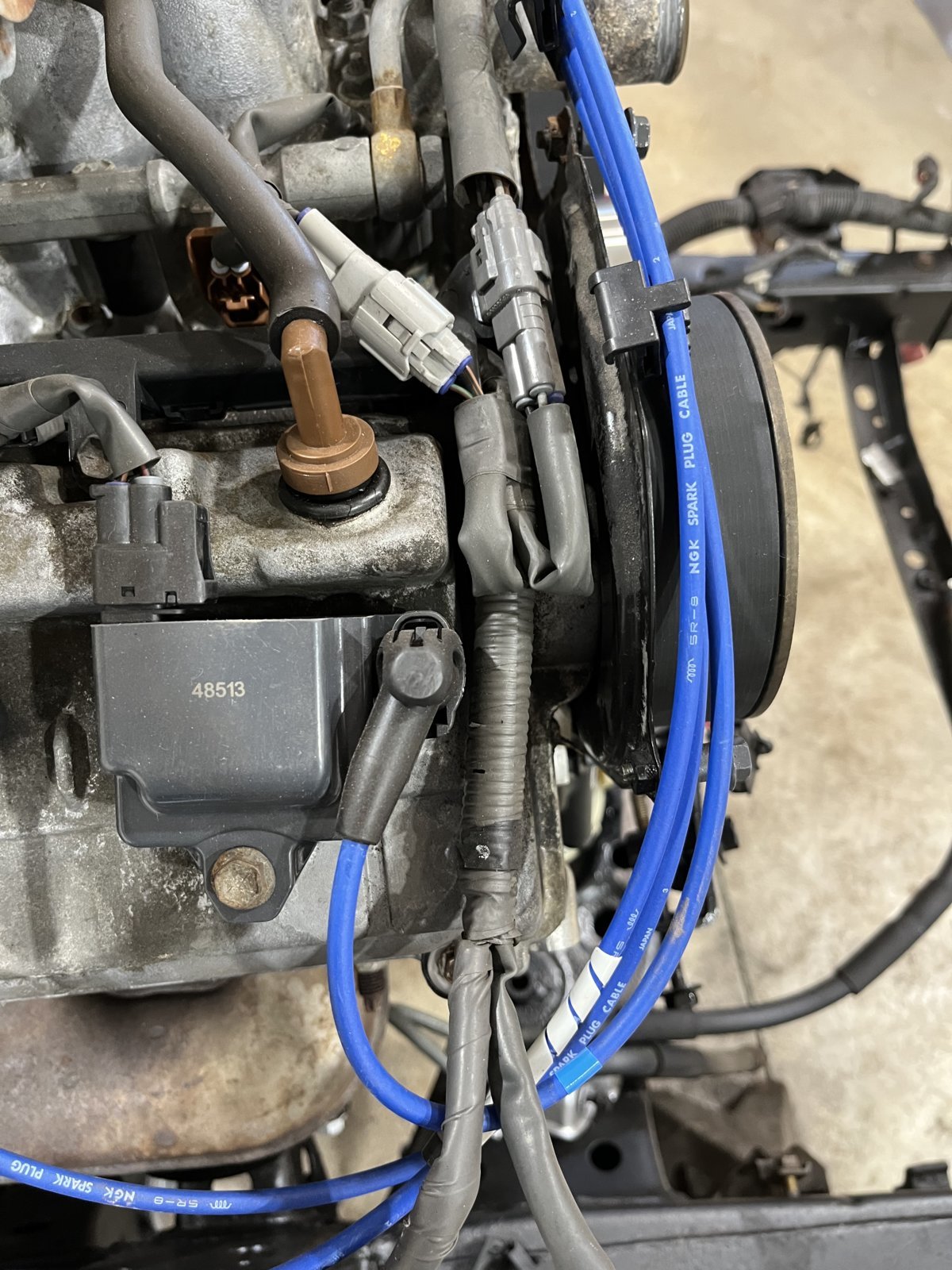

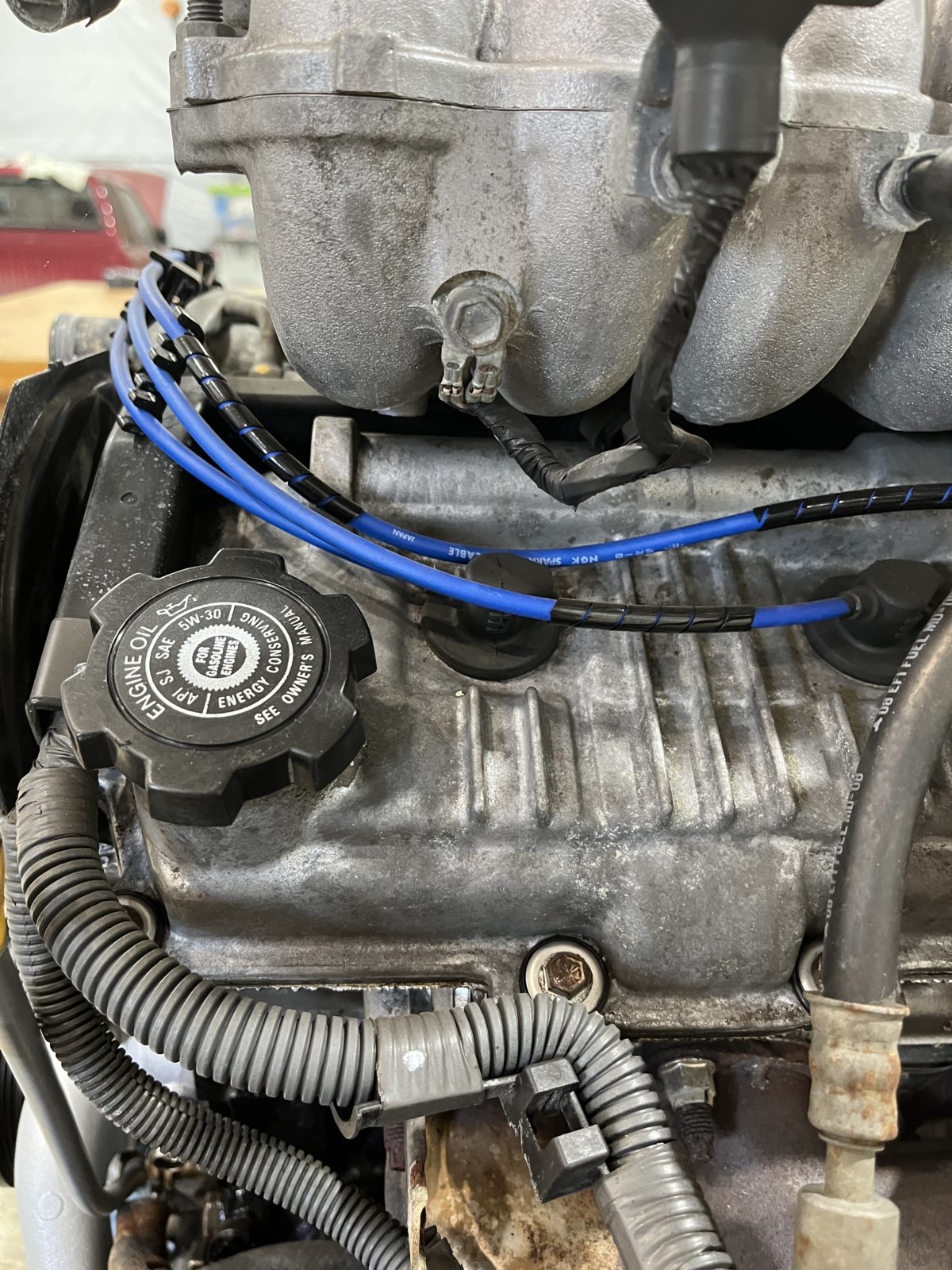

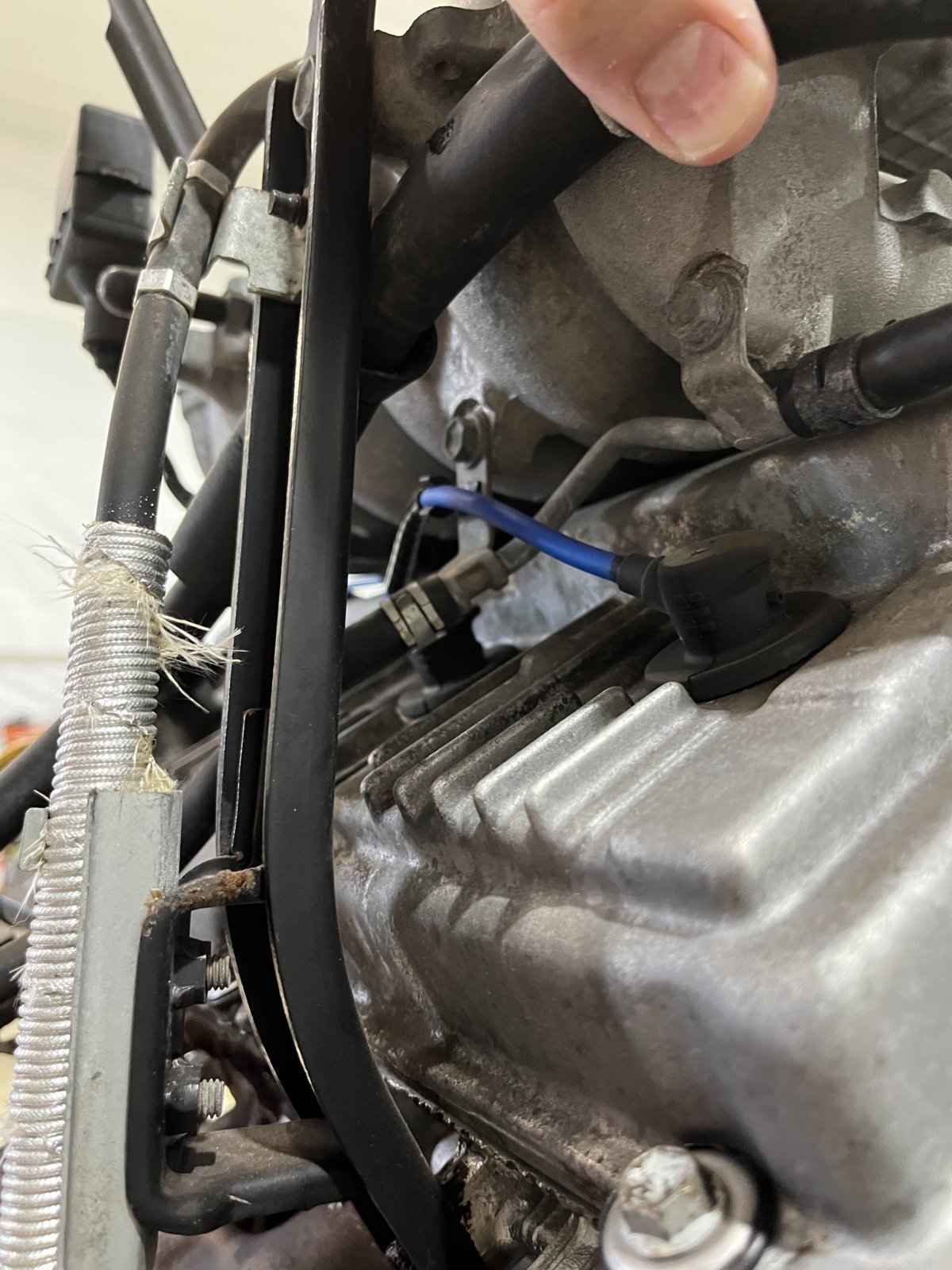

    Hupload_2024-3-6_21-22-51.jpgupload_2024-3-6_21-22-51.jpgupload_2024-3-6_21-22-51.jpgupload_2024-3-6_21-22-51.jpgupload_2024-3-6_21-22-51.jpgupload_2024-3-6_21-22-51.jpgupload_2024-3-6_21-22-51.jpgupload_2024-3-6_21-22-51.jpgupload_2024-3-6_21-22-51.jpg
    Here’s some pics of a 2000 3.4
    Thought maybe it could help.
    I know there are some differences between years.
    You’ll figure it out don’t just take your time and think it through.

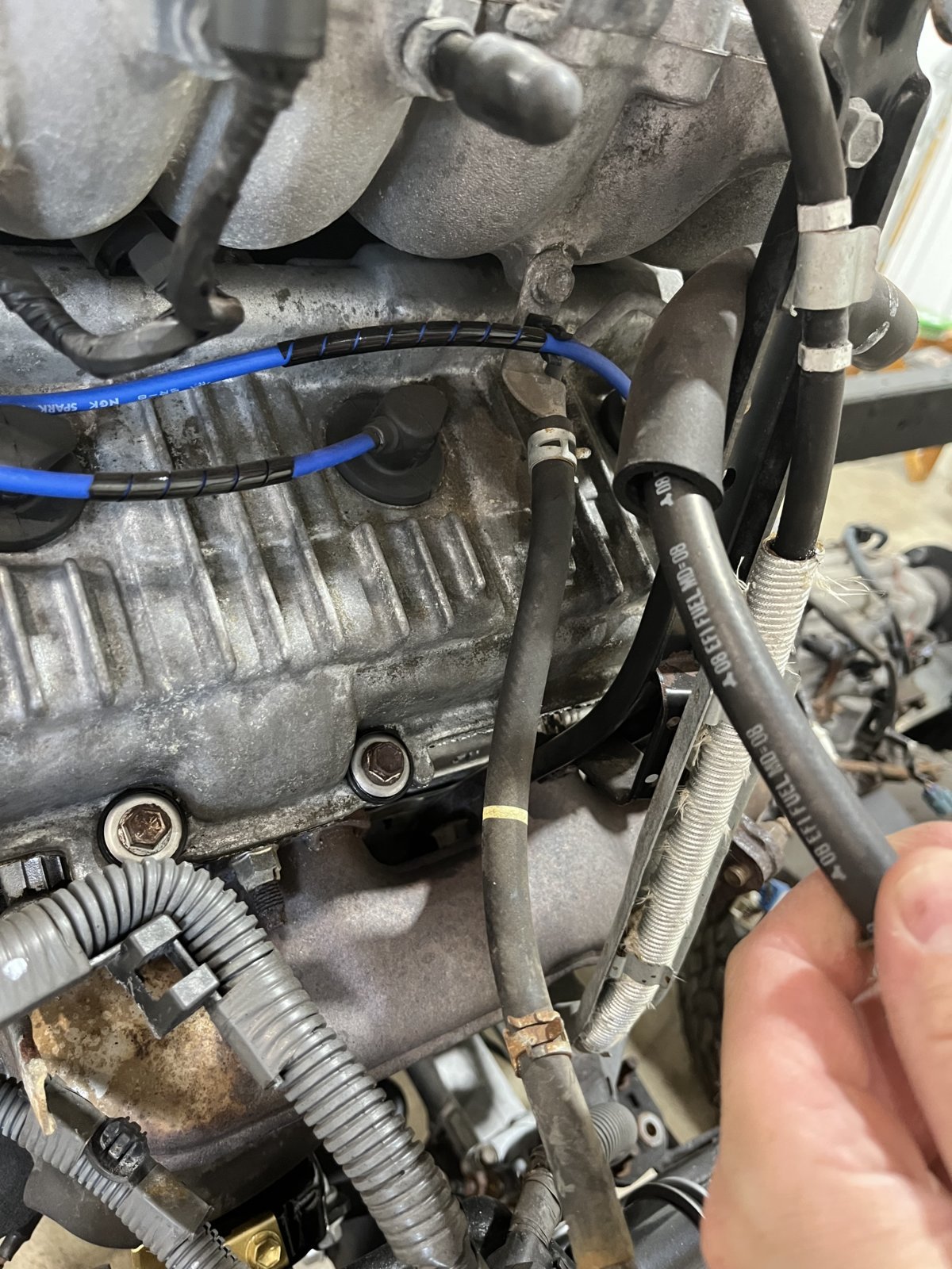

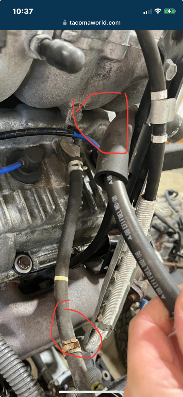

    This hose?

    I saw that clamp….
    But
    Assuming vacuum hose…would that cause no start?

    Most likely not. But I looked pretty good at the pictures. So I thought

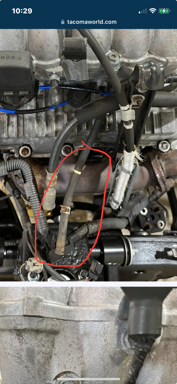

    IMG_3963.jpg If you follow rubber line….goes up to hard line

    This also concerning

    I think those pictures are for him to reference. Not his project.
    that motor is on a stand
