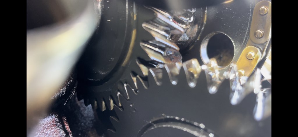

    Sorry I'm late to the party but this gear appears timed wrong, there are multiple dots on them and I don't believe this big dot coordinates with the two small ones, it should be another small one on the gear on the left that lines up

    I'm comparing some pictures and I think you're right....
    I hope I haven't caused any damage trying to start it like this

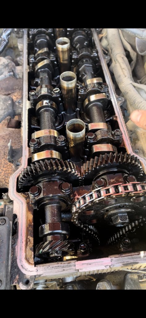

    I actually just went back and looked at all the pictures I've taken and noticed that the day I pulled the camshaft (assuming it was in the right position since the car ran prior) and the double dot was lined up with the biggest dot on the intake cam gear. The lobes also correspond to how other people's 3RZs look at TDC.
    Also looking at the other dots on the intake gear I couldnt see a way where they would meet up with the double dot on the exhaust gear at TDC.
    Am I missing something here?
