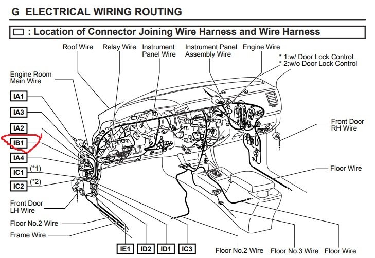

    The fuel pump is powered by the C-OPN Relay.
    You can check power going to the fuel pump at Connector IB1 Pin 8 (Black/Red) behind the left kick panel, I'll have to post the location of it when I get home unless @TnShooter is around he might have it.

    Here you go, should have power at IB1 Pin 8 (Black/Red) while cranking.

    sorry for not replying but these diagrams helped me out a lot. Checked the IB1 pin and it did have power when cranking. Looked over everything again last night and still could not figure out what was wrong with it. I tried starting it this morning… and it started right up. I shut it off 4 time and it started up with no issue. So now what the hell do I go off of? It’s running like it wasn’t just sitting for 3 days not starting. So now I’m worried it won’t start a week or so from now lol.

    Maybe the IB1 connector was loose or not making good contact?
    Maybe you fixed the issue?
    All you can do now is wait and see.
    Hopefully it's fixed......:confused:

    I was going to comment the same.. I seem to recall reading a very select number of issues over the years with IB1 corrosion or poor contact
    But if that were the case it should have started last night after re-seating the connector?

    Yeah, he said he checked the connector for power.
    But the truck wont crank with the connector unplugged.
    I wasn't sure if he actually tried to start the truck last night after checking?
    He never said, maybe he will post back a tell us if he had the problem AFTER plugging the connector back in?
