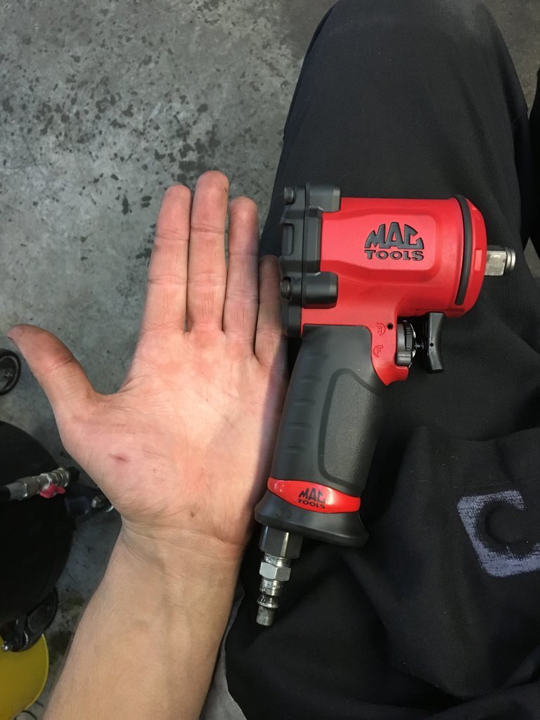

    My mini 1/2 mac gun took it off in one button press no problem (645 ft lbs of off power) when i Torqued the bolt down all I did was have a co worker put a flat head screwdriver through one of the opening's in the pulley and push against the engine. He held with both hands and click, Did 205 ft lbs no problem on that thing.
    Whoring out new tools :p

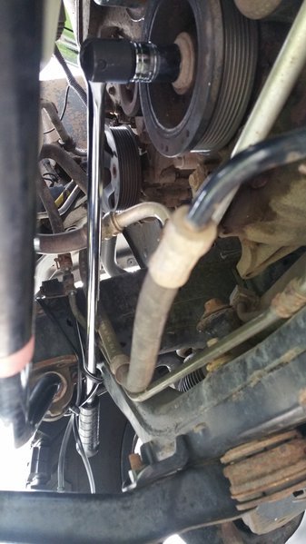

    I also had to removed the crank shaft pulley. I tried a half inch impact and it didnt have enough ummpgh.. So I did the ole breakerbar on the frame trick. Worked like a champ. On the 2005+ tacoma's. You need to put the bar on the top of the drivers side of the frame, or the bottom of the passenger side of the frame. I actually used a breaker bar, and a pipe slid through the handle.

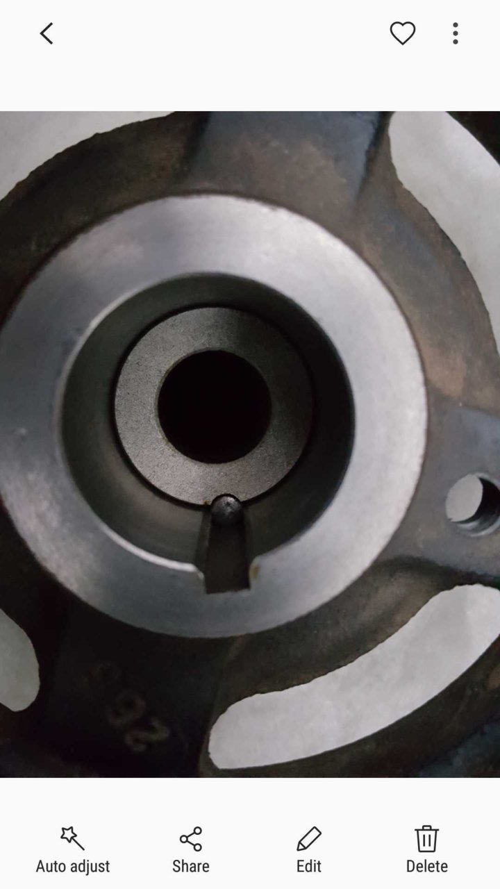

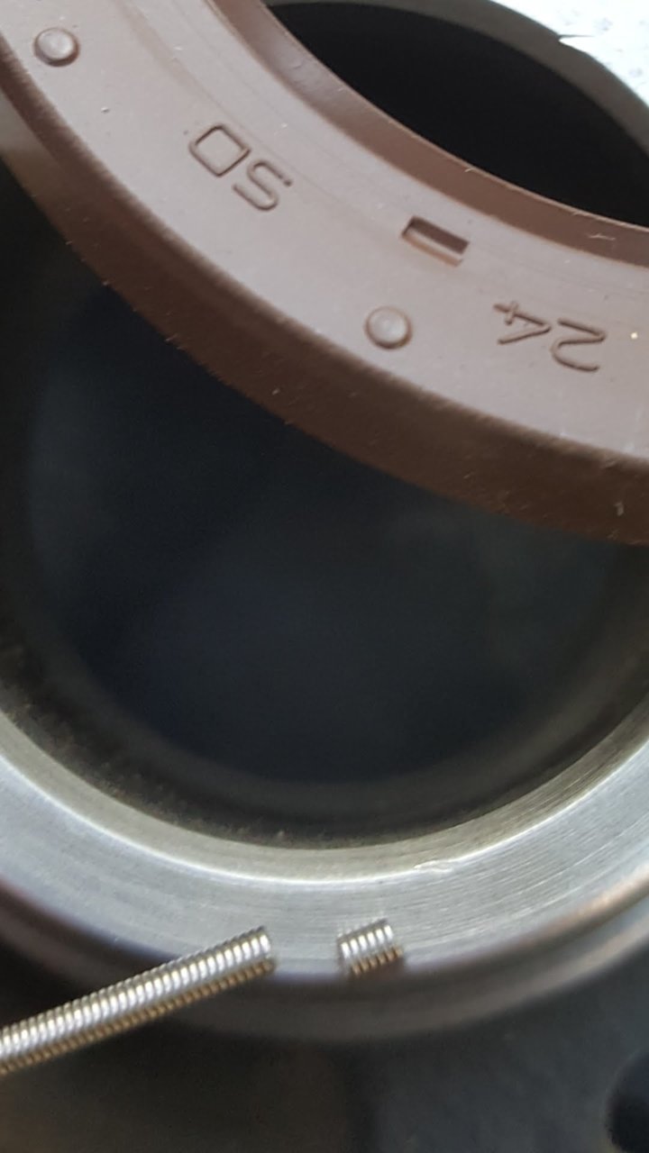

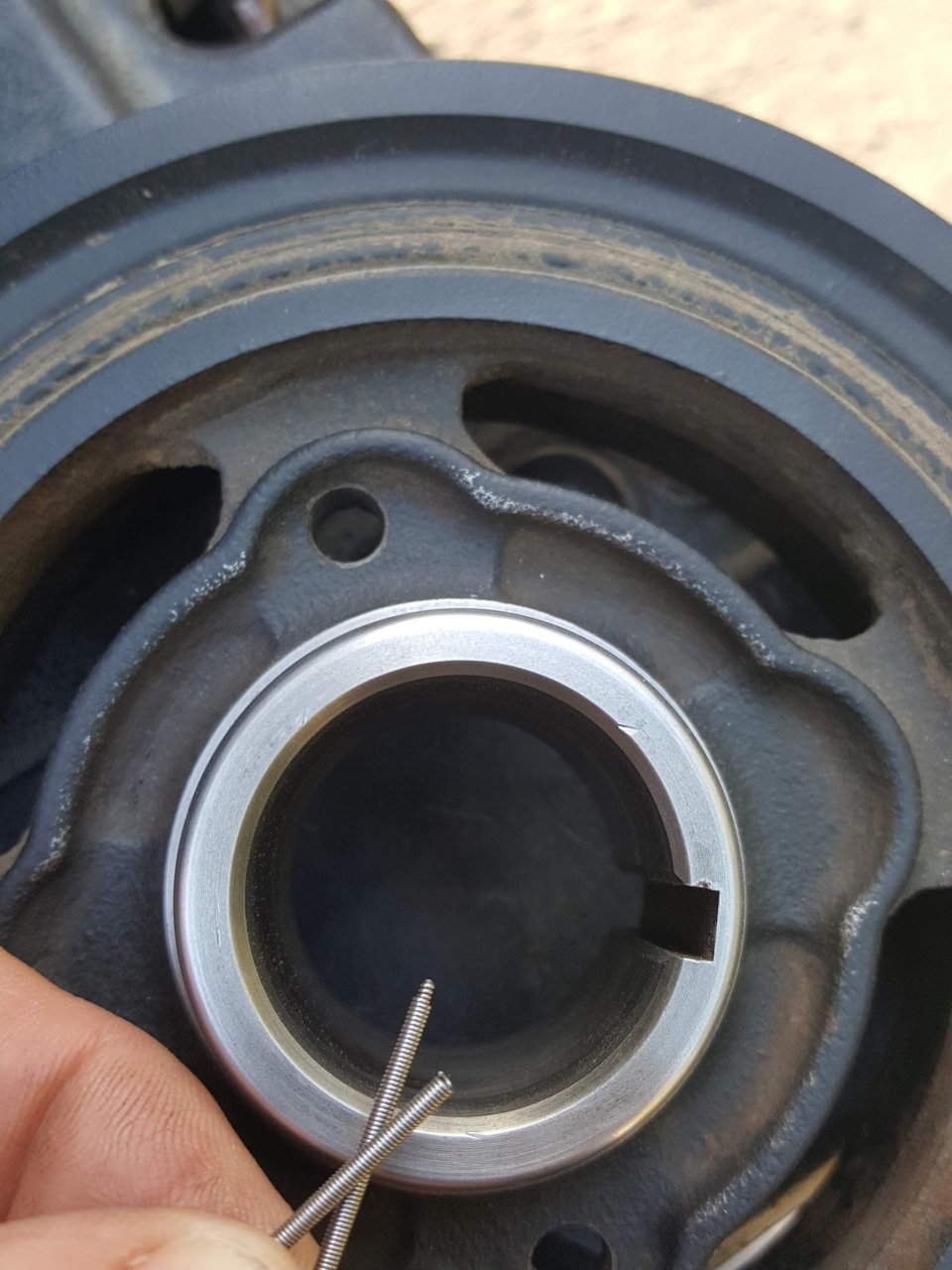

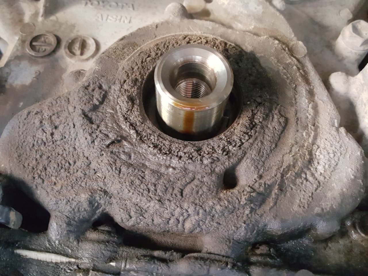

    To the next guy that removes this bolt or plans on replacing the front main seal. This may be something you may want to do if you hate oil leaks.
    I have the distinct pleasure to have two very good friends that have 'gotten across the finish line' more than once - one was responsible for a program that made Toyota Trucks famous and another that is a NHRA car builder and spent 20 years racing fire breathing dragons. Their collective advice was:
    If replacing the seal
    Shorten the spring on the main seal by 4-6 turns - once you take the spring off, you can 'unscrew' the spring and with some flush cuts and shorten the spring.​
    Very carefully clean the edge of the inner most edge of the lip of the seal with acetone and put a very small bead of Ultra Grey RTV on the circumference - just enough to ensure the spring does not fall off on installation.
    Clean every mating surfaces of the mating surface where the seal will go, the bolt, the stub end of the crank, the harmonic balancer (and SC pulley if equipped) and the washer.
    Thinly coat the the outside diameter of the seal (where it mates to the engine) - install the seal.
    Then thinly coat the stub end of the crank, the inside mating surface of the harmonic balancer (inside the keyway), the mating surface and ID of the SC pulley (you are sealing between the two pulleys so that it won't weep), the shoulder of the bolt and the inside surface where it will mate to the washer (keep the threads free of RTV), the engine side of the washer and assemble it all back together.
    This should keep from having a weeping leak over time. :)
