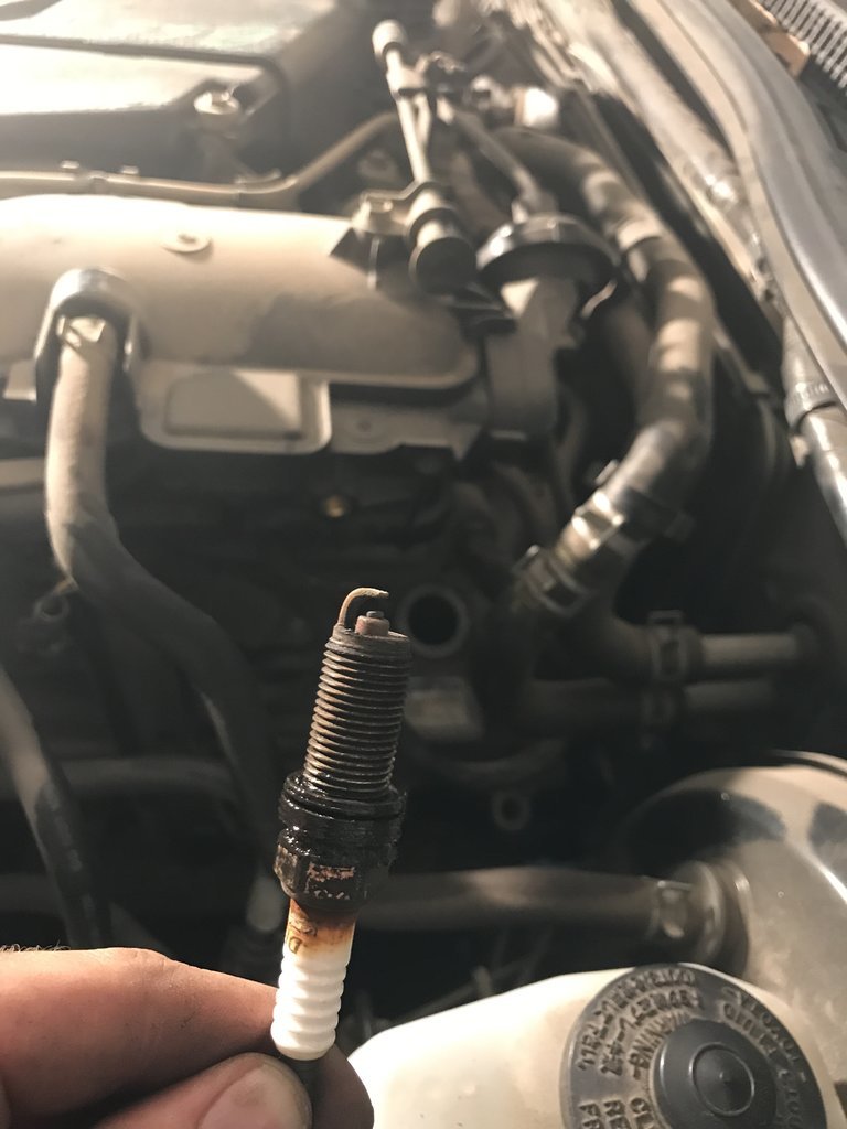

    @excorcist @Torspd UPDATE. Changed the plugs and they were all at .075 gap and the drivers one closest to fire wall looked like this....

    Odd that one was so worn, wonder if it was skipped on a plug change

    @excorcist they we're all gapped at .075
    the other plugs didn't have the oil....they were all almost seized but that one was actually loose
    excorcist likes this.

    Ahh gotcha, looking at it on my phone screen...

    Than again your electrode still looks worn to me when I zoom in.... obviously not the source of your noises...

    The oil is all on top of the plug, and not on the threads, so to me that means that the valve cover seal could be leaking.

    I know on the 4.7 there's an o-ring down in the spark plug tube that's bad about leaking, so I assume the 4.0 is the same way. Nevertheless, it requires pulling the valve (cam) cover.

    No o-rings in the spark plug tube, on the 1GR. Only place to leak, is from the gasket between spark plug tube and valve cover.

    If it is leaking into the tubes, it is a good idea, to replace it.
