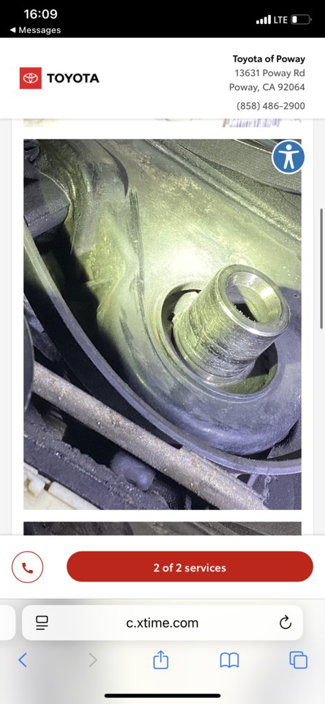

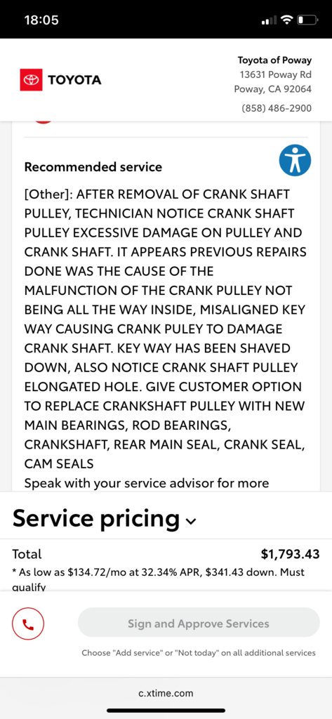

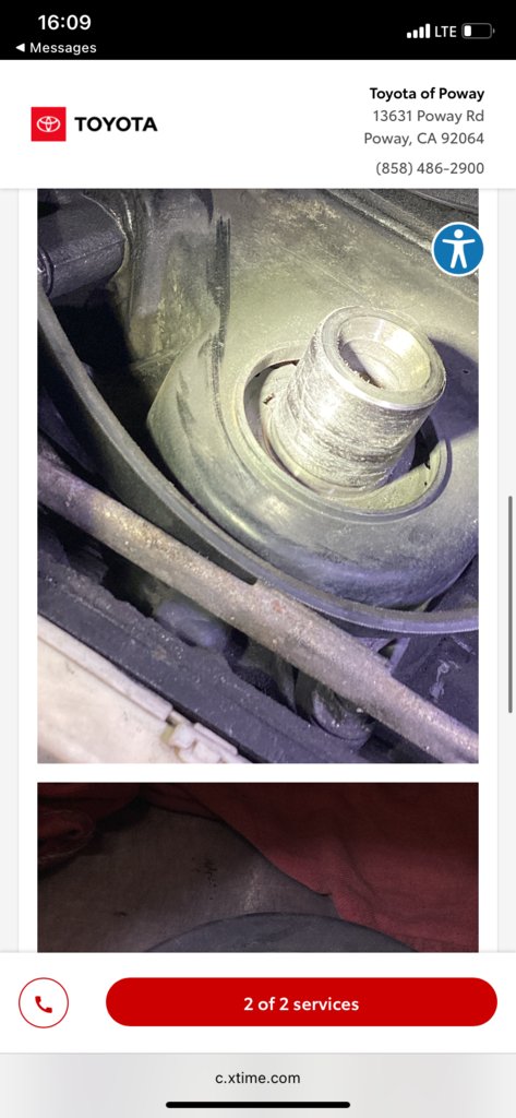

    I had a local shop change out my timing belt. A few hundred miles later I had a slapping noise. This time I took it to Toyota because they are closest to my house and they advised my crank shaft is damaged (see photos for full write up).
    Toyota wants to replace the whole dang crankshaft. Seems excessive to replace entire crankshaft but I won’t pretend like I know more than mechanics or any of you wiser folks.
    So here’s my question: The local shop advised they could repair the crankshaft with a sleeve. Does anyone have any experience or knowledge with a crankshaft sleeve being a legitimate long term and durable fix?(I’ll get a new pulley/harmonic balancer in there as well.)
    Truck is 2004 Tacoma 5vzfe
    thanks for any insights!
    ** also the photo shows a service price of 1,793 but they actually quoted me $9,000.

    This is whats happened to your crank
    Harmonic Balancer Snapped | Page 2 | Tacoma World
    there is no way to resleeve that....short of butcher welding the key in permanently
    the sleeve they're talking about is a seal saver most likely
    and dont think that's will do jack

    Is the keyseat damaged or was only the key filed down? Hard to see from the pics. If the seat isn’t wallowed out you could replace the key and balancer.
    The sleeve would just be a fix for the outer surface of the crankshaft from what I can tell from what the independent shop was saying they could do.

    But yeah you need to take more pics around that crank snout...
    and see what the key looks like.....maybe its just sheered off
    and not wallowed out
    As I've said....when you stab a new crank pulley.....you got to prep it and take the sharp edges off the keyway.....or pay the price
    whole system is so tight...its easy to mis-stab and catch the leading edge on the key.....,and once you give it the 200LB crank bolt....damage is catastrophic

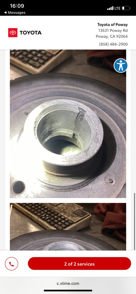

    From your HB it looks like try tried to use JB weld........and then quickly sold it
    or the whole key is sheered off in there

    here’s some better photos of the key way. Looks like the key and seat might be alright?

    I would not allow a sleeve to be put on my truck and call it a solution. The sleeve will be a bandage and technically, release the shop of any liability. You took the truck in for service and without a sleeve, why leave with one in place?
    I would, at a minimum, request the shop put in a new crankshaft/HB etc or a short block with proof of work. If the shop insists a sleeve is a solution, I would reach out to your local BAR (Bureau of Automotive Repair) representative.

    The Toyota suggested repair might be expensive.. but they're not the ones that fucked it up. Yes it's 9k but complete replacement is the correct repair..
    I wouldn't want a sleeve either. The indy shop needs to suck it up or be more careful if they're going to do timing belt jobs

    you can see where the key slot is majorly damaged in the HB.....
    so I think its been like this for awhile
    They should of flagged it and showed you
