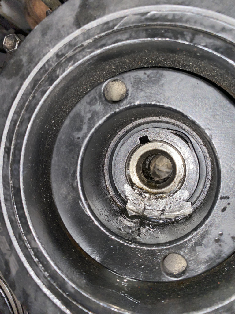

    Hopefully doesn’t come to that but looks like it probably will.

    Could be sleeve material, never seen one so no idea how thick they are.
    Is the current shop going to pull it off?
  3. Jun 5, 2025 at 4:06 PM

    Did they chince out by NOT buying a sleeve and use aluminum AC duct tape????
    freakin Incredible.

    California Bureau of Automotive Repair, they investigate hacks & shady practices, & try to keep shops honest....
    They may even tell them to refund or make it right, etc....
    Shops dont like pressure from the BAR.....
    It becomes publicly known if theyre spanked, its like failing a restaurant health inspection...
    I agree on the ac ducting tape.....
    If it is some sort of foil tape shim to take-up the wear on the crank & tighten everything up after they jb welded the keyway in...
    The owners being honest, "they didnt use a sleeve"
    They did even worse than that....
    ControlCar[QUOTED] likes this.

    Thats what I thought too. Looks like it was jammed in there and they sent it home with the bolt. Almost looks melted.

    Yeah current shop is going to take the pulley off and assess crank and woodruff key, take photos, etc.

    Have no idea what's going on with the threads in the crank snout for the center bolt.
    I dont like what I see....
    But getting a detailed pic of the threads isnt what they were after....
    The threads look minimal....
    Not sure if theres liquid pouring out of there...
    Almost looks like the hvac ducting in there to, of just a distorted pic & that just a clean crank & no threads...
    I only see like 2 maybe 3 row of threads in the crank center hole, that cant be right...
    as stated maybe just an illusion, not the best pic.
    or overtightened & tore-up the threads...

    That does not look like a 300mi HB
    must of been a rough 300 miles
    wondering if the HB was failing originally

    Heres a question...
    If the shop owner after youre heated discussion is claiming they didnt use a sleeve.....
    Did you call him out & asking what the Wrigley's Spearmint gum wrapper hanging out is?
    His response???
    ControlCar likes this.

    His response was comical. Literally he said “I don’t know what that is, but the crank isn’t your issue, bring the truck down here and we’ll check it out.”
    To which I laughed and replied “You guys aren’t touching my truck again.”

    What's the latest, what did shop #3 think after they removed the dampner, get a plan together?

    I dont know how they got a sleeve on the snout of the crank when there is a woodruff key there, did they install the sleeve and trim it and hope that red locktite would hold it? All of the sleeves I have installed require the flared portion of the sleeve to securly sit on the flared portion of the shaft wheather it is on the flywheel end, a pinion shaft or an axle shaft.

    Shop #3 advised the same as Toyota that the crank is damaged and either needs new crank or replace engine. (waiting on photos for picture of crank without crank pulley) Shop #3 doesn't recommend replacing crank due to old age and miles on the engine and thinks its better off with engine swap. (which I tend to agree. I'd rather just put a fresh engine in it at this point).
    They said the gum wrapper looking stuff was some sort of thin aluminum and seems like it was an attempt to keep the crank pulley on tight. They further stated that the crank pulley wasn't seated all the way back against the crank gear, much like it probably wasn't in the first place when the original damage was done.
    They offered to hang on to the truck disassembled for a little while so the BAR can have a look.
    I'm going to reach out to shop #1 and ask them for about $10,000. KBB gives my truck for it's condition about $7500 value private party, plus the $1000 for timing belt job and $1000 to pay for shop #3.

    All makes sense...
    At dealer level, if it has over 100k on it, were not going in to just replace a crank....
    Well, atleast we cover our ass & advice against it so if things go south, we advised against it & you ultimately chose the cheaper repair vs eng replacement...
    Another option that might make more financial sense depending on what they source for a rebuilt engine replacement.
    Call Action Cylinder Head is santee & ask what cost would be to rebuild your engine including a replacement crank....
    ACH is a local machine shop / engine rebuilder.
    At this point I think I would trust them more these days compared to Ricks Machine Shop...
    Turn around time may be longer than a straight long block swap but may make a drastic financial difference where it's appealing to go that route after you get the funds figured out.
