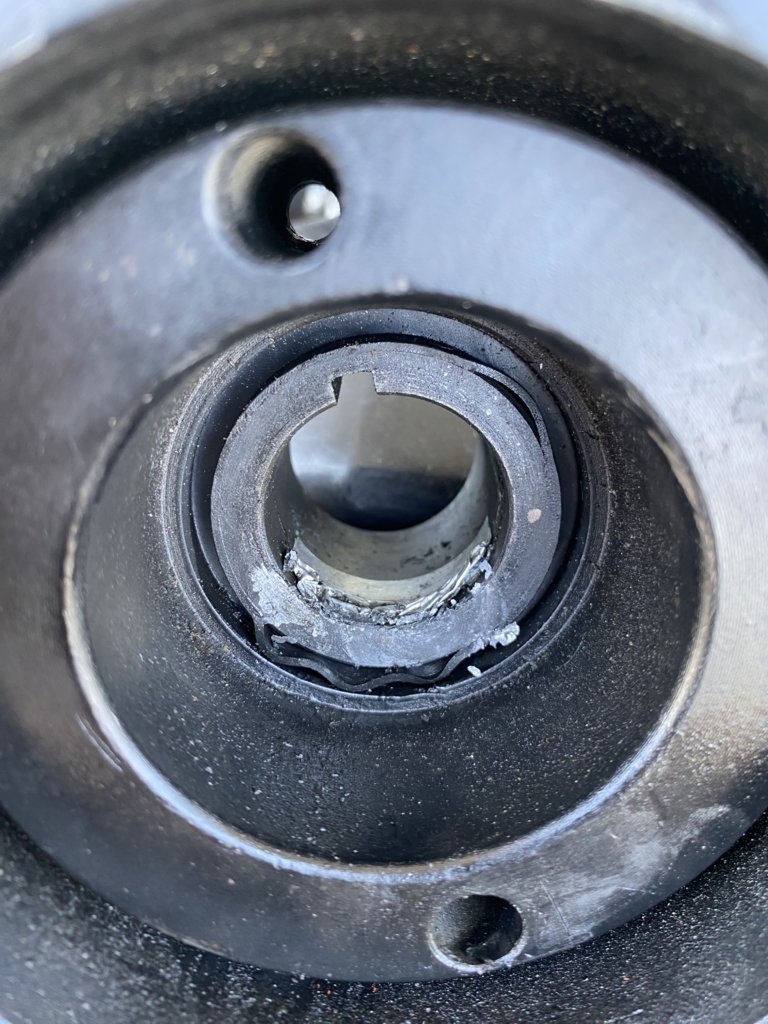

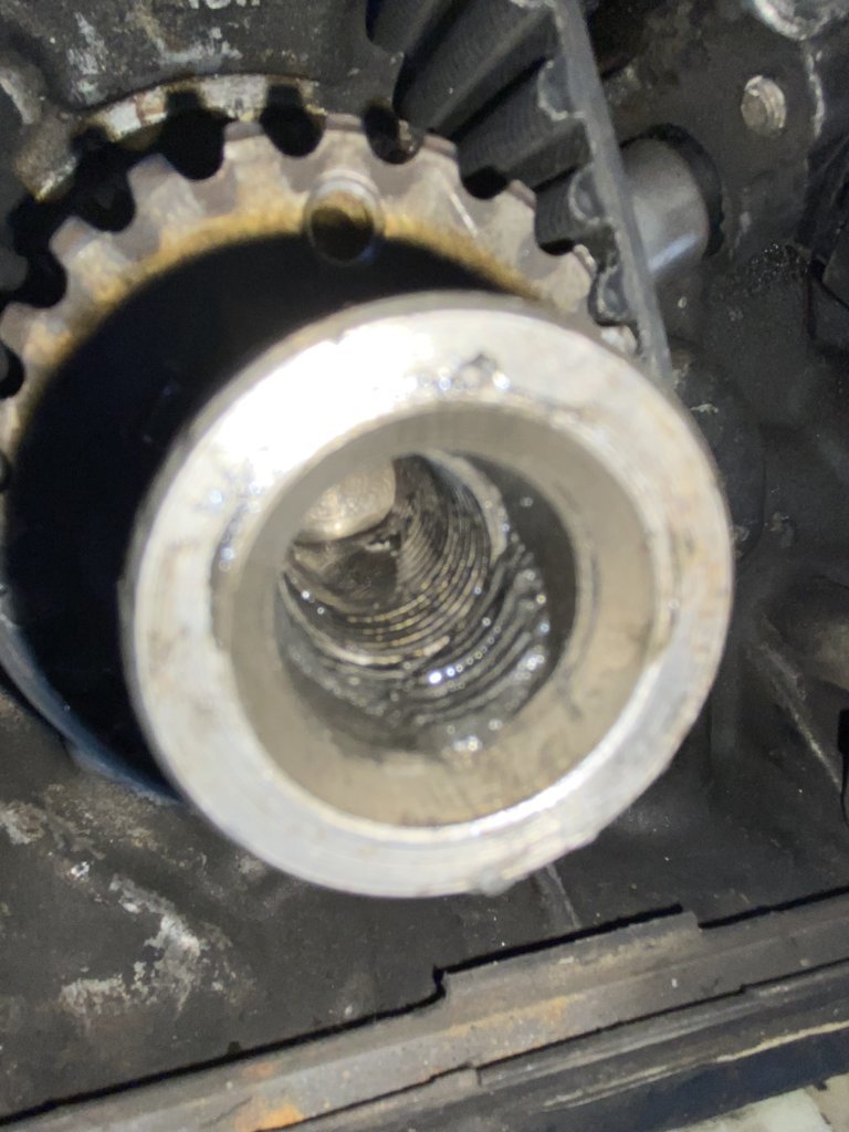

    Also, got some more photos back. I’m pretty sure they re used the original crank bolt and ruined the threads, then tried to use a grease lubrication to get bolt in. I couldn’t get crank bolt to screw in straight.
    Also, not an OEM crank pulley

    Probably not a new crank pulley either,
    Wouldn't surprise me, just rattle canned it black...
    I said it from the get go, threads in the crank do not give me a warm fuzzy feeling....

    I seriously get more and more pissed when you post pix of this hack job by shop
    Again sorry.
    that pulley fix attempt looks like what a 12yr old would attempt on their loose BMX bike L crank that was loose/stripped.
    I mean, kudos to a kid ‘trying’ but a shop charging an owner and trying that crap???

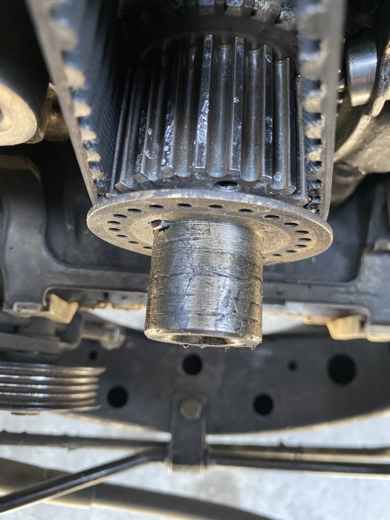

    Dont think that would be worse if done professionally by a machine shop......
    Add metal & machine it to spec...
    Requiring removing crank completely...
