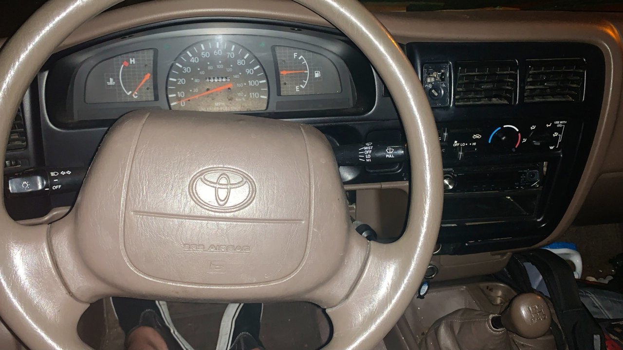

    Hello Guys & Gals,
    Today For Eight hours straight I was trying to solve the issue and I Solved it.(with my Dad)
    1.Check FUSES
    2.Check each and every connector
    3.Replace Battery Terminals (if Needed)
    4.Remove the Starter (have your local auto parts test it)
    5.Clutch pedal (just tighten it up)
    All this led me to the solution witch in my case was a loose clutch pedal.
    (Keep checking the fuses after changing parts)
