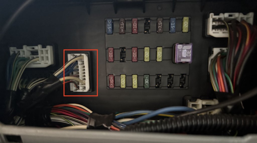

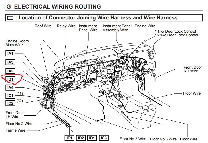

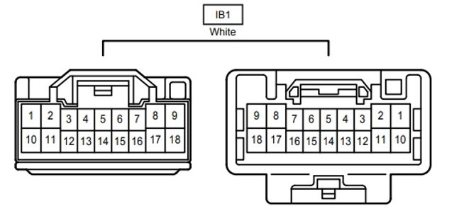

    You didn't mention what year your truck is or what engine you have but the easiest thing to check would be Connector IB1 Pin 8 (Black/Red) behind the drivers kick panel and see if the pin is burnt as that's a common issue.

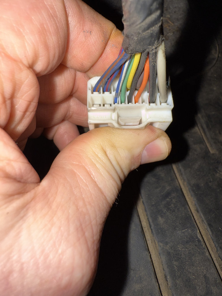

    Is this the IB1 connector?
  16. May 17, 2025 at 7:53 PM
    #16
    Dm93
    Dm93 Test Don't Guess
    Mar 3, 2015
    #150066
    13,118
    Texas
    2014 DC OR 6spd 4x4
    Predator tube steps, Ranch Hand grill guard, Magnaflow CatBack exhaust, Toyota tool box & bed mat, 2LO Module by @Up2NoGood, Rearview Compass/Temp Mirror, Tune by @JustDSM.
    No that's Connector 1F
    IB1 is behind the left kick panel.

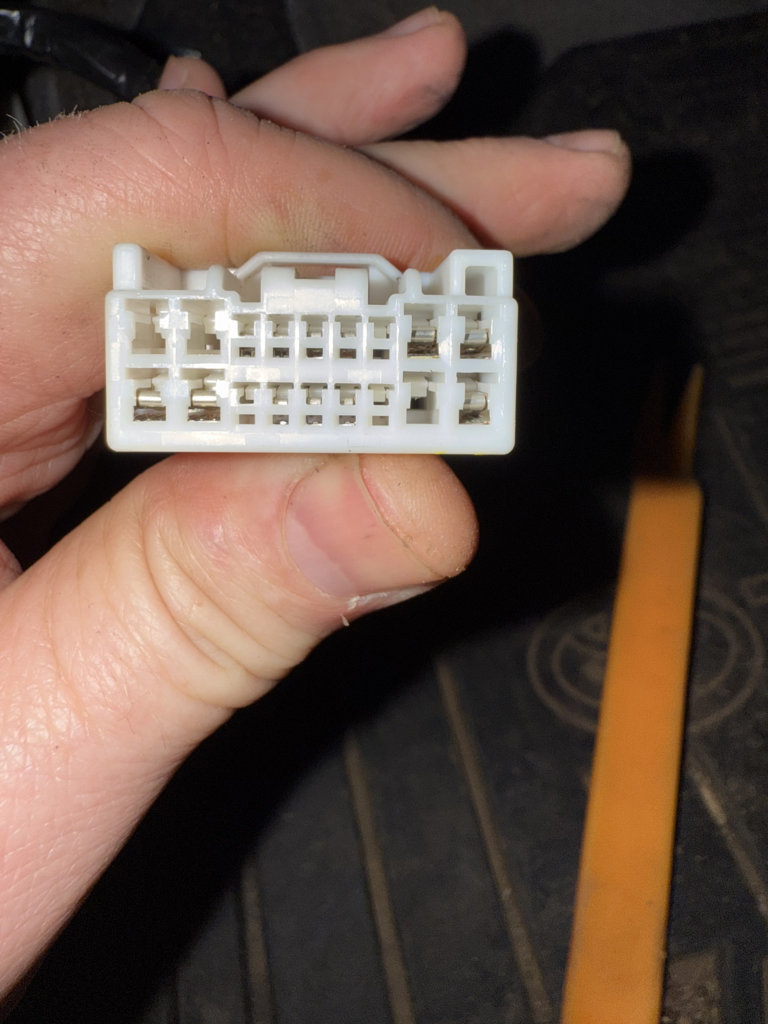

    Looks pretty clean from here:
    I had an image of the socket that looks good enough locally, but every time I upload it there's zero contrast, you'll have to take my word for it but the pins look mint.

    Plug it back in, backprobe Pin 8 with a needle or other suitable tool, and see if you have power there during cranking when the truck isn't starting.
