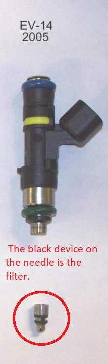

    He cannot replace the filter inside around the needle if it is plugged you will have to buy a new injector.
    Granted I am not familiar with the internals of the Tacoma Specific Injectors. However most modern injectors have an internal filter around the needle and it cannot be removed as the injector is welded together after it is installed.
    Just for a qualification. I work on automated assembly lines that assembles and tests gasoline fuel injectors (EV14).
    Note: component # 6

    This is an EV14 injector. The needle is inside the welded together injector. That black device on the needle is a filter separate from the inlet filter. If it is plugged you will need to buy a new injector.
    I don't know if the Tacoma injectors have an internal filter. If it does, you cannot clean it or repair it.
    If it only has an inlet filter it can be replaced, but there is a risk of contamination which could cause the injector to stick open or closed... It doesn't take much to cause a stuck injector, like a micron or two.

    While it may have a filter in the inlet ( most do ) if anything gets inside the injector you cannot remove the inner filter if it exists.
    As I as trying to say earlier, while you can pull the inlet filter and replace it there is a huge chance of getting contamination inside the injector leading to a stuck needle.
