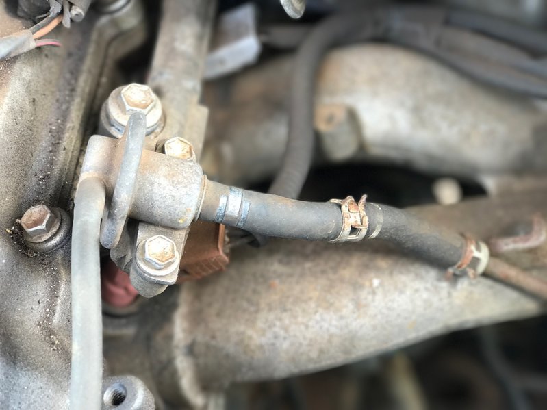

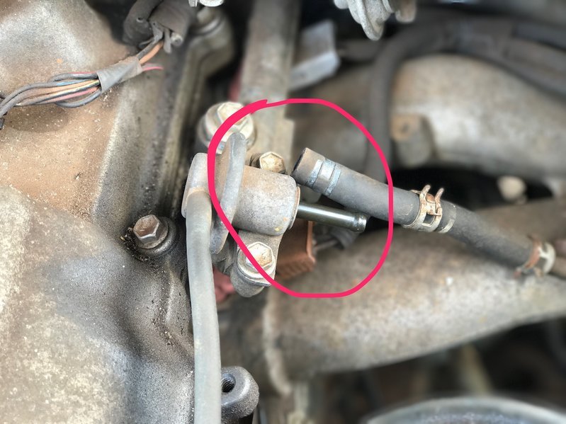

    I have a '01 Taco 2.7L. It cranks over but will not start. It's not the starter and battery is fine. I am thinking it may be the fuel pump. Looking at the pictures below is this a good place to see if fuel is going to the engine? As I start it I don't see any fuel coming out of that hose. Please advise, thanks.

    That's doesn't look like a fuel line (or I may be wrong). By the way, what is that bunch of broken wires on the picture?:notsure:

    Yes, that looks like the fuel pressure regulator. With the fuel pump running the excess fuel should come out of there. Try pulling the starter relay, turning the key to start and listening for the fuel pump running. Sorry, I don't know where the starter relay is off the top of my head.

    My bad, I did not think about return line:hattip:

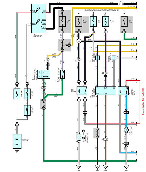

    The fuel pump is powered by "Circuit Opening Relay" located under the dash (left side near the Body ECU) and EFI Relay, fused by EFI Fuse (15A or 20A depends on model). EFI relay control is fused by Ignition fuse.
    Fuel pump ("Circuit Opening Relay")is turned on by Engine ECU (FC connector).
