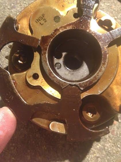

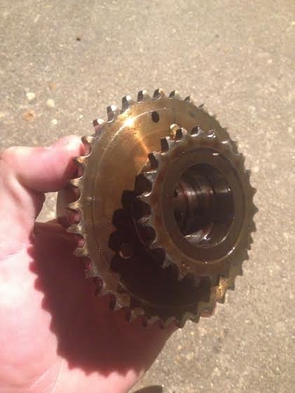

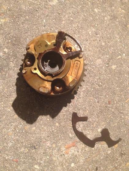

    Just to update everyone....I ended up taking it to a local shop (not a dealer). He pulled the valve covers and determined that the variable valve timing gear had a "cleat" on it that broke off, throwing the timing off. After a new gear and $542.32 later, my truck is running as it should.

    i had the same issue for the most part. never could figure out what it was. mostly was havin a low oil pressure. anyways i replaced my engine and while doing that dropped the oil pan and it looked like i was mining for gold in that thing. flakes all over. atleast u caught yours fast enough to figure out what was wrong before an engine replacement. oh and u can see the oil pain in my build thread on one of the last few pages

    My truck just did this. wondering if I should replace the timing chain while I've got everything apart (had to take off the front cover to find the broken off piece)? did they replace the timing chain? have you had any more issues? I did notice the new gear now has an extra spoke on part that broke off, leading me to believe this happens enough that Toyota redesigned the part.
