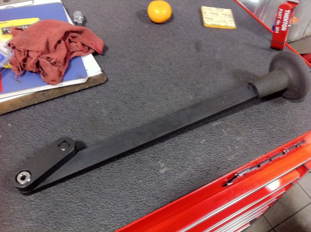

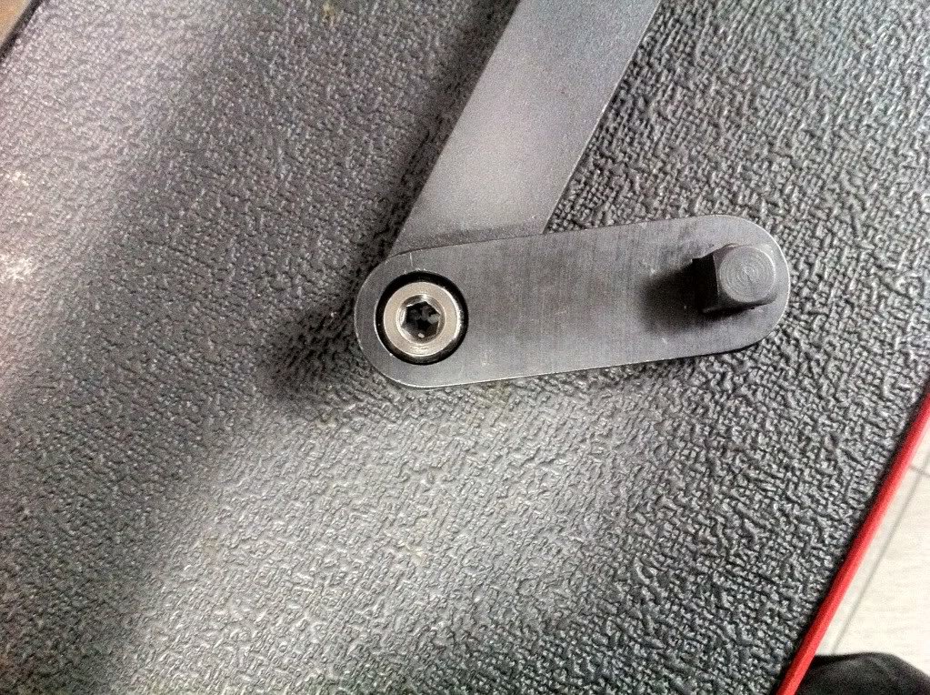

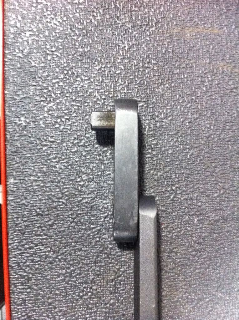

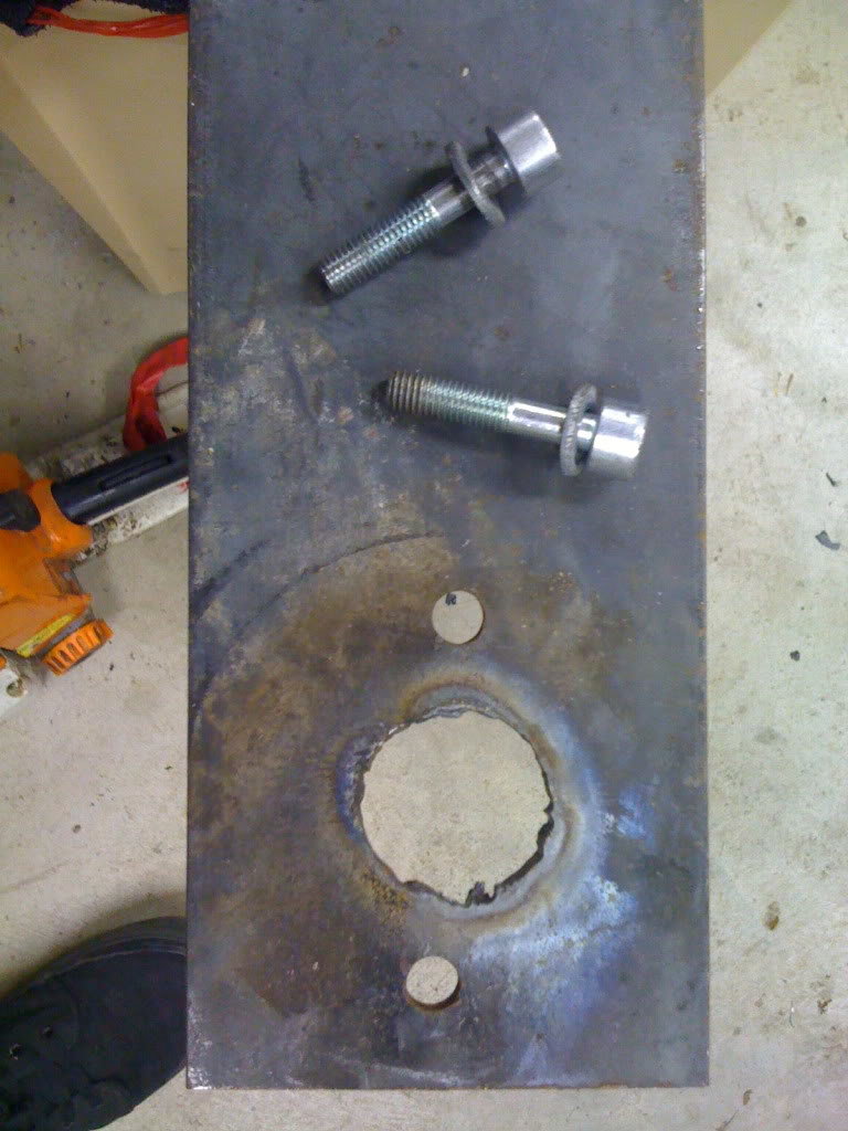

    if anybodys wondering this is the tool I made

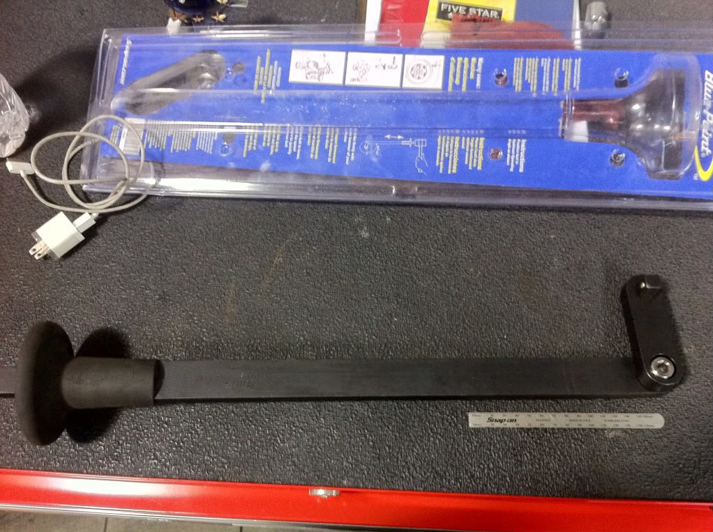

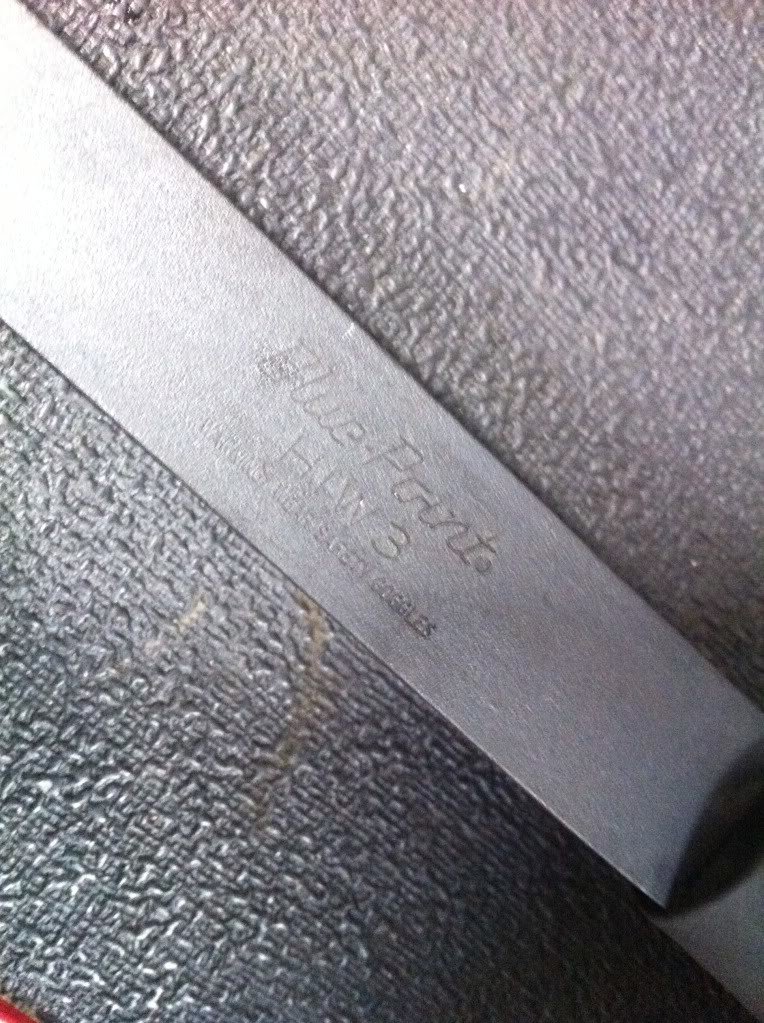

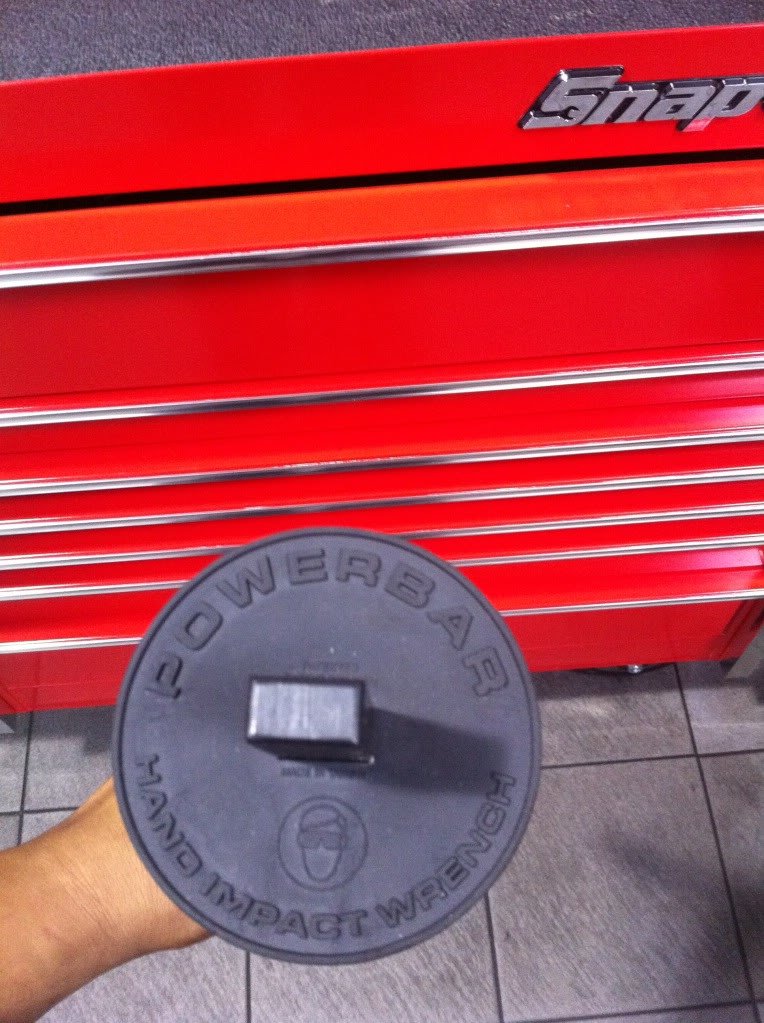

    There is a harmonic balancer bolt remover that you strike with a hammer whlie standing up in front of truck. Long rod swivel end that bottoms out on striking shaft and a half inch drive for a socket to put on balancer. Also make them for air hammers.

    DocBrown86
    DocBrown86 Yota Doc
    May 16, 2010
    #37266
    98
    Brian
    San Diego (Spring Valley)
    04 Prerunner
    toytec coil spacers, tokicko struts/dubcab springs, energy suspension rack bushings, bilstien hd shocks, K&N FIPK2, Flowmaster 50DF, ScanGuage2, 5000k HID's, horn mod, other stuff that I forgot to list

    I'd really like to see some bigger pics of this tool when you get it and I'm curious about how well it will work! Sounds like it might have a lot of applications other than the crank pulley bolt.
