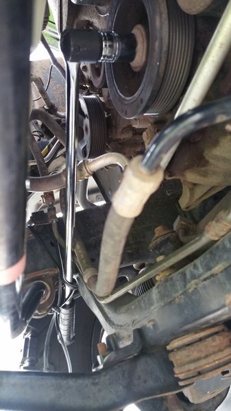

    Make sure you know what way the engine spins.
    Disable the fuel injectors (pull relay)
    Long breaker bar (pipe / what ever) against the frame.
    BUMP the starter (don’t keep cranking it )
    Then do something like this.
    AGAIN, make sure you are on the correct side of the frame.
    In the picture below, the engine turns CLOCKWISE while cranking.
    With the breaker bar positioned as pictured, the bolt will “loosen” COUNTERCLOCKWISE.
    Getting it back on, isn’t as easy. I’d go with an electric impact LocTite and UGGA-DUGGA.

    I was able to do this by putting the truck in reverse. That provided the counter force. Then I put a long 3/4" black pipe over the breaker bar as an extension and was able to take it off all by myself.
