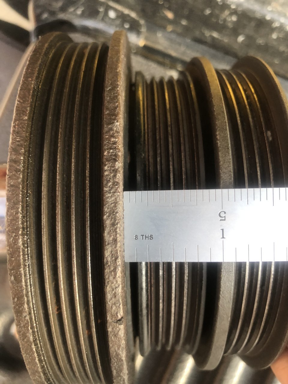

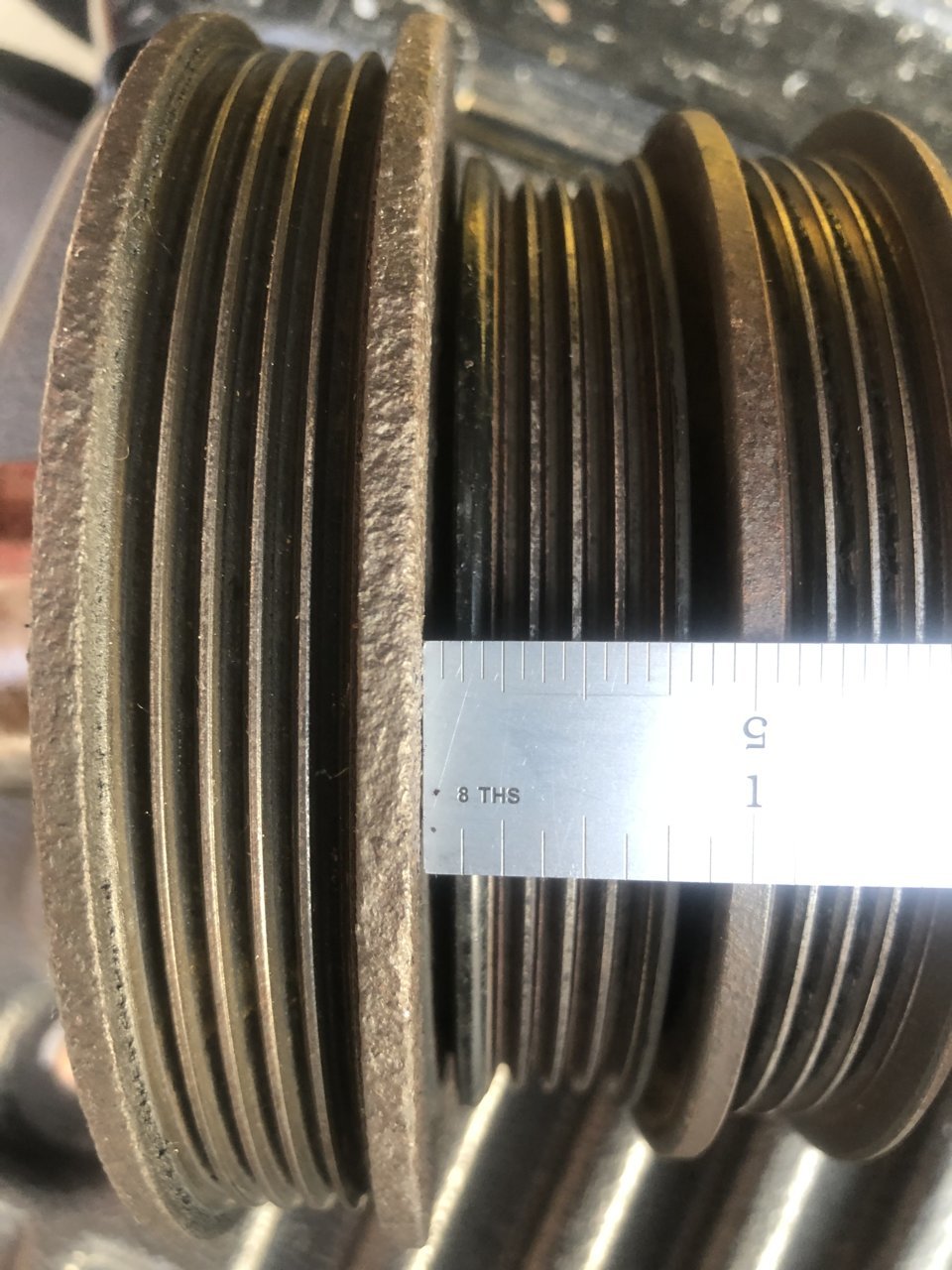

    Okay! Sooo yep, confirmed. The Harmonic balancer is slowlyyyy failing at the the rubber bushing. At least a 1/16” off (I’m sure some of you would prefer I use metric system)
