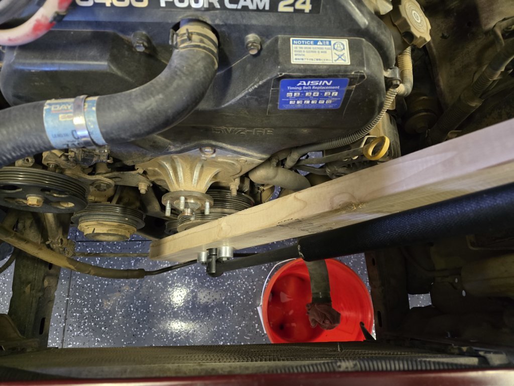

    So I'm in the process of helping the neighbor's grandson repair his 5vz (timing belt snapped while driving on Monday). We just got to disassembly this evening and I got the crank pulley out using a 2x4 with 3 holes drilled into it. We'll use the same for reinstalling and properly torque-ing the pulley as well (works like a charm).

    G-Men sticker, driver's side "backseat" window - cracked driver's side headlight cover complete with hazy look - DIY 30 footer paint lift in Bedliner Black
    What’s the hardware you used? Looks like something under the hex heads for stability? Also, I do not have any special drills. Could I just use an impact & a hole cutting bit?

    I used some extra aluminum skid plate spacers, only because the bolts I had were too long (proper length bolts would eliminate the need for the spacers).
    For the bigger hole (where the socket goes through) I used a 1-1/4" hole saw bit on the end of a standard drill. For the bolt holes just a standard 1/4" wood bit did the trick

    I believe they are m10x1.25. Do you happen to recall what length bolts you got or would have?
