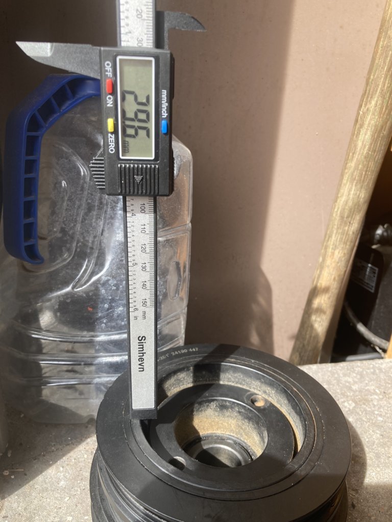

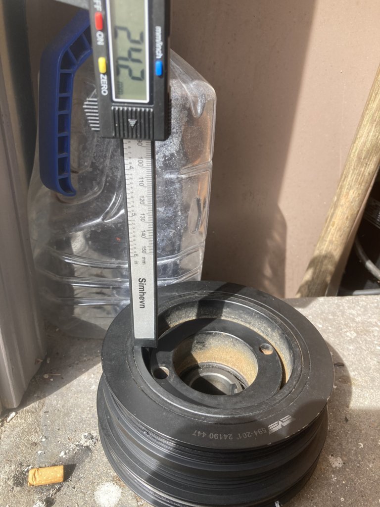

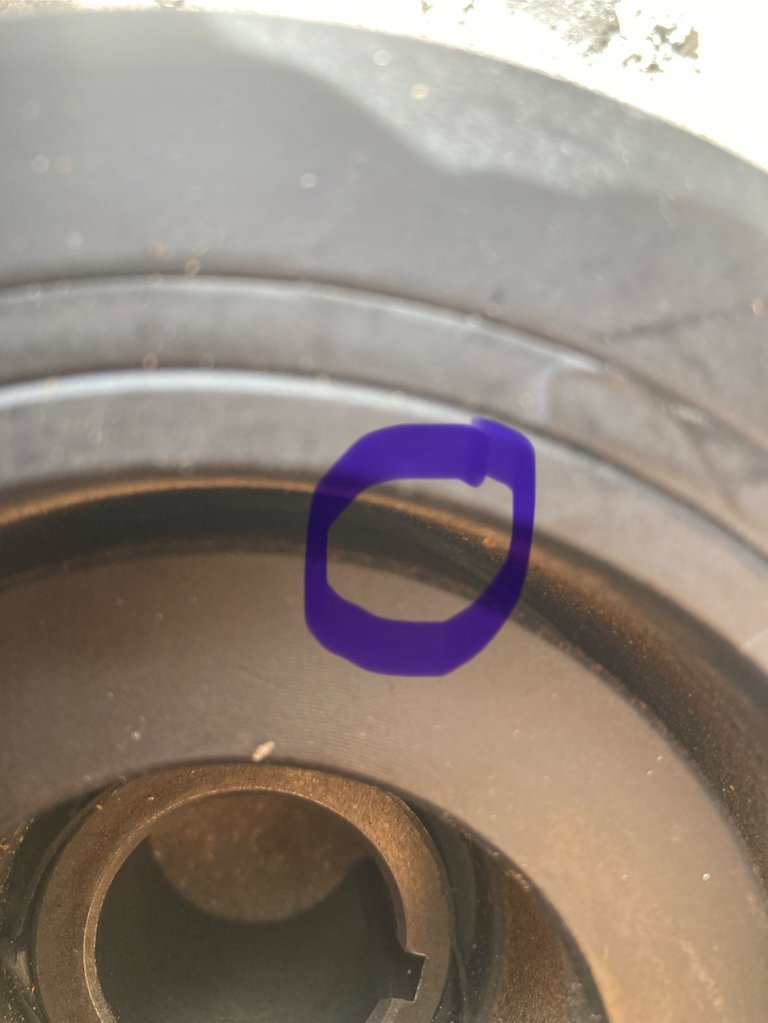

    So I’m going over this with a fine tooth comb. I don’t find any wobbling when on a flat surface. What I did find was this. (Keep in mind I don’t have all the handy measuring tools, so I have to wing it.) When measuring between the cs pulley & the balancer at different points, the depth itself is fine. & I can’t really find any or much dif from
    However, whilst measuring the depth with my handy caliper, I had to turn it flat side against the inner edge. I started noticing, just by unintentional twists when I was done, it was hitting sooner or just felt different depending on the spot. This is a pick of the end of the caliper
    So I started checking in between by using the wider side & found this, which tells me somewhere below, the balancer is tilted in respect to the pulley or something like that. I turned the pulley to get the 2nd shot.
    Also, worth mentioning that the total depth is 48.4mm.
    Hope I explained this well….
    So, am I onto something?

    I think so. This is what I was referring to when I said that the two parts aren't in line. I had a different pulley in mind however. It has been about 6 years since I worked on one of these engines. Regardless, that would cause a wobble because the two halves are spinning in different planes. How does the spare one you bought look?

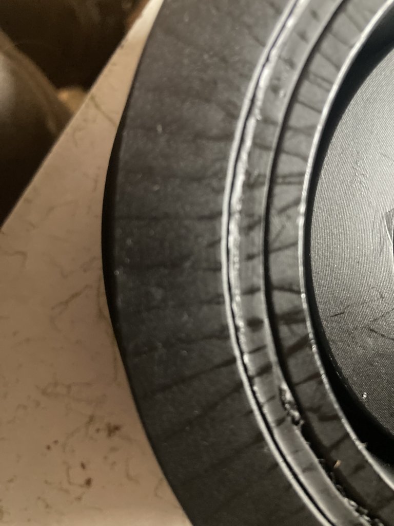

    it arrived. It seems better. Has these markings on it though, that the other did not. Doesn’t necessarily looked used, tested? They go all the way around it.
