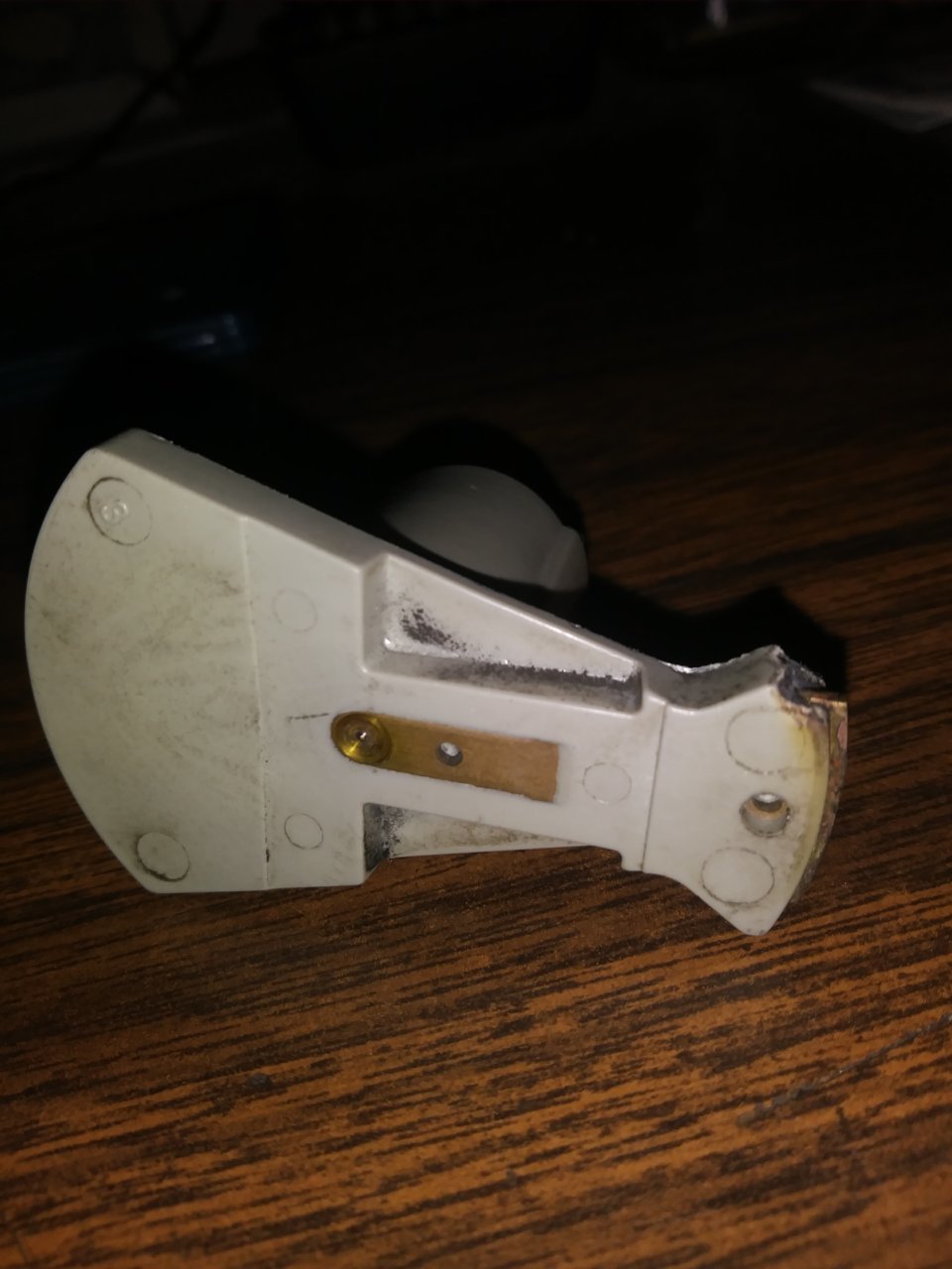

    Oh yeah I noticed the guy didn't put the Fender bolts back in the front when he took the front grill off Goodyear said it was because my rotor button burnt up due to arcing and they also said that that would show a crankshaft sensor malfunctioning on a OBD2 tester so I'm wondering if that's true and why would my rotor button be arcing

    I suppose it's plausible although that rotor doesn't look terrible. There's always going to be arcing on the end of the rotor that goes around the outside, that's how it distributes spark but the there shouldn't be any at the center unless the button in the distributor cap is burnt.
    What year is your truck and what code number were you getting?

    1996 toyota tacoma dxl. Code was PO335 and it read out crankshaft sensor malfunction both times on each, the one that was originally in the engine and the replacement I installed they also said that the arcing caused the corner of the rotor button to disintegrate
