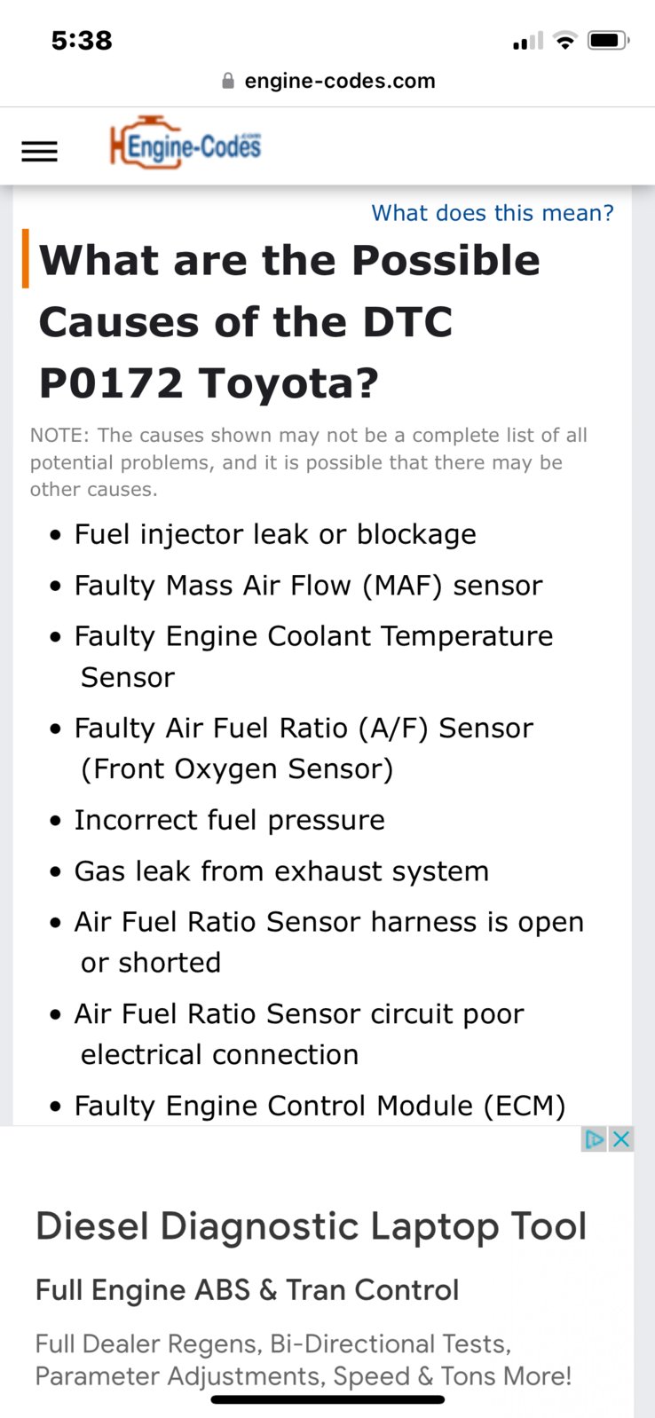

    CE came on P0172 during drive

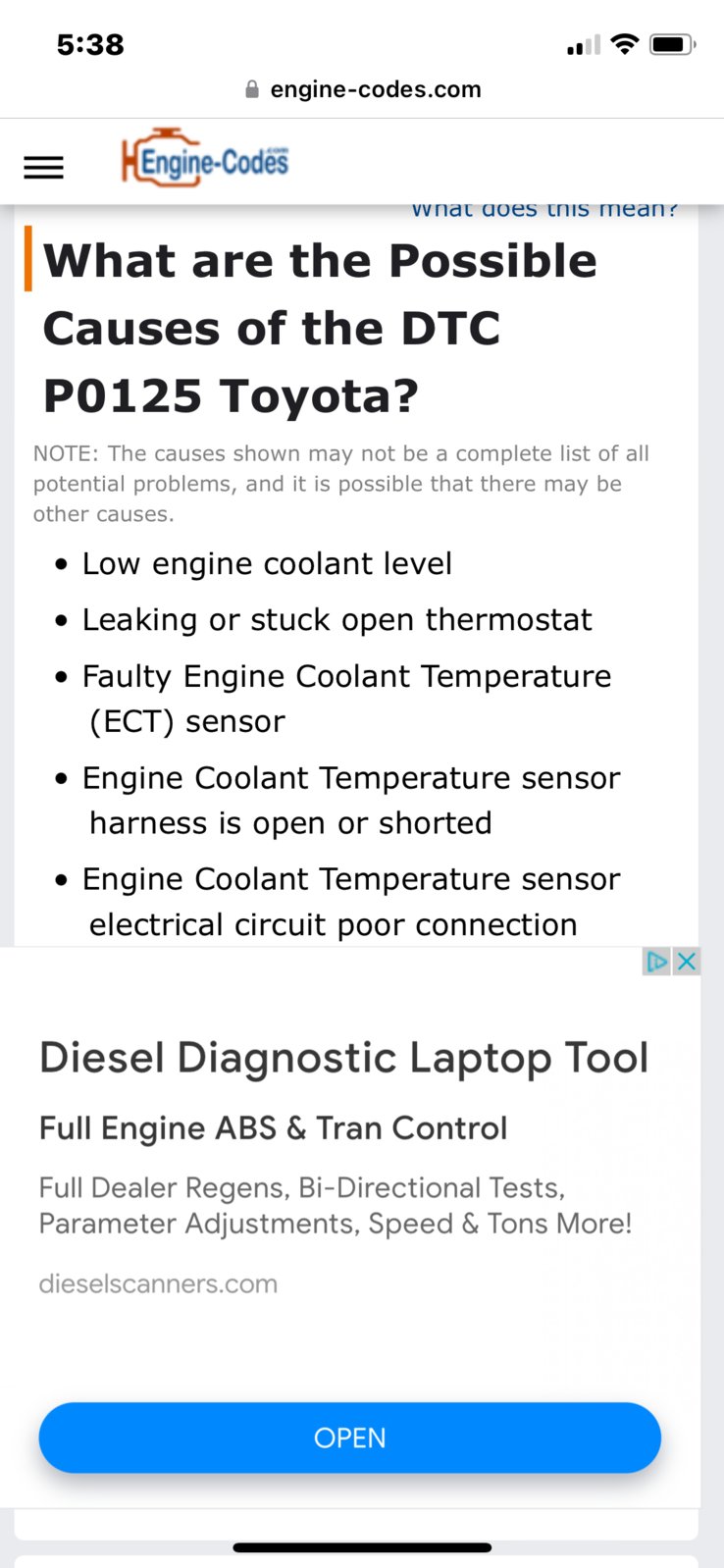

    then P0125

    Is this as easy as RR’ng the coolant temperature sensor on back of head?

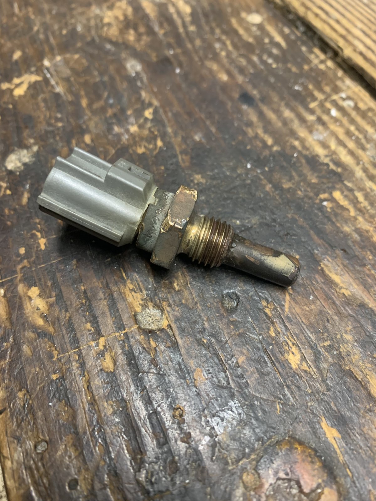

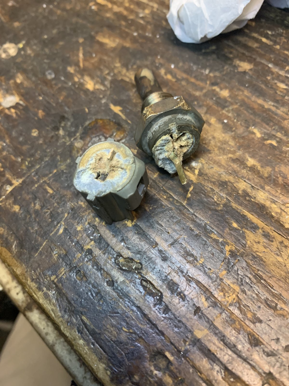

    Well Well Well
    Look at condition of coolant Temp sensor
    New installed
    Will report findings

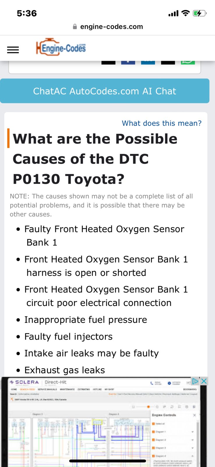

    Update
    After P0125 taken care of
    still weird ‘dead throttle zone’ at 1000-1500 rpm’s and
    After multiple test drives
    P0172 kept coming up
    well today, P0172 & P0130

    Now I got 2codes and front O2 sensor is listed as ‘causes’ in both codes
    RR’d front O2 sensor tonight
    Weird dead zone gone
    Did my normal test drive trip/route
    (Which throws a code every time)
    NOTHING!
    think I’m out of woods
