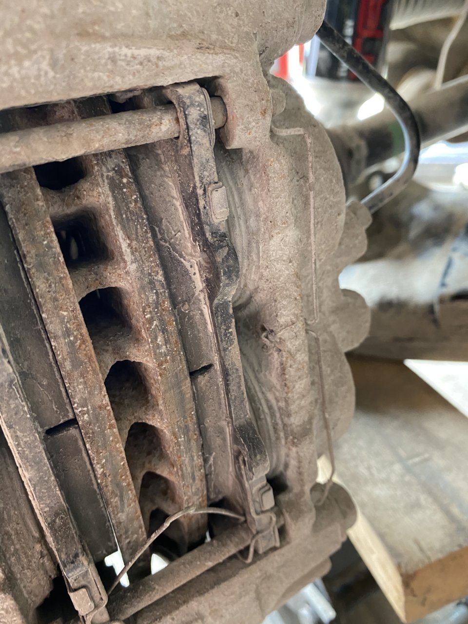

    Shellshock
    Nov 21, 2015
    #170338
    23,204
    Iowa
    this is from a couple weeks ago
    I’ve also got about 15k miles of towing
  10. Oct 26, 2020 at 9:00 PM
    BortisYeltzen
    BortisYeltzen Well-Known Member
    Dec 17, 2016
    #205105
    1,256
    Barrett
    Salt Lake City, UT
    2017 MGM TRD Off-road DCLB
    OTT Tuned, Bilstein TRD Pro lift, ECGS bushing, Heated Clazzio's, RCI SKID TRILOGY, BAMF sliders, ARE V-Series shell, RokBlokz flaps, more to come
    Mine look very similar. It’s like they’ve stopped wearing. Every time I check at 5k tire rotations they are about the same. I may change pads since I’ve got a new set and they’ve been sitting on a shelf in my garage for a year.
