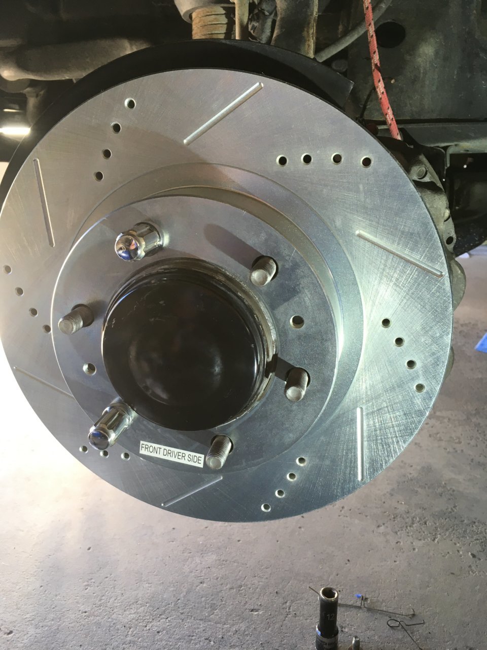

    I second this! Night and day difference 7223D1C4-AD87-48BE-BBCA-F3FC5C515F9C.jpg

    stoptech pads are godly. imo. Allegedly.
    They really are though. Trust me.
