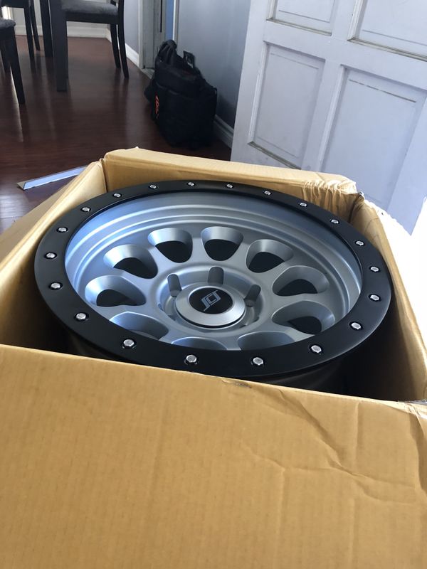

    Your eyes don't deceive you, the wheel is two tone. Here's one in silver that shows the color separation.

    Don’t let the “not DOT approved” status trick you into thinking beadlocks are less safe or just for slow crawlers. Both times I have been involved in roll overs was because the tire peeled off the wheel going sideways and then the metal wheel dug and catapulted the vehicles causing them to barrel roll. I wouldn’t be surprised if some highway roll overs were made worse by the tire coming off the bead.
    Real bead-locks are heavy and need much more care for the bolt rings maintenance but they can also save you tire shop money for mounting new tires. Still need to balance but that’s like 30 bucks vs 100+ bucks for mounting plus driving and scheduling appointments at the tire shop.
    Just saying all that headache for beadlocks isn’t just for jeep mall crawler points. Safer and less dependent on tire shops.
    And obviously you can run stupidly low psi which is a night and day difference off road in sand and mud and rocks and comfort and ....

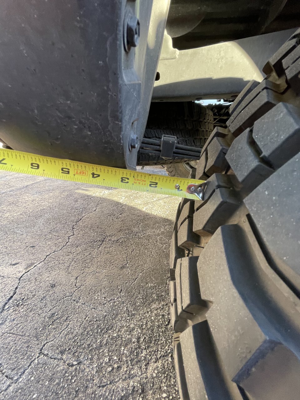

    Here’s my concern , not sure if it was like that before .

  14. Dec 2, 2020 at 5:08 AM
    #34
    NukedTaco
    NukedTaco Well-Known Member
    Jan 17, 2018
    #241559
    981
    Wyatt
    Saratoga Springs, NY
    Doesn't look good, the leaf spring hangers are pretty easy to bend. I would definitely let your insurance know so you can have a professional take a look at it.

    The fist and only thing you should do is take it to an alignment shop and have it checked. That is the only way to identify if anything is bent. As long as you don't need any body work, they can work with your insurance company. If you have body damage, take it to a body shop. They will handle will check the alignment as part of the body repair.
