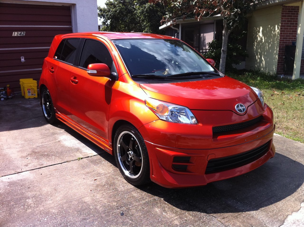

    It's nowhere near the same level of investment but in much the same vein I do feel your pain; I had a 2008 Scion xD RS 1.0, #847 of 2000 units, of which only 500 were manual like mine. I bought it not quite new, had approx 1300 miles on it but I loved that little hatch, put all the TRD goodies I could on it, washed and wax weekly, reasonable wheels and subtle touches to my taste and it was just so simple and CLEAN, unfortunate life circumstances lead to me selling it, I tracked it down a few years later but the owner after me neglected the hell out of it, had been in an accident, paint peeling, and they still wouldn't sell it. Hurt like hell not going to lie. I bought another several years later but it just wasn't the same, I was constantly chasing the dream and was never happy with it, ended up selling it too when I got the Tacoma.
    I still miss the original not going to lie but it can never be again and god lord is that hard to swallow for me.
    All that's left of her are grand memories of simpler time, a few pictures, and what I stole off her before I had to say goodbye:

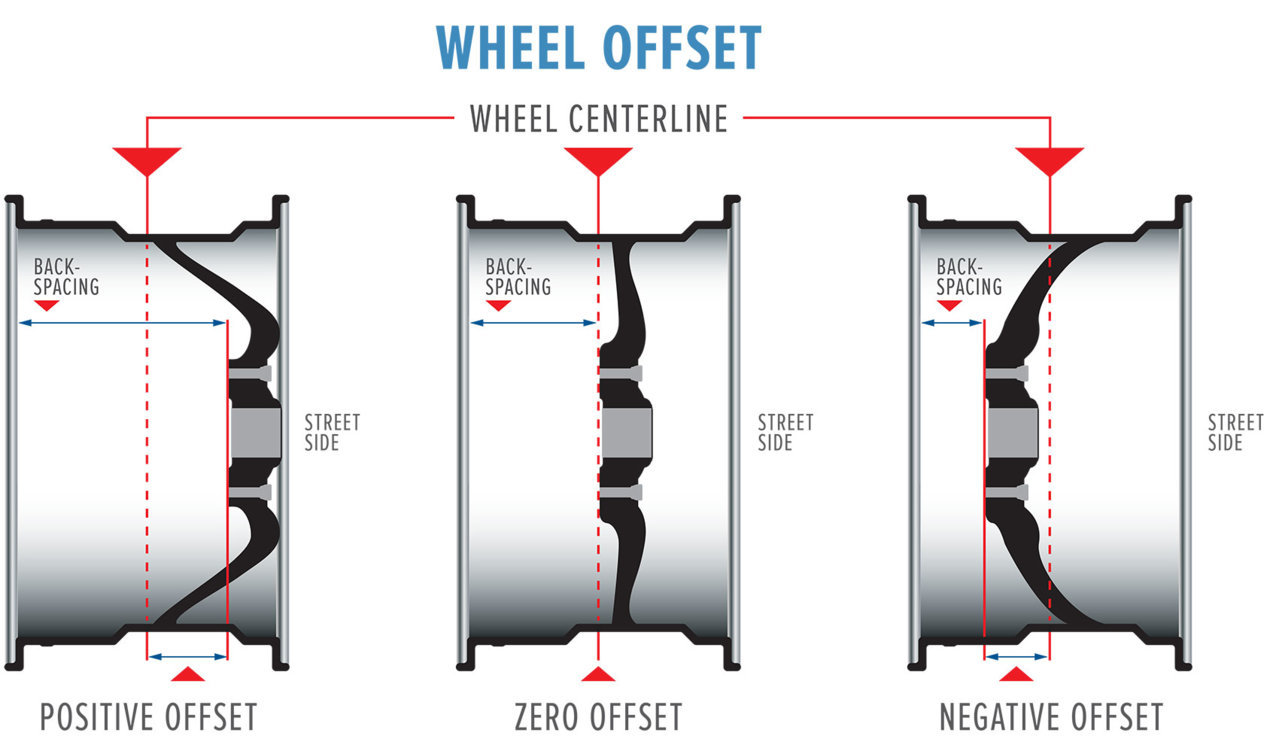

    The stock 4runner and stock 1st Gen Tacoma wheels have +15 offset.
    More offset pulls the wheel in, less pushes it out. I added 1” spacers (25.4mm) to mine pushing them out further than stock, so the offset is now 15mm -25.4mm = -10.4mm offset.
    I started with 1.25” wheel spacers on stock wheels, which sounds more like what you want. It gives a little poke to be noticeably not stock without being so much it looks out of place. See pics in the original post with the black wheels.

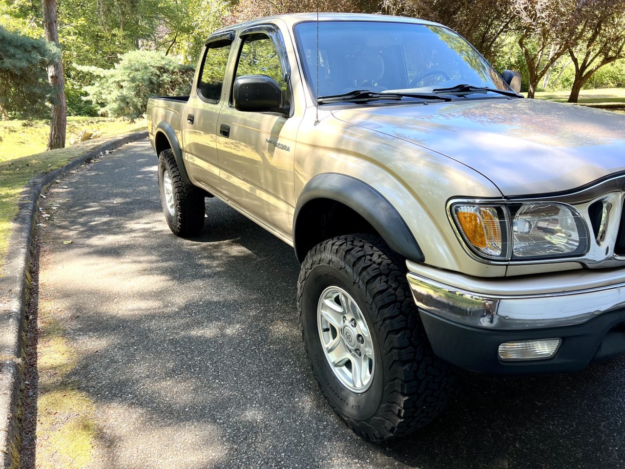

    New replacement OEM wheel with a much better refinishing job then the bad one I had got, however the new OEM center cap still didn’t want to clip in. Annoyed. So I left the wheel in the sun for a few hours on my deck and put the center cap in the freezer. It still didn’t want to push in but one good hit with a rubber mallet and things were set. I’ll get it mounted this week.

    The badly refinished passenger front wheel has been swapped out for a properly refinished wheel, which now fits the center cap. So much better. The previous wheel was so bad the guys at the tire shop actually remembered it commenting it stood out because they couldn’t read the stamped writing on the wheel.

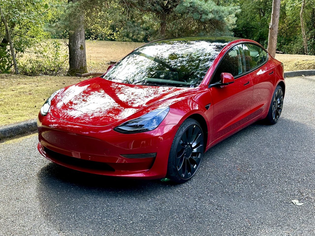

    The Tacoma has now been relieved from daily driver status by the new Model 3 Performance.

    That's a lot of red. Let's start the betting on days to next speeding ticket?
