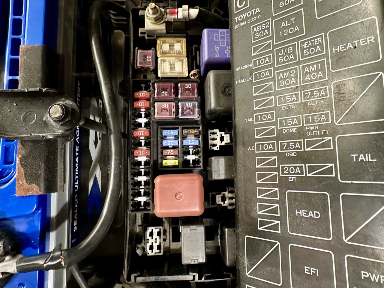

    Picked up the X2Power Northstar 24F today, and installed the HKB +0.5v voltage booster, per my battery thread, replacing a Less Schwab battery going on 5 years old. Thanks @daveeasa for lending me a voltage booster. I've got a booster coming now from HKB that should be here later this month. I googled for a coupon and used AUTO10 to get $40 off the battery with buy online and pickup in store.
    I'll need to pick up one of the adjustable tie downs sold by a member here to appropriately fit the battery. I ran one on my 2nd Gen and it was a well designed product.
    Booster swapped into the Alt-S circuit
    This is one of my favorite mods for the older trucks, as the +0.5v boost and more powerful battery makes such a difference in lots the small things. The truck starts faster, the windows operate faster, the headlights are brighter in addition with all other lights. It just gives a bit more pep to all the electronics in an old vehicle.

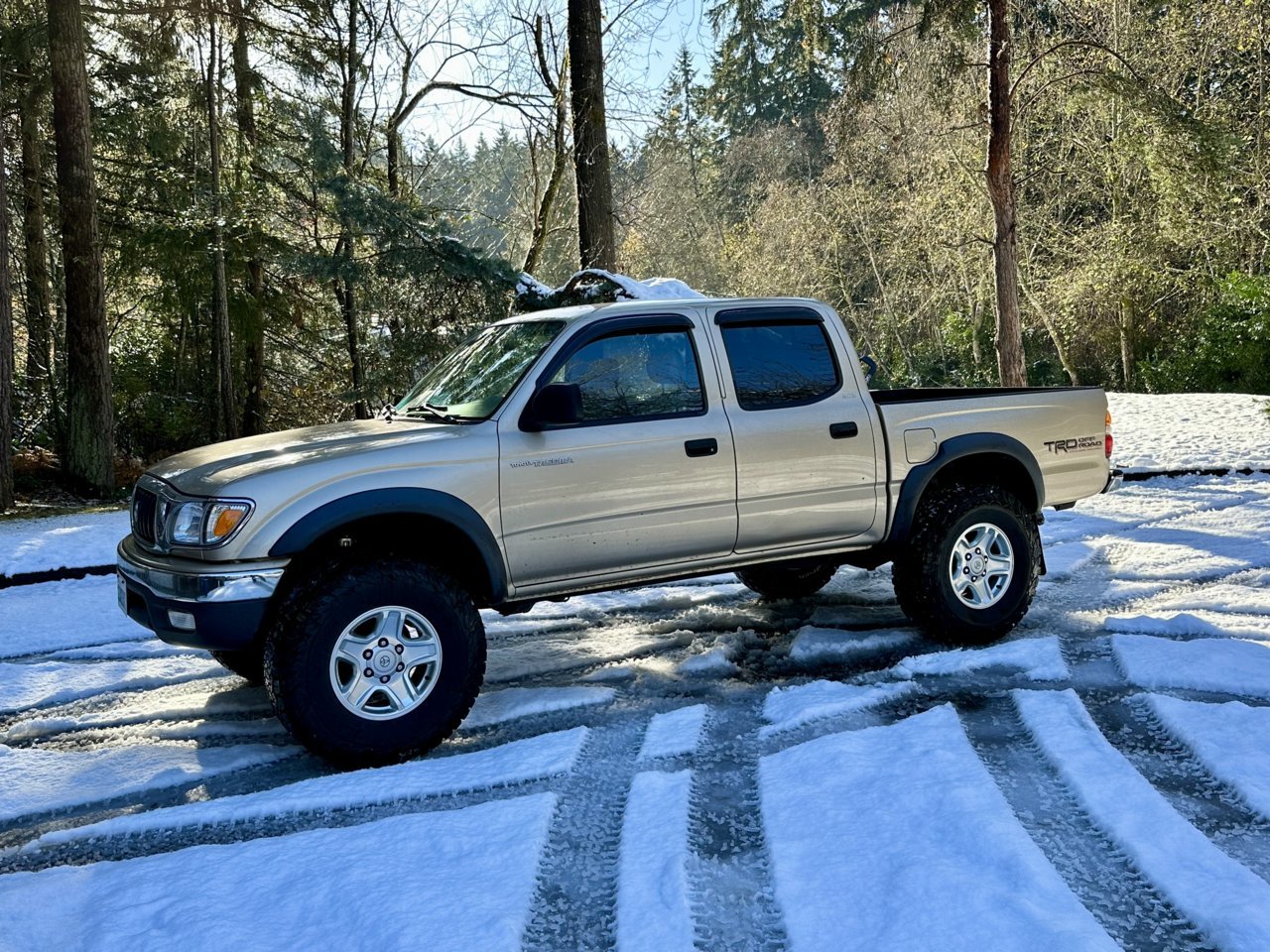

    We've been getting on and off snow throughout the week, so the truck has seen a lot more use. The Tesla can handle it, but it completely trashes the car. And some of the snow rut piles in the neighborhood seem like they could contact the car body. Much of it has already melted today.

    Chains plus AWD, must do doing some pretty extreme snow driving...

    The 0.5v booster is what I would recommend, it is safe to use on your 04. Multimeter testing can give an approximate idea, but because alternator voltage fluctuates so much depending on conditions and demand, a single data point comparing before and after doesn’t really show the full picture and may be under/over the +0.5v change. I really like the voltage logger I used in the battery thread to understand the before and after, granted they tend to only last for a few months but it is enough to get the data of interest.
    HKB recently got the mini boosters back in stock after being out for a long time. The truck takes micro fuses, but mini works fine, and is what is used in the picture I posted. I ordered one of the last micro versions. I’m sure these will sell out quick again:
