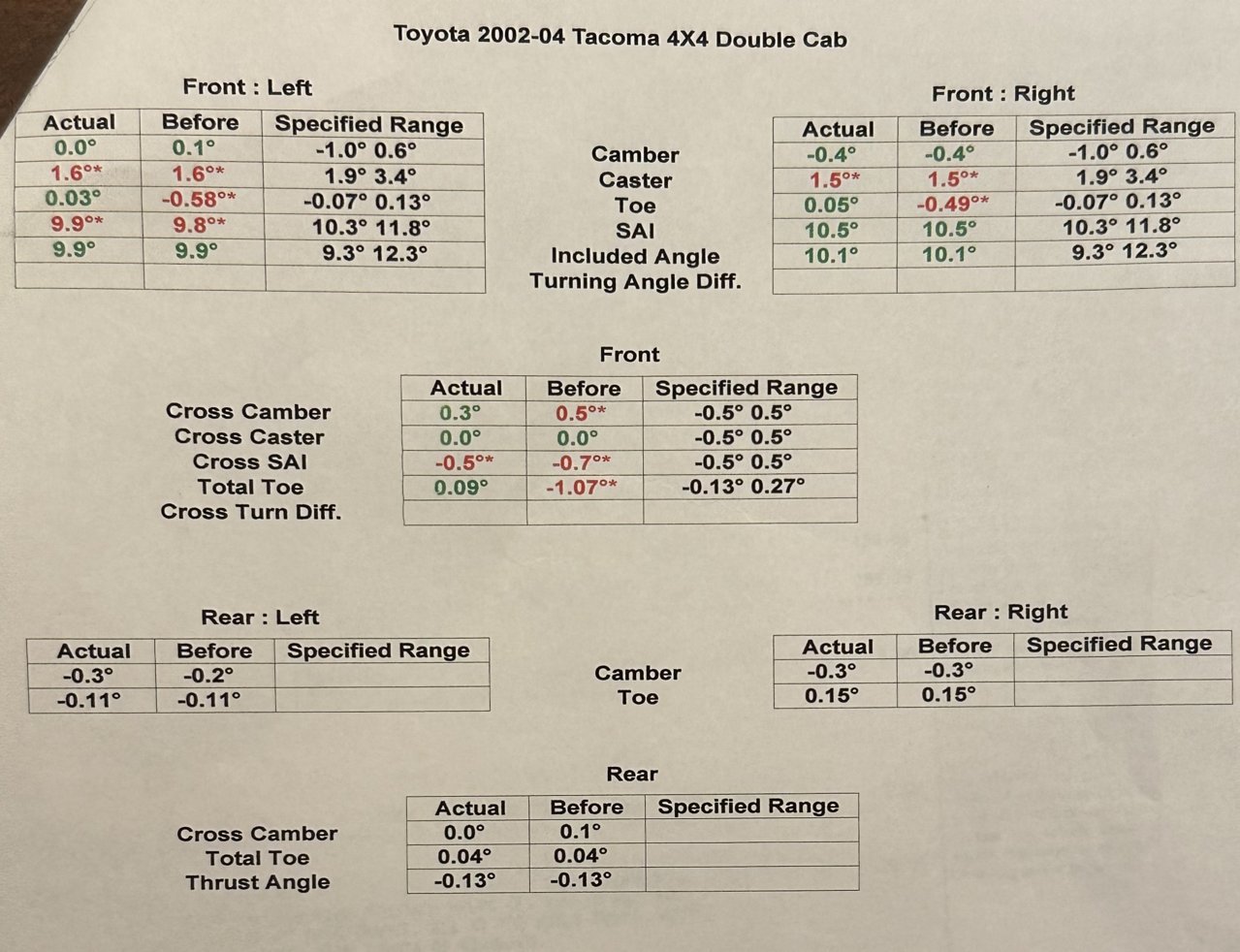

    Taking the Tacoma across the mountains to the other side of the state next week to visit the folks. 1 degree F this morning with 8” snow over there. I knew the toe on the truck was way out of alignment, like you could tell just looking at the truck’s front end, and it made steering sloppy. Not something I really wanted if the drive ends up being one where 4wd is required a majority of the time. And not something I want wearing on the newer tires either.
    So I took it into Toyota for the alignment, the Firestone grade shops never seem to do an adequate job.
    The caster is fubared due to the lift and OEM UCAs, that is expected. Toe as anticipated was way out of spec and corrected. I wish I had asked about the SAI spec though and why they couldn’t get it within range on one side. Having a lifted vehicle, you can’t always get all the specs green, but it seems like that should have. Picking up the truck was a bit rushed and chaotic though, the building next door had caught fire and streets were shut down and emergency vehicles everywhere as it was snowing causing a traffic nightmare. We Ubered there for pickup with my kid and it just wasn’t the environment to study all the things as carefully as I normally would have.
    After getting the truck back the steering feels far less numb and more responsive. Prior if shaking the wheel back and forth between 10-2 the truck didn’t really do anything. Now it responds. The truck also tracks better.

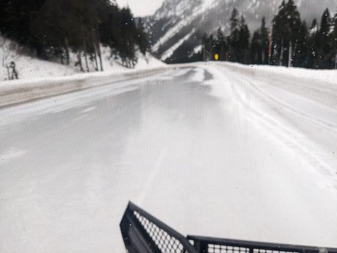

    Pic from the DOT on the highway 2 closure causing us to take the long way around. Zamboni worthy ice 6” thick over the highway from freezing rain.
