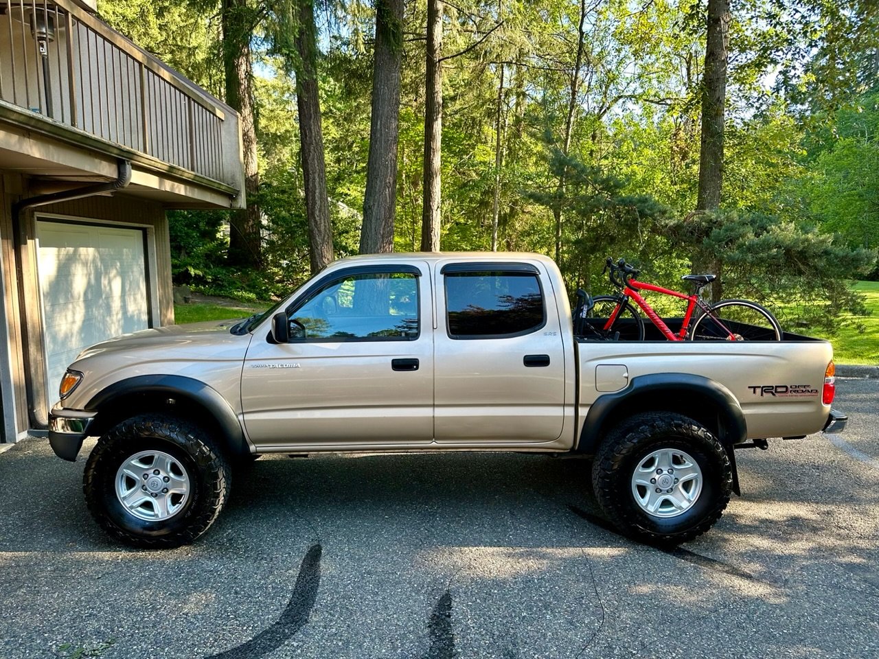

    The taco has been too-long neglected for detailing. Did a sub-par quick job today to head to the opening cycle racing night, including hitting the faded fenders with a back to black treatment. It deserves better still, but at least a minor improvement.

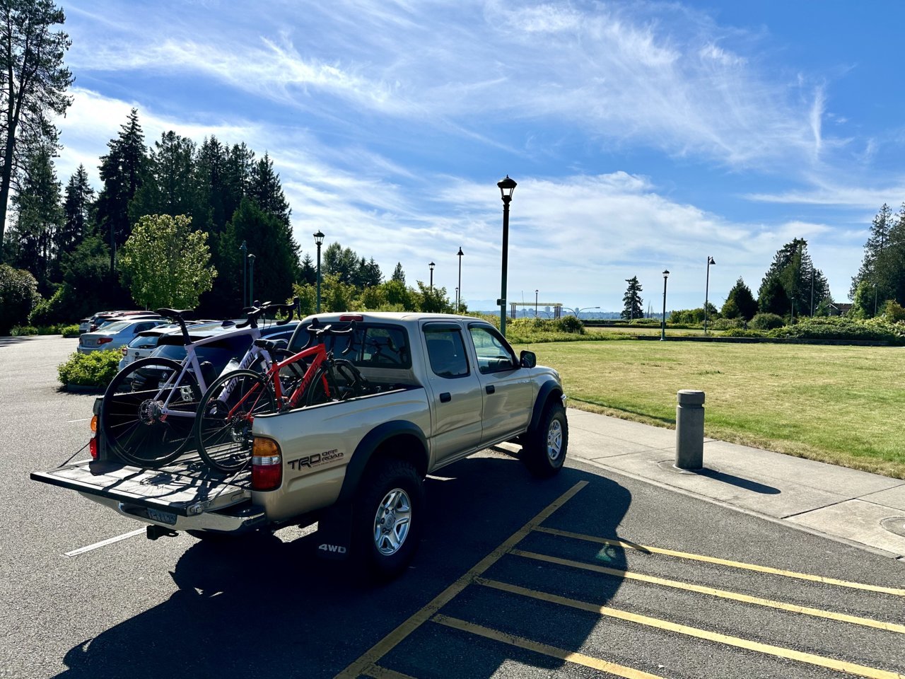

    Perfect weather today. Love loading the bikes in the 1st Gen and adventuring off to some trails.

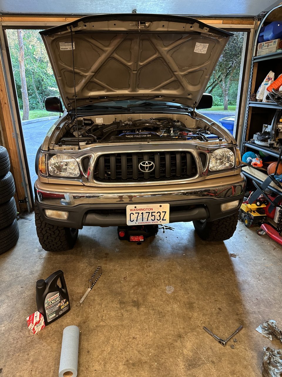

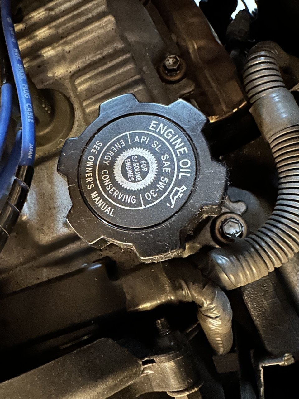

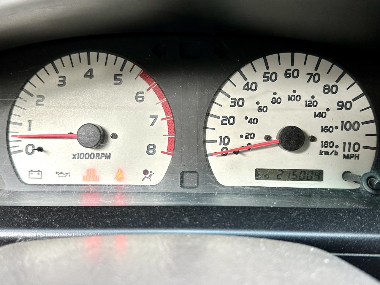

    Changed the oil today. I do not miss how much of a PITA the filter is on 1st Gen vs 2nd Gen.
    OEM filter PN: 90915-YZZD1
    Oil: 5.5qt 5w-30
    This round I went with 5qt Castrol High Milage Synthetic 5-30, plus 0.5qt of Mobile 1 high milage synthetic left over from the last change. And always the OEM filter.
    Toyotas OEM filters are some of the best, and modestly priced. Autozone even stocks them if you are in a pinch. Toyota factory seals the end of their filters to ensure no contamination.
    Some a-hole (yours truly) put the filter on too tight last time making it a Royal pain to get off with filter pliers in a difficult location. Tried not to repeat that mistake this time.
    While the Toyota spec was later updated to promote 5w-20 for increased fuel economy regulations, I stick with the original 5w-30 spec the engine was designed for.
    I saved an oil sample to send off to an oil filter study again.
    Oil changed at 215,004 (4 miles behind schedule)

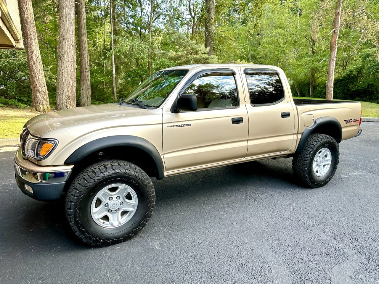

    Washed, waxed and buffed today. Pretty sure the Tesla is jealous on the TLC. Had a car collector compliment the truck at a local brewery.
