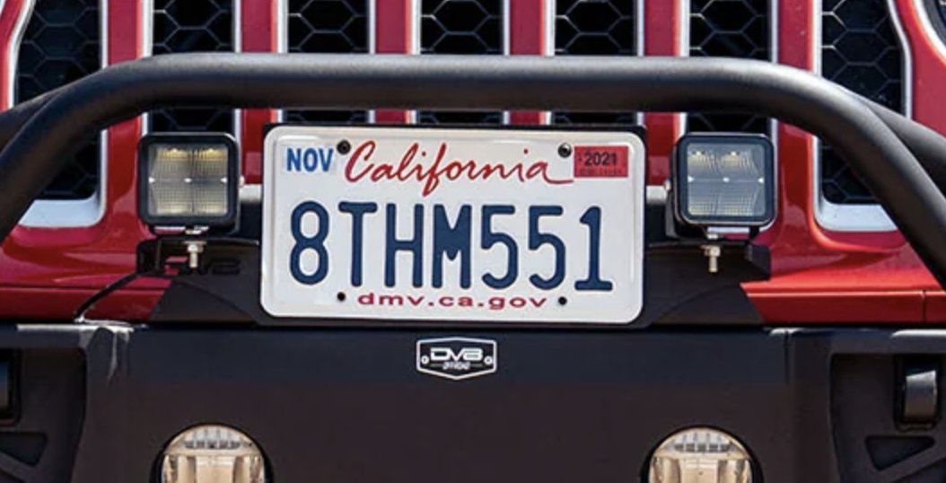

    This license plate pod light mount from DV8 may do the trick.
    Those are 3" pods in the picture, the 6" round 500s would obstruct the top corners of the plate. In my state the tags are only required on the rear, and with the round curvature the letters should remain unobstructed in a head on view.
    DV8 mount
    https://dv8offroad.com/products/universal-license-plate-mount-w-pod-mounts
    Using all 4 plate mount locations, the bumper seems rigid enough.
    The Hella 500 mount point is at the back of the lamp, so it looks like clearance shouldn't be an issue.
    I do like that the bull bar places the fogs lower, and I am not a fan of fragile lights being the leading edge of the vehicle, but I do like the minimalist mounting.

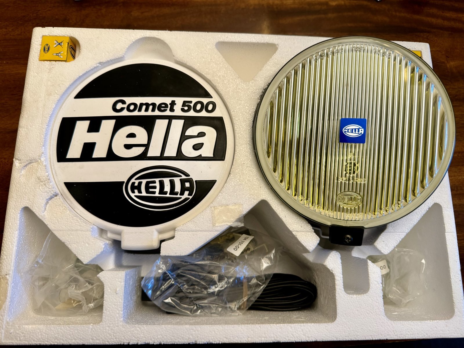

    I picked these up potentially for the Tacoma, new old stock of Comet (yellow) 500 fogs. Unlike modern 500s that are made in India and not available in yellow, these are the OG from Germany.

    Is the body and lens made out of plastic?

    The lens is glass, the reflector body is metal, the rear housing cover is plastic.
    The covers are actually useful to deflect rock impacts with the glass lens. I’d likely run covers 9 months of the year since my primary use for fogs is winter mountain pass crossings. While the Comet covers are retro, I’d probably swap for Black Magic 500 covers.

    2003 DCSB TRD OR
    Well those German Hella Comets were disappointing compared to the modern clear counterparts. I'm going to order up some of the newer yellow Indian made versions to compare.

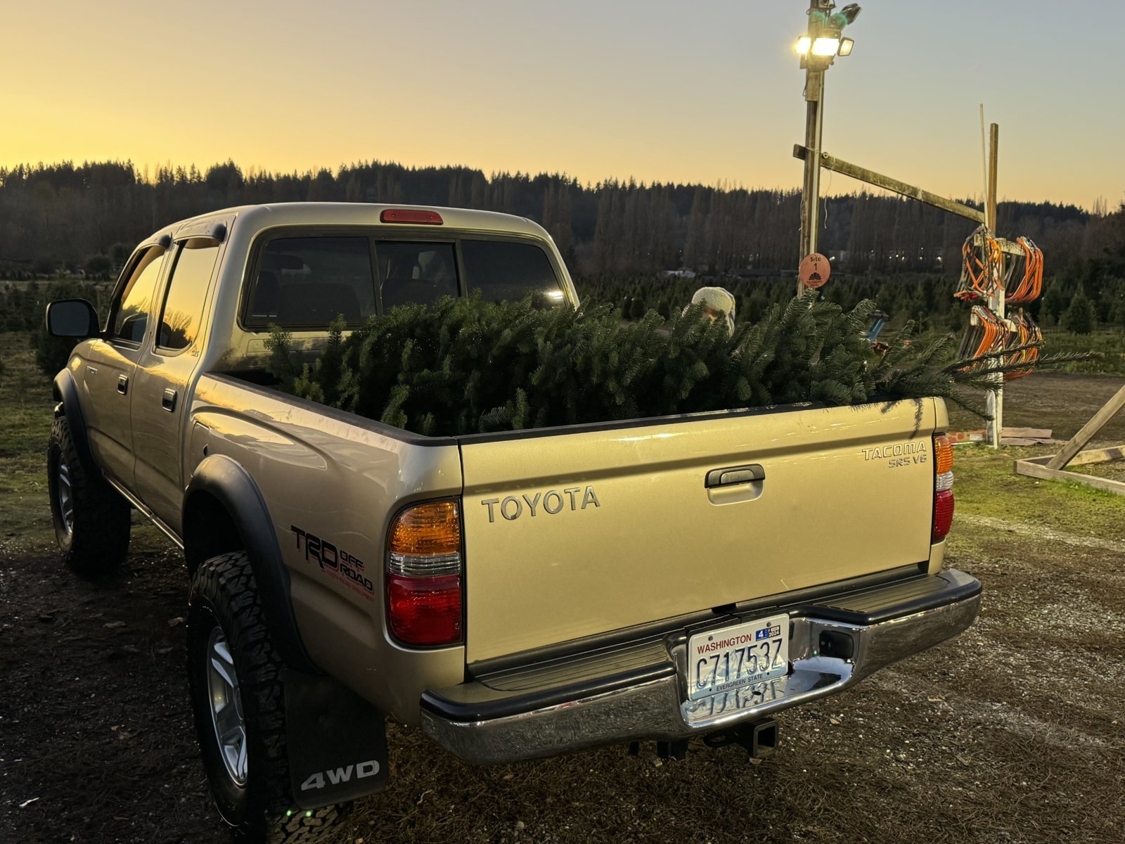

    Pulled the truck out for the first time in a while to pick up our tree today. Just shy of 8’ loaded in at sunset.

    Right On! Looks like a nice Noble Fir and the truck looks good as well, Happy Holidays Crash!
