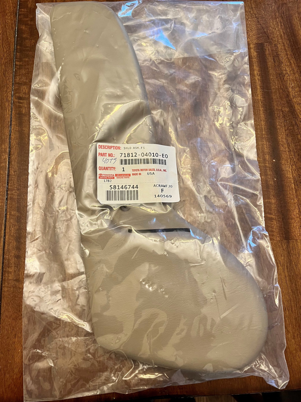

    It is also amazing to me I can order a 20 year old OEM interior seat trim piece directly from Toyota and it is readily available. I'll wait for the seat reinforcement to install.

    its hit or miss with whats still available and whats not. but yea.. theres still a fair bit out there
