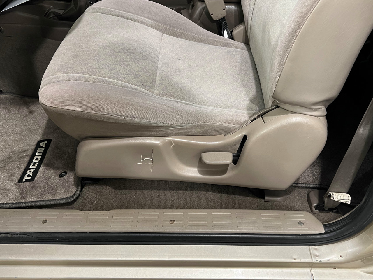

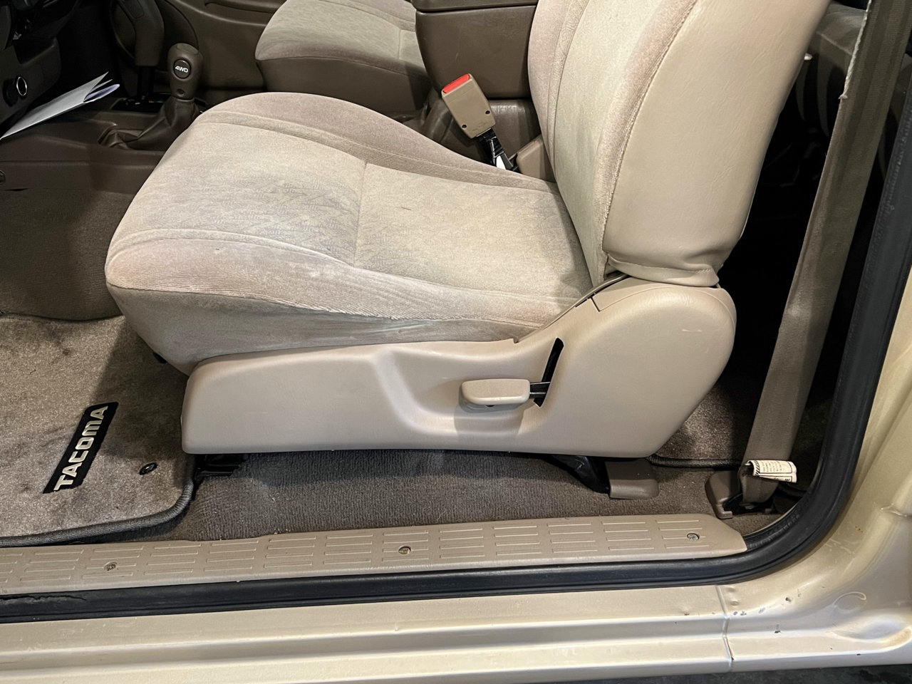

    Fixed the broken driver seat side today, and added the the reinforcement recommended by @JasonLee from @mechanicjon (The link below has easy to follow youtube videos for install)
    https://www.tacomaworld.com/threads/1st-gen-tacoma-seat-trim-side-cover-reinforcement.501569/
    Here is what it looked like. Minor, but the mildly annoying to see every time you open the door.

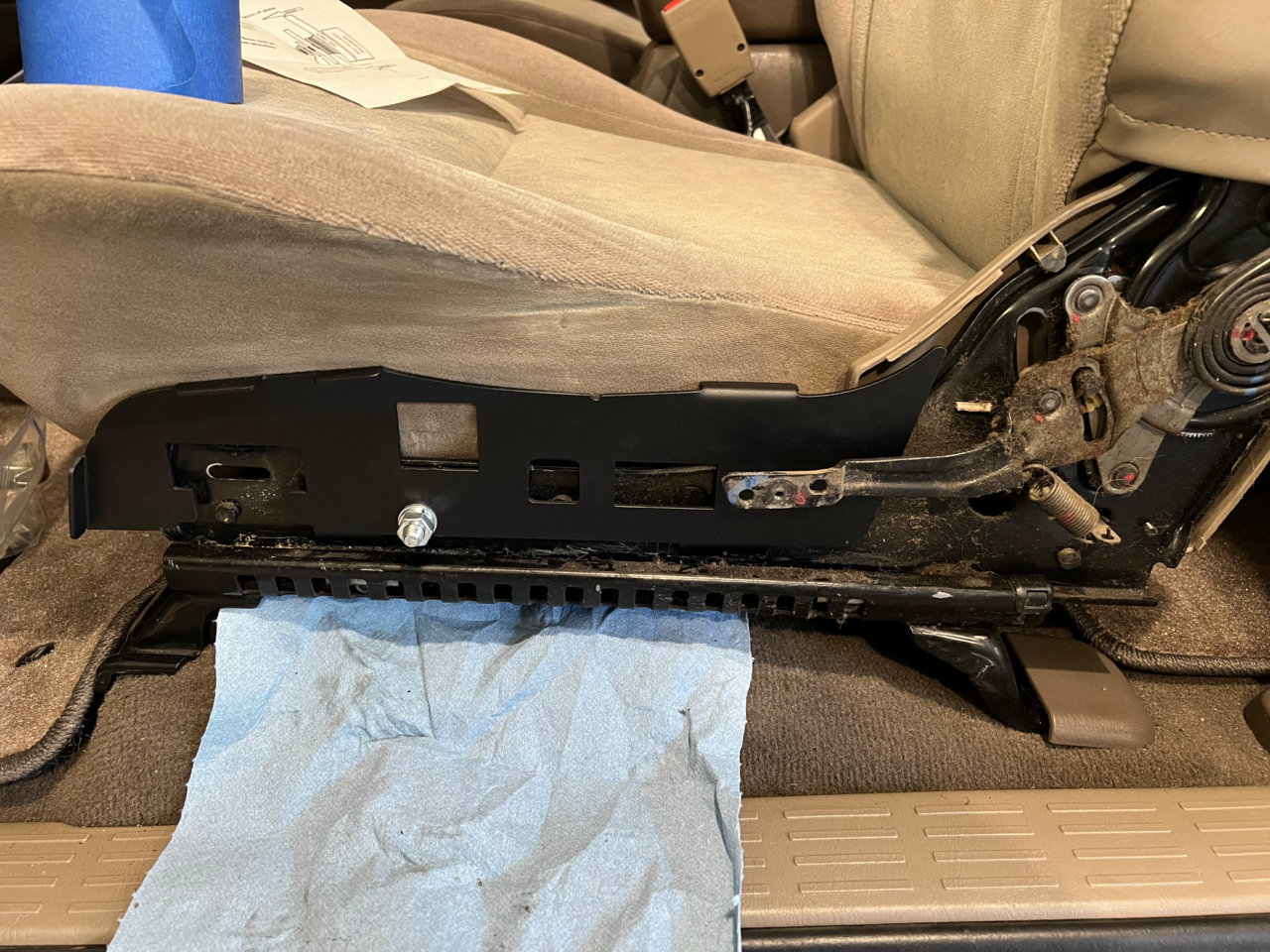

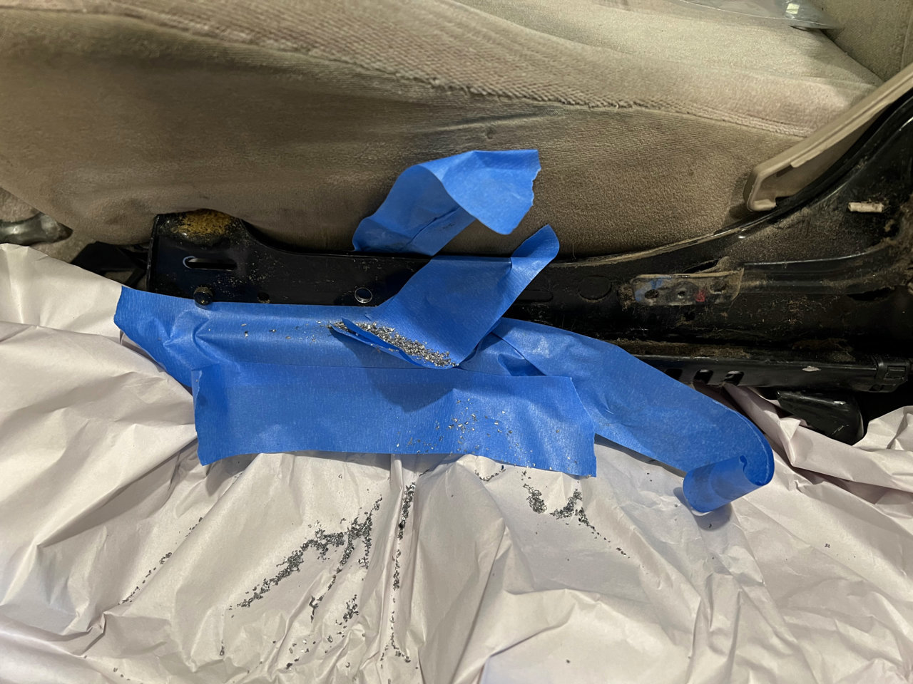

    Only 1 hole needs to be drilled for the reinforcement install
    Steel reinforcement bracket installed. I painted mine with rustoleum as well as the hole drilled in the OEM seat bracket. The bracket prevents the side for the seat from applying pressure to the plastic panel when entering and exiting the truck, preventing the cracking from reoccurring.
    Installed the new OEM Driver side seat plastic panel in tan new. 71812-04010-E0 ordered from a Toyota dealer off ebay
    The reinforcement is solid and well thought out. I may preemptively add one for the passenger side, though it does not currently have the issue. Happy with the outcome.

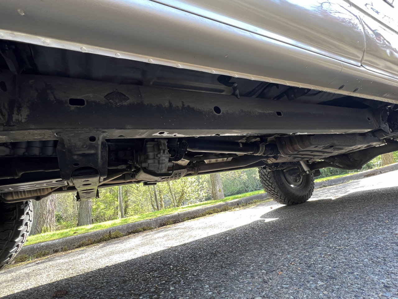

    I mentioned before I'd post a frame pic. The frame is completely rust free, not even surface rust.

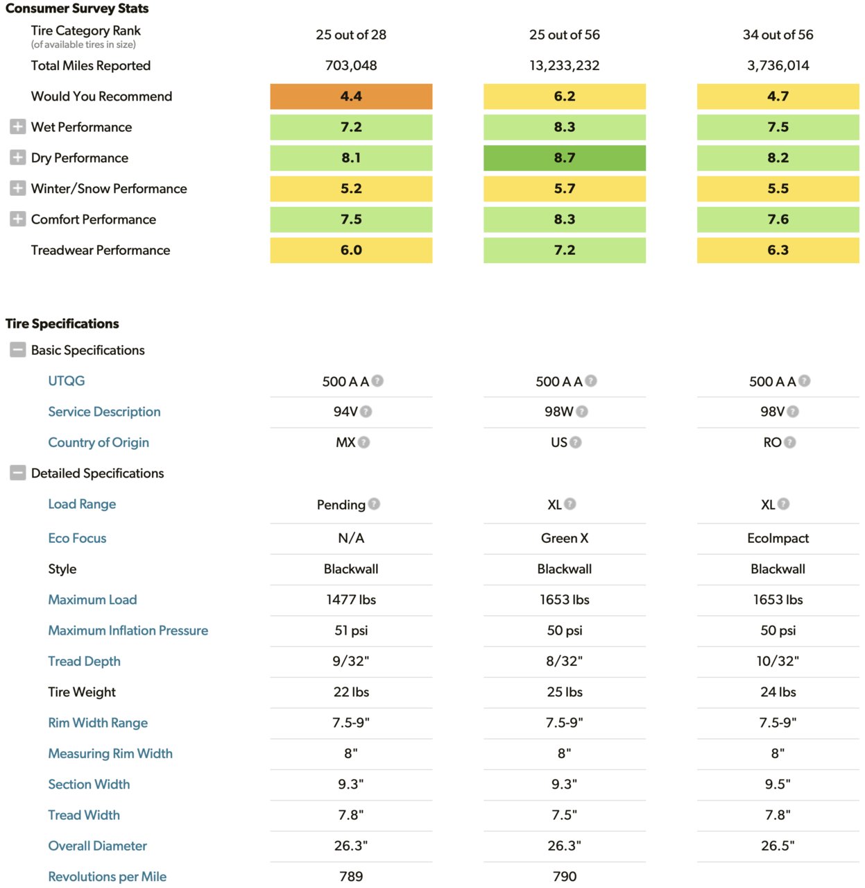

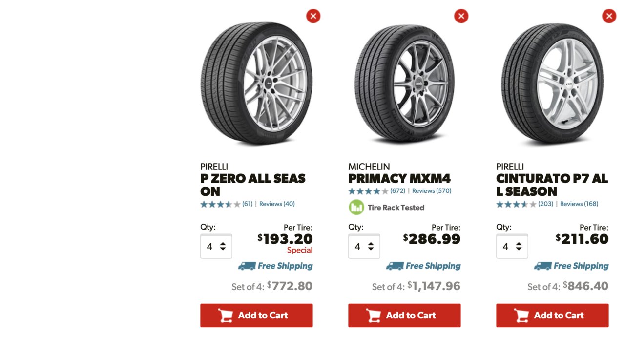

    Back on Tesla tires in 235/45r18 All Seasons, the Michelin MXM4 Tesla tires are a hard tire to beat. I'm looking for a lighter than stock (25lbs) low rolling resistance all season tire or a significantly lighter all season tire. Pirelli has a couple offerings worth considering, which are the lightest options I've found so far in the two catagories. The Cinturato P7 All Seasons are a low rolling resistance tire like the OEM Long Range with greater tread depth and 1lb lighter than stock the stock Long Range MXM4 tires. Looking at even lighter all seasons, the Pirelli P Zero All Seasons come in at an impressive 22lbs, or 3lbs lighter than stock long range tires.
    To put this in context, 3lbs x 4 tires is 12lbs of rotating mass on the outer most part of the rotating assembly (where it matters most). Rotating mass has 4x the performance impact as static mass, meaning removing that 12lbs at 4x is equivalent to about 48lbs of mass removed from the car which is listed as weighing 4072lbs, or about 1.2% vehicle weight reduction equivalent. The lighter weight will help in acceleration performance and general range, but for long range cruise the lower rolling resistance should be more beneficial. Both the Pirelli's top out prematurely early with a V-speed rating at 149mph short of the cars capabilities, whereas the MXM4s are rated to the proper 168mph. But I don't plan on tracking the car, so I don't consider 150+ mph speeds a factor.

    I like the research going into these tires. Where do you get the rotating mass is 4x static mass? Not questioning you, but genuinely curious. I've tried to find a factor to multiply added tire/wheel weight by before but never really came up with anything concrete.
