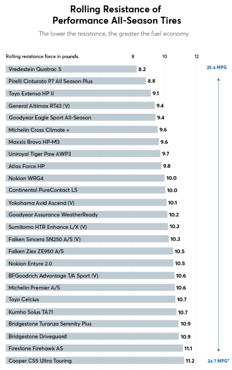

    Interesting measurement data of the rolling resistance force comparing Performance All Season tires from Consumer Reports. The Pirelli Cinturatos look pretty good, though the test set does not include Tesla's OEM Michelin MXM4 tires. There are 3 varieties of the Cintuato P7, the Plus listed below is actually a little lighter at 23lbs than the one I listed earlier at 24lbs. (Edit: Ah, the load rating is less on the Plus as an SL vs XL). From what I've been able to find, it seems like the MXM4 do a little better in the wet and light snow though.
    I thought this rolling resistance data was pretty slick so I paid for a CR account to see more, however their report test data is just a scale of 1-5 unfortunately, not showing the raw data as they did in the article here:
    https://www.consumerreports.org/tir...tires-can-save-you-money-at-pump-a1547901110/
    It was a general guideline from my vehicle design courses, if you look around online you'll see the same/similar figures used to generalize the affect of adding/removing mass on wheels/tires. It isn't perfect though, mass near the center of the rotating assembly has less effect than mass on the outside of the assembly so it isn't all equal.

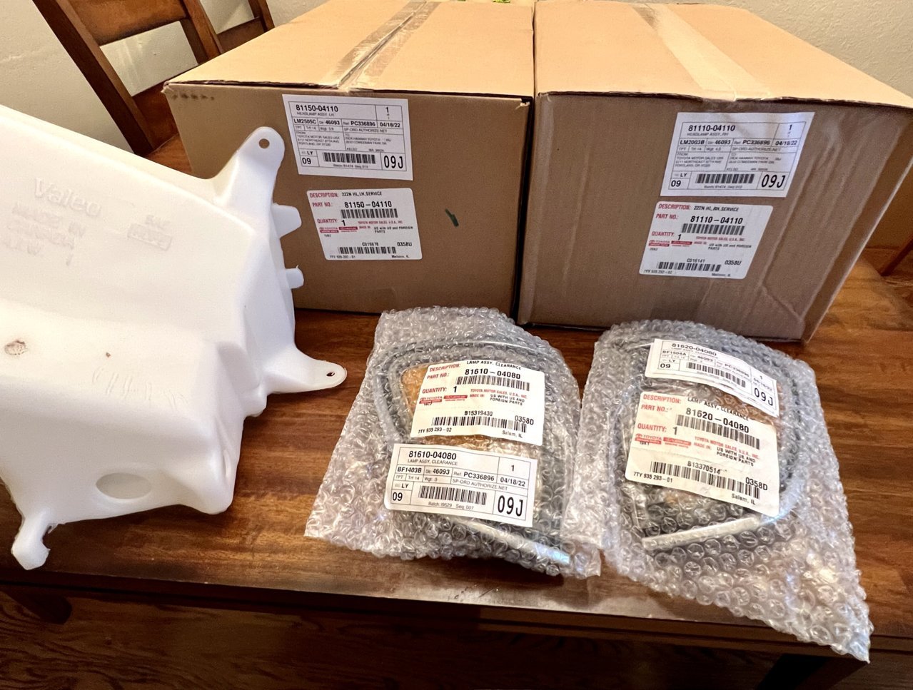

    Love items with the Toyota OEM part stickers, you know it is going to be quality stuff. New OEM headlights, OEM corner lights and OEM washer reservoir.

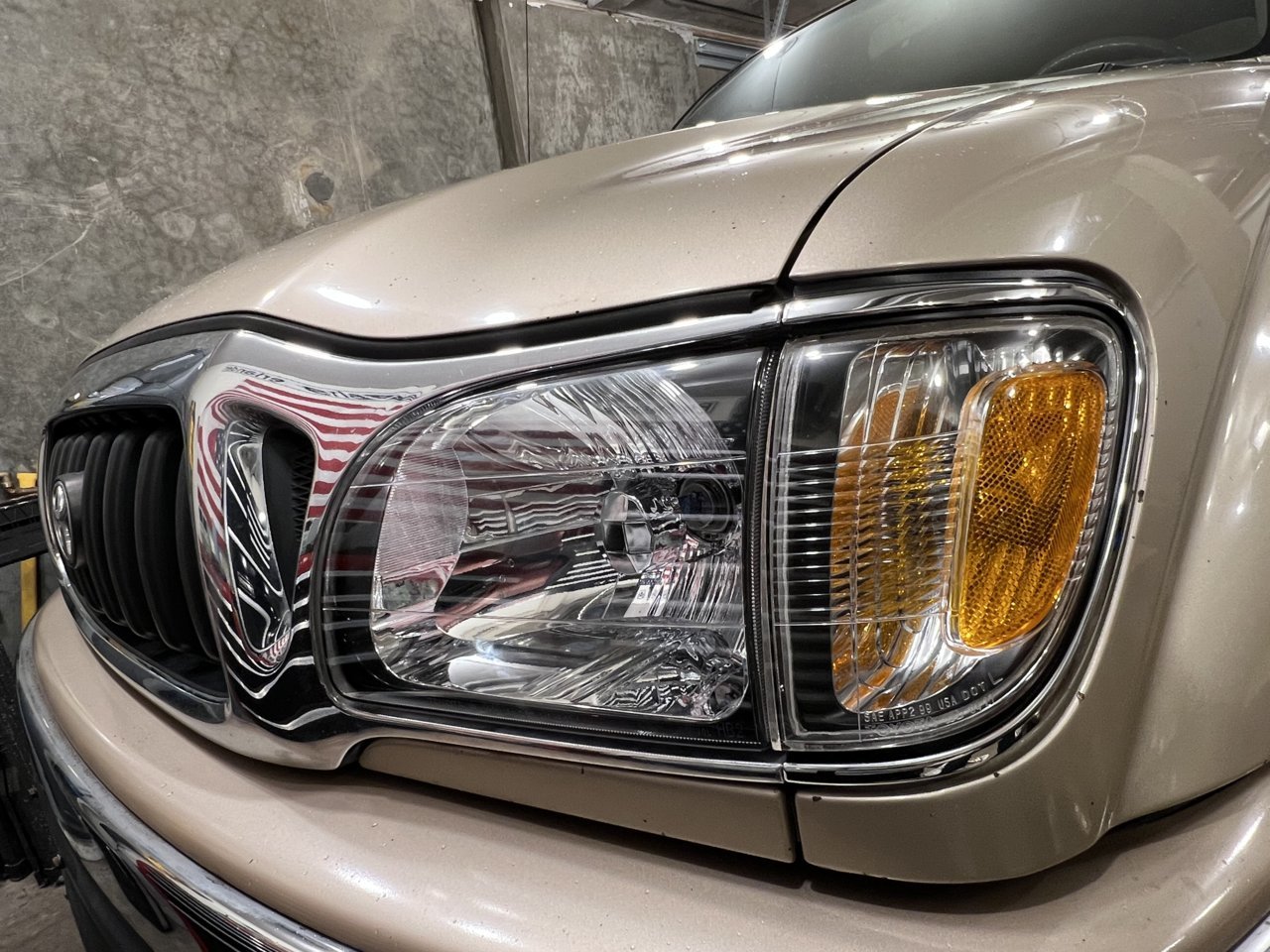

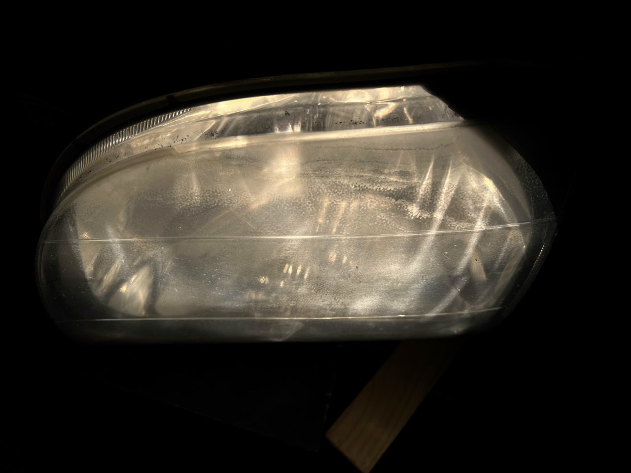

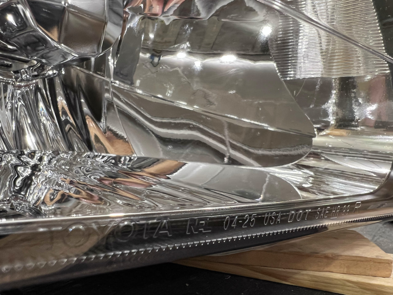

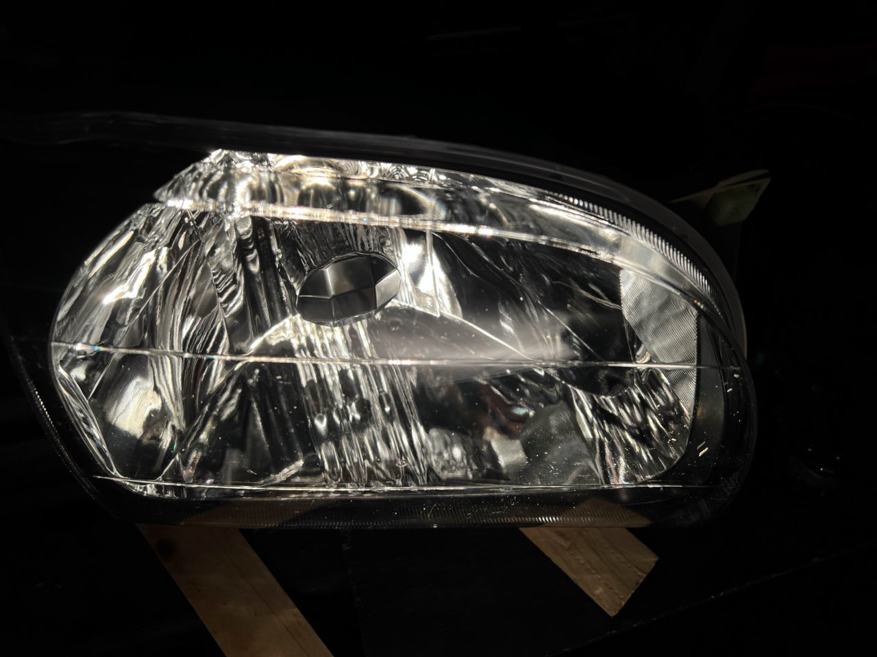

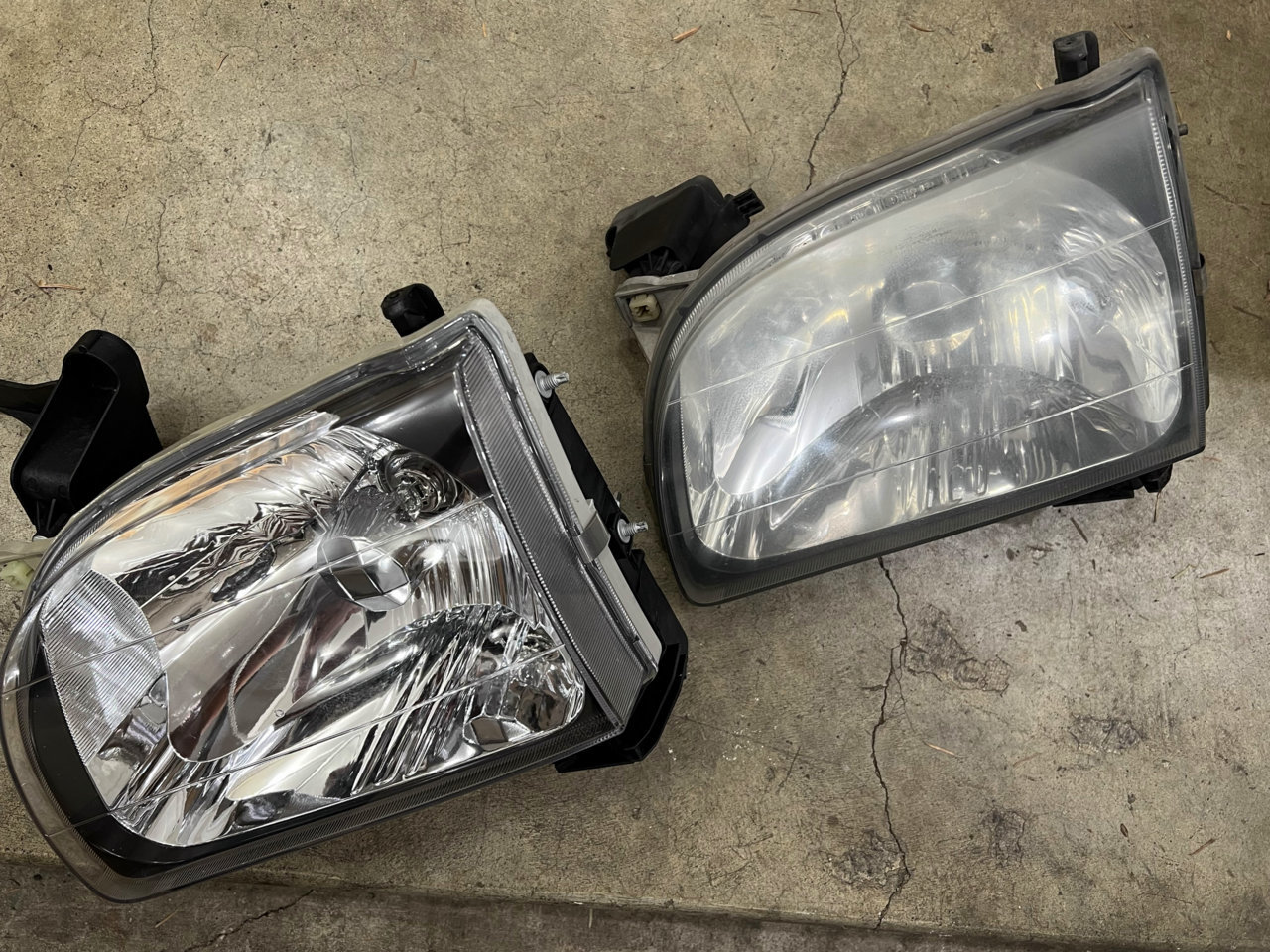

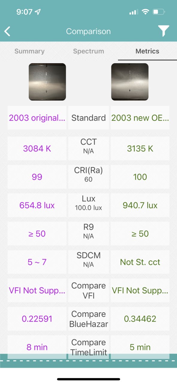

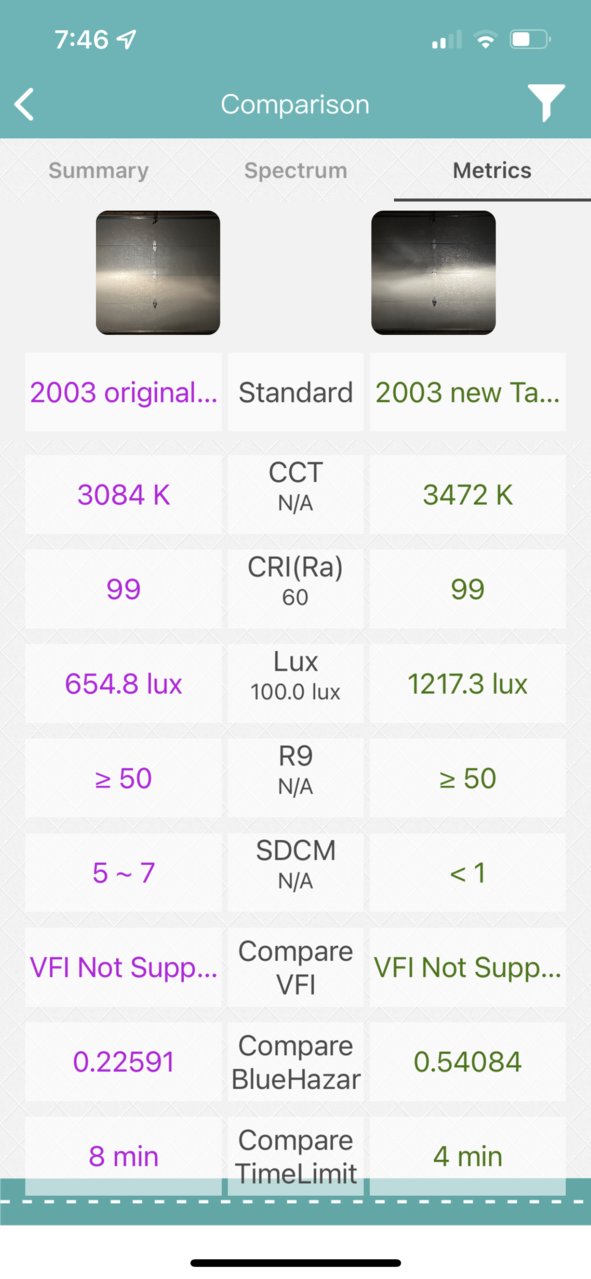

    Pulled the 19yr old hazed OEM headlights today to run some comparison tests against the brand new OEM units.
    Original 19yr old OEM unit
    New OEM
    Still made in the USA
    Old hazed OEM left vs new OEM right
    Visually the old units did better than anticipated given their condition.

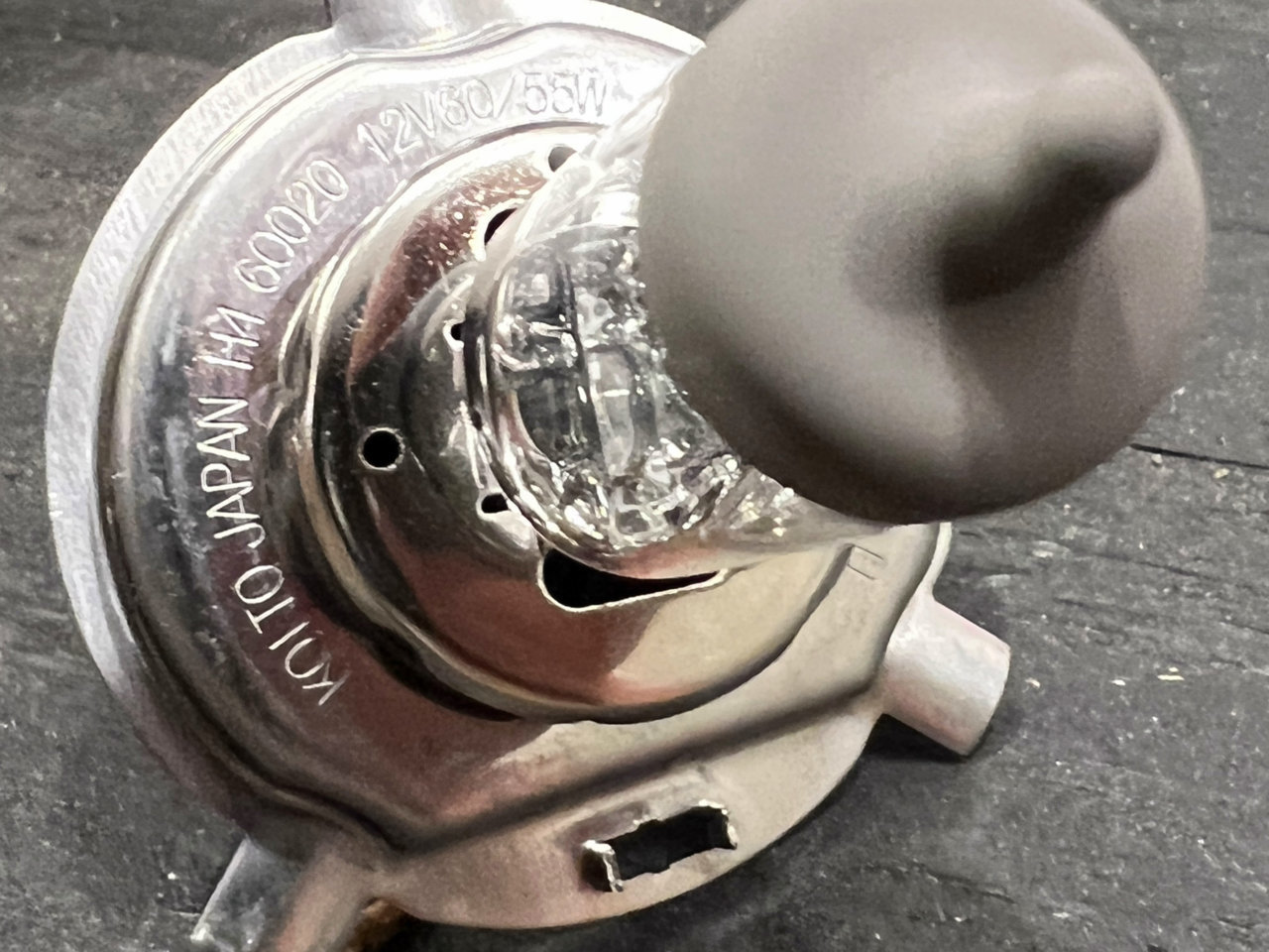

    The new OEM assemblies gained about a 44% increase over the old hazed units with used stock bulbs. I had thought the Osram German 9003 standard bulb was stock. Interestingly the new OEM assemblies came with Koito H4s from Japan.
    For running stock wattage bulbs, I'd personally go with the Philips Racing Vision +200 H4s as tested here: See updated +200 review in post #3169. However I had a set of Osram Nightbreaker +200s on hand, which tested very well but didn't quite beat out the Racing Visions, as tested here: Osram Nightbreaker +200 in post #4066.

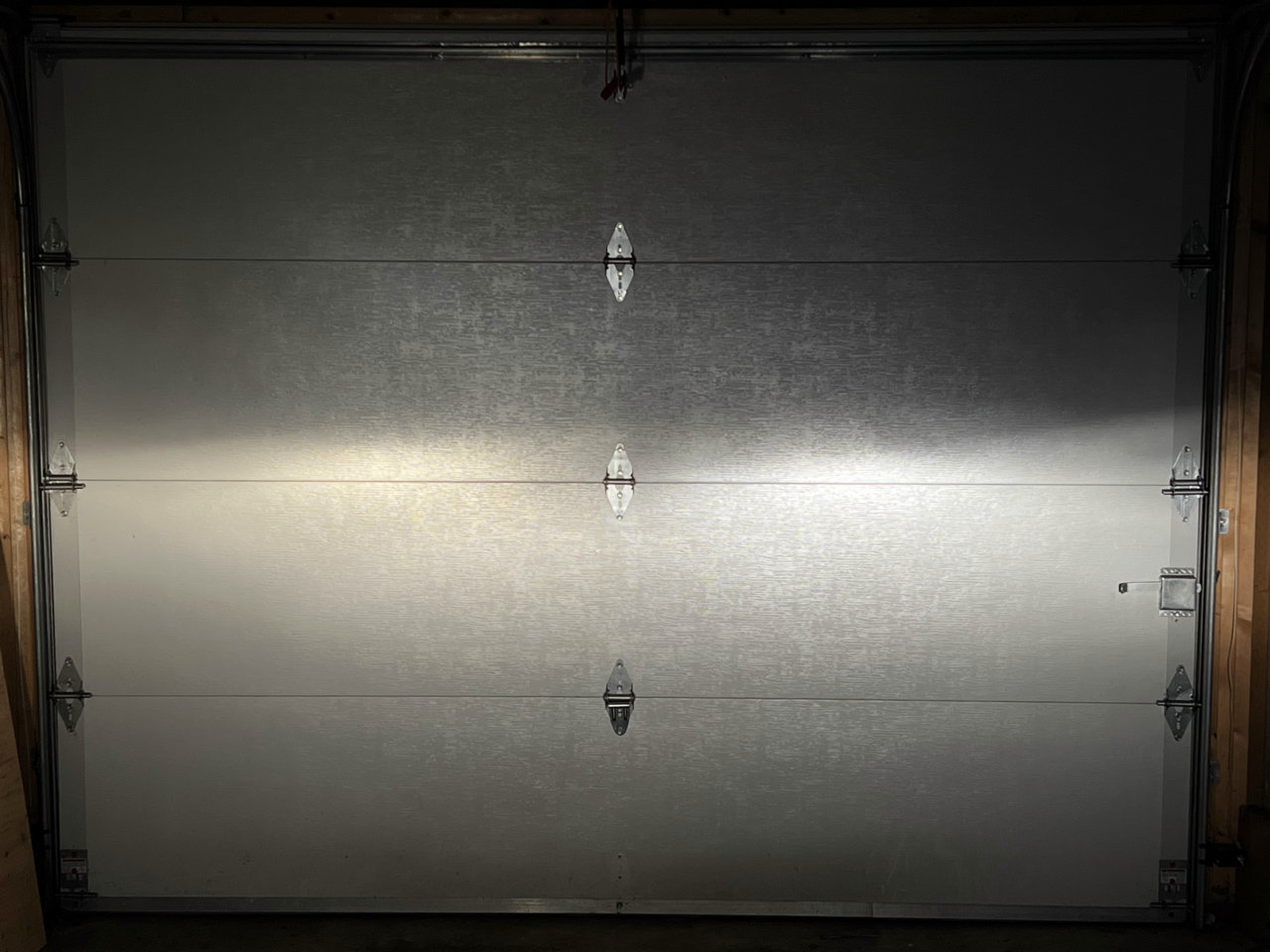

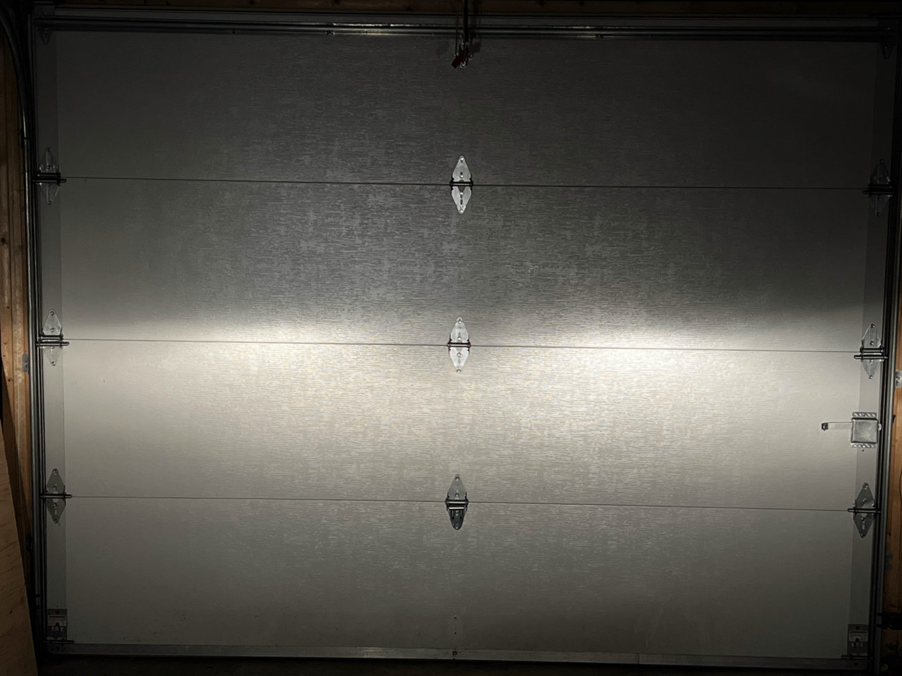

    Swapping the Nightbreaker +200s in and comparing to the old OEM units on stock bulbs.
    Old OEM left vs new OEM with Nightbreaker +200 right
    Old OEM left vs new OEM plus Nightbreaker +200 right

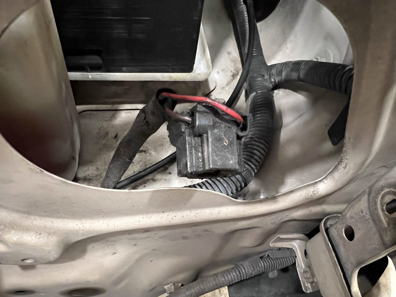

    About a +86% improvement in output using stock assemblies and stock wattage bulbs. Earlier I had posted I wouldn't be supposed if it is close to a 100% gain, so the results are fairly on par with what I expected. I didn't anticipate the old assemblies doing quite as well as they did, but my prediction for output gain was reasonably close.
    One of the things I forgot was just how small of a gauge the OEM headlight wiring is on the 1st Gens. The 2nd Gens definitely use heavier better wiring, which results in less voltage loss and higher output from the bulbs. @daveeasa I may take you up on that harness.

    Power or ground switched?
  12. Apr 28, 2022 at 1:03 AM
    #72
    Empty_Lord
    Empty_Lord Toyotaholic
    Mar 13, 2016
    #181186
    28,286
    Dan
    Northwest Indiana/Chicagoland
    These trucks are ground switched

    Ballin. New OEM headlights + OEM corners running Osram Nightbreaker +200s.

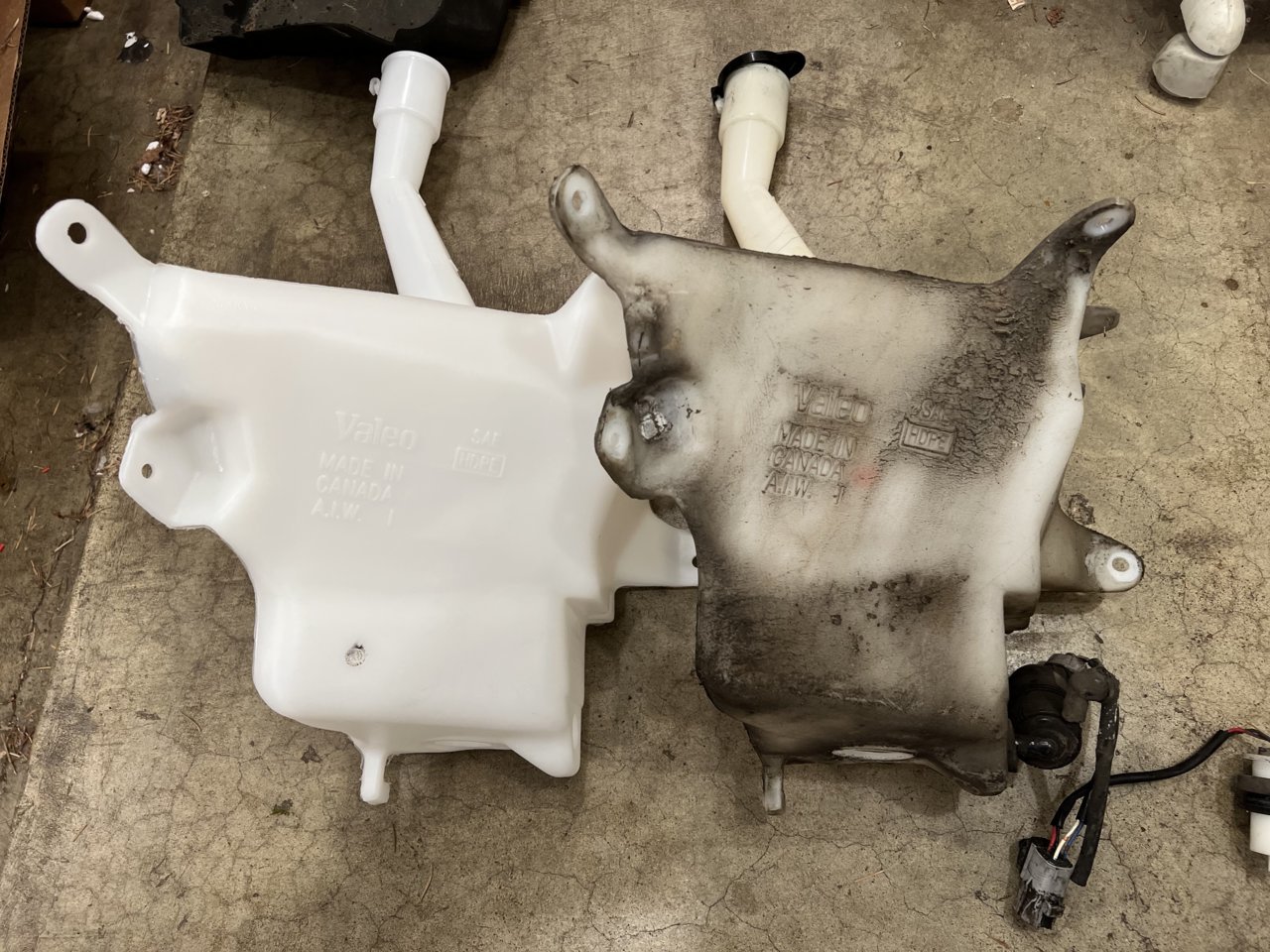

    The washer fluid reservoir had a leak, so I ordered a new OEM unit to replace it. After inspection of the seals and parts, the rubber seals from the old OEM reservoir unit were in impressively good condition. Reinstalled the new OEM reservoir with all the OEM components swapped over and the empty fluid reservoir light came on in the dash. Refilled and the light went out. Kind of an awkward part to install, the original unit had a removable forward fender liner stapled to it. Putting the fender liner shield on the new unit had no staples, so holding the liner/shield to line up correctly with the reservoir and get the bolts through while working around the tire was less than ideal for what seems like a super simple task.
    Only thing left of immediate importance is fixing the ball joint/clunk on the driver side front. Then likely further down the road a better tire setup and eventually suspension.

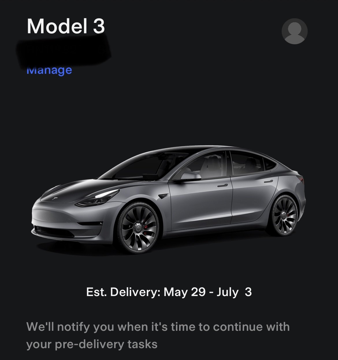

    In other news, the Tesla date was bumped up.
