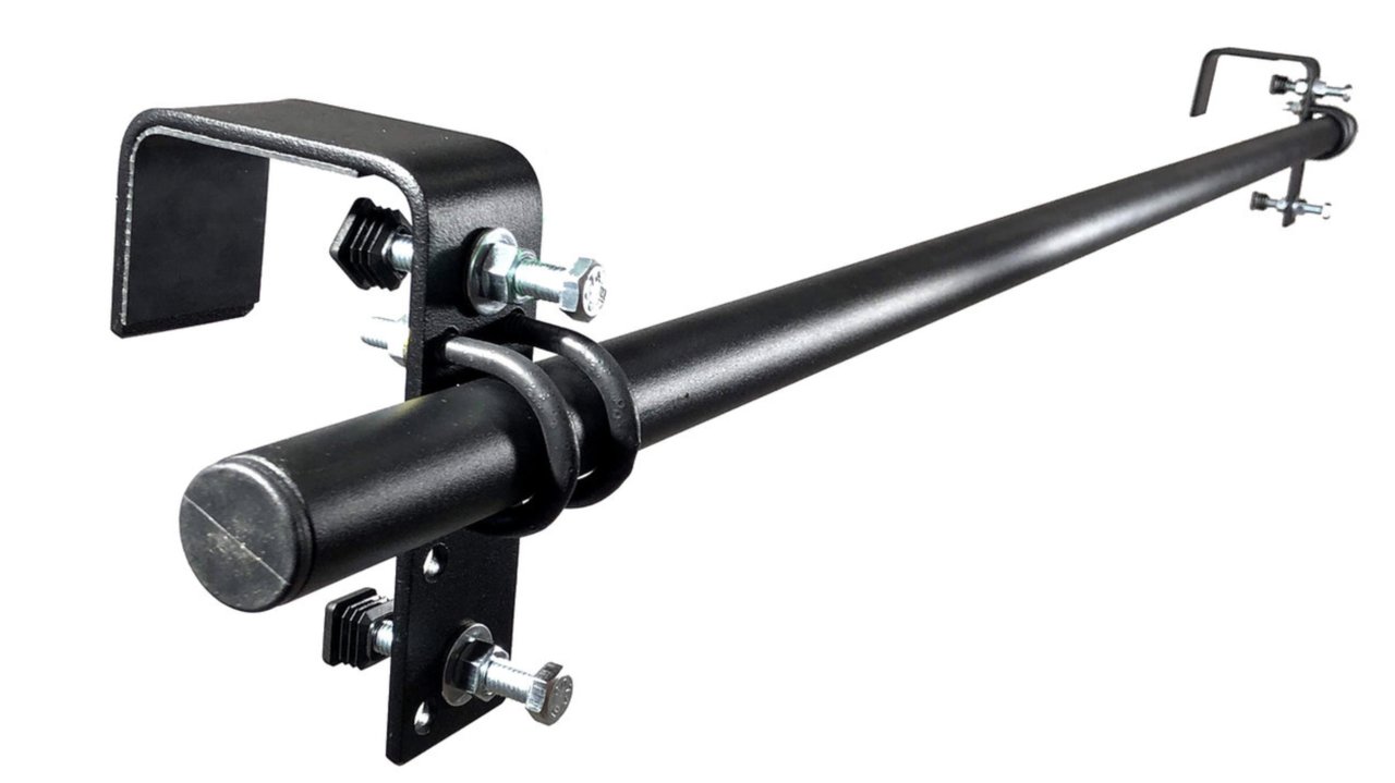

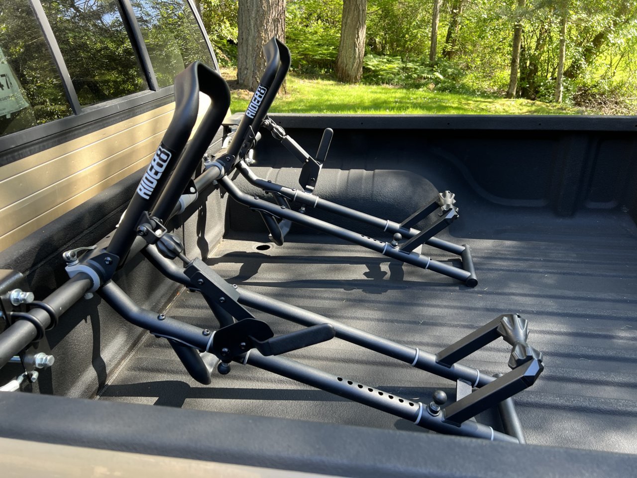

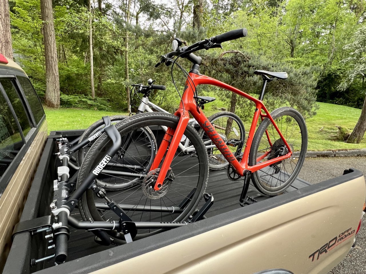

    One of my trucks most used duties is bike hauler, and with summer coming that need is becoming rapidly more apparent. My Ride88 racks were amazing in the 2nd Gen and Gladiator.
    https://www.youtube.com/watch?v=GPQhVsVLWyQ
    Both the prior trucks used bed track based mounting systems. The 1st Gen doesn't have a track system and therefor my racks do not currently mount in the 1st Gen. It also doesn't have the holes found in the full size trucks for the cross bar. So I finally ordered the hanger cross bar to mount the racks in the 1st Gen. Not as elegant as the other trucks, but will get the job done.
    https://www.ride88.com/product-page/hanger-crossbar

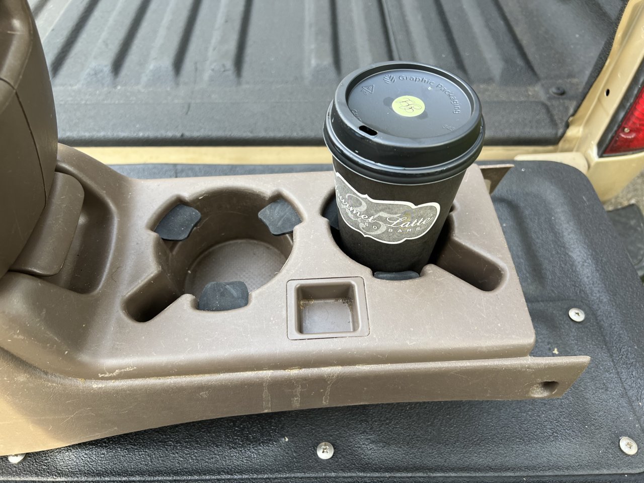

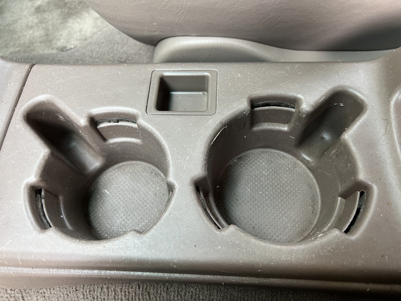

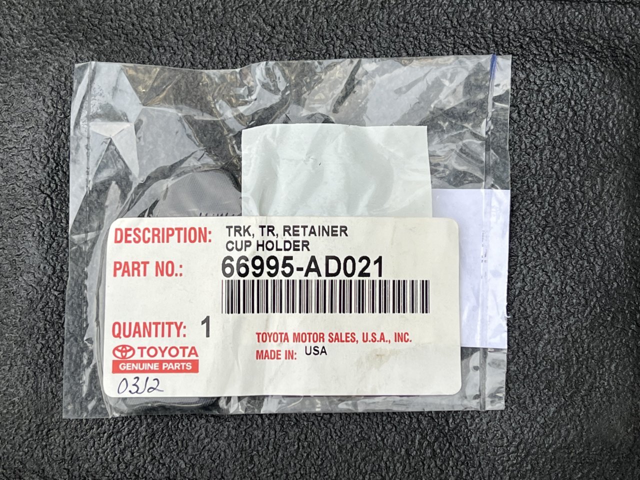

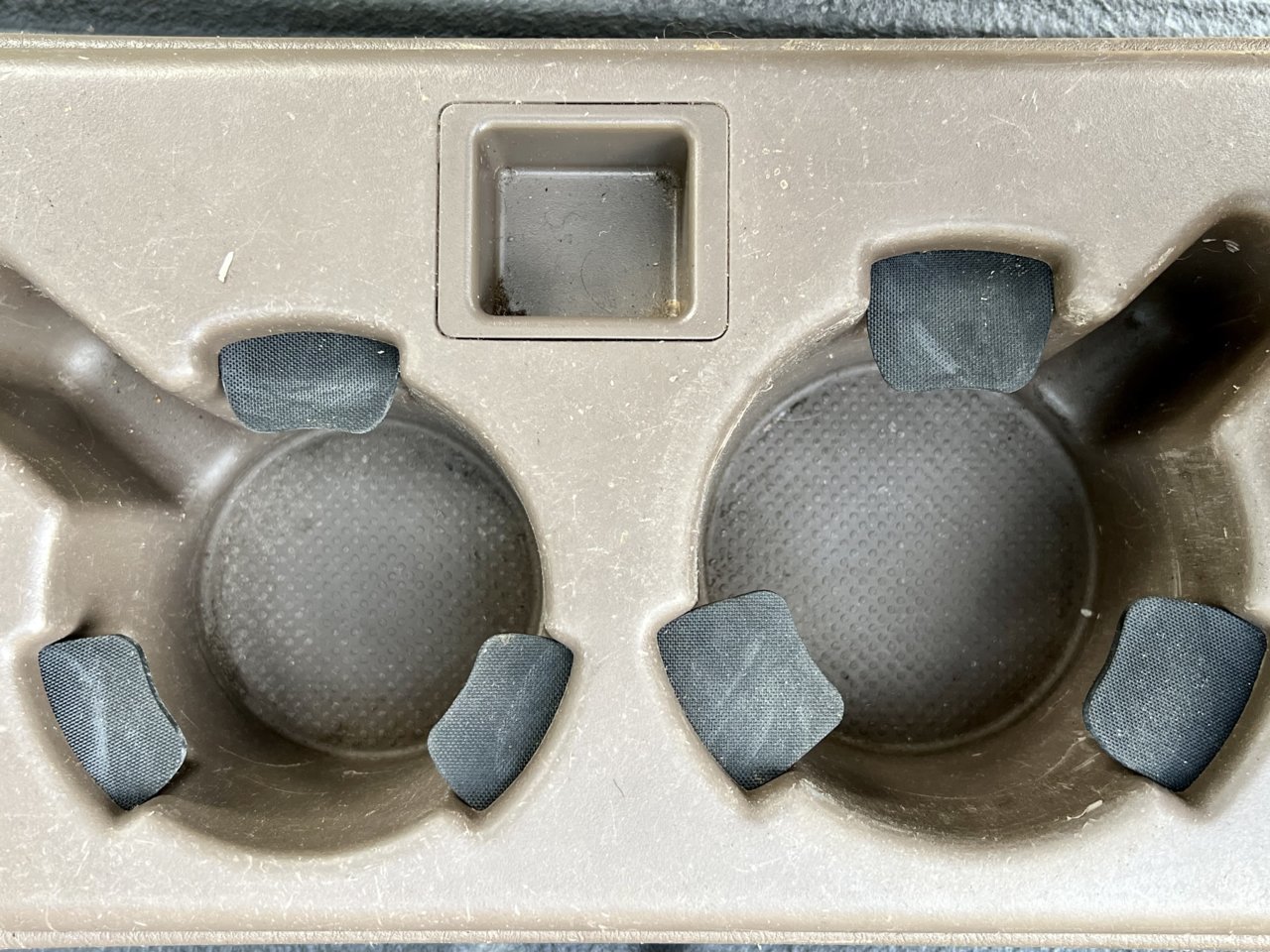

    Replaced the cup holder insert tabs today. As a regular coffee drinker, it is nice to set your coffee in the cup holder without it tipping over (which has happened with the cup holders in their present condition).

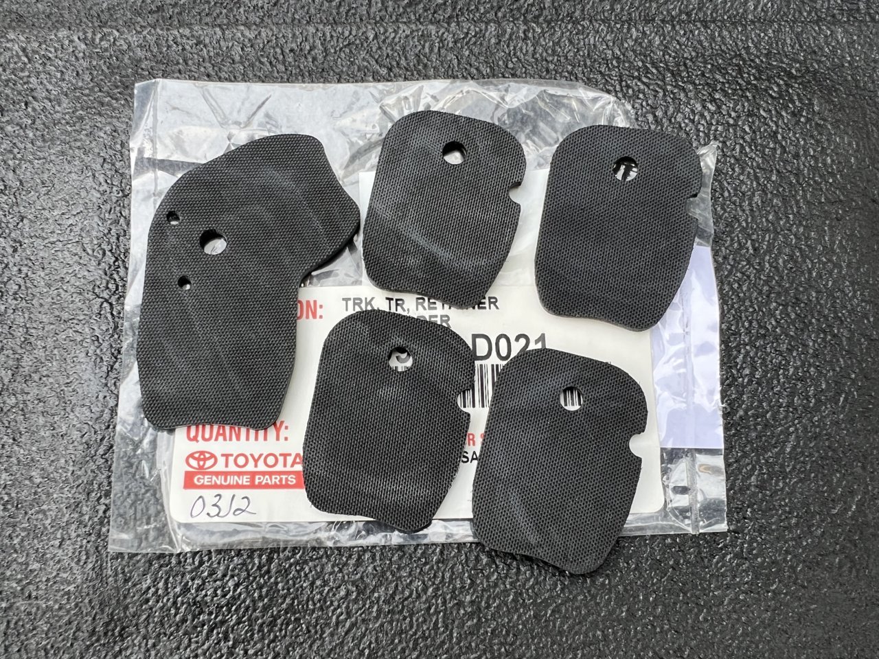

    New OEM cup holder tabs.
    These are made of an updated more durable material vs the original OEM ones.
    6 bolts/screws to remove the console, and 1 screw to secure each tab. I hadn’t noticed till now, the cup holders are not the same size, nor are the tab lengths. The forward cup holder is smaller.
    Coffee is held securely now.
    This is a simple one beer project. A good write up is here, so I won’t reinvent it:
    https://www.tacomaworld.com/threads/02-to-04-cup-holder-tab-replacement.159279/
    I did notice that while pulling the center console, the rear inner seat bolts were extremely lose on the seats. Fixed that and checked all others which seemed fine. I’m betting the seats were pulled for detailing for sale and not properly reinstalled.

    Used it this morning, so nice for the coffee to actually stay upright!

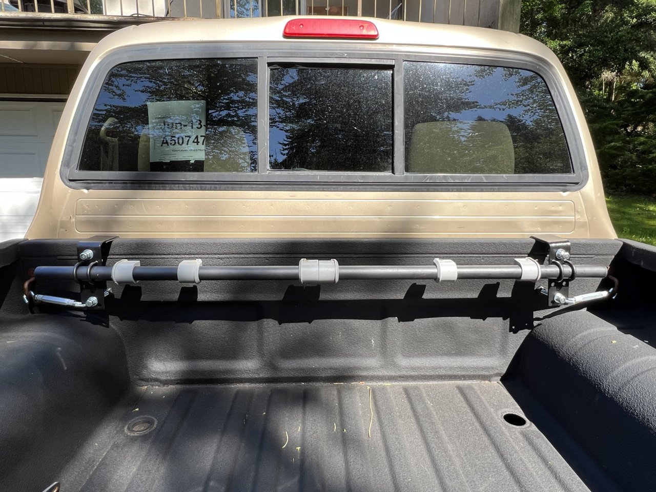

    Got the Ride88 hanger crossbar installed today to finally mount the bike racks. The tension system is a bit of a PITA to dial in compared to using the bed rails on the 2nd/3rd Gen. But once installed works great.
    Put it to use immediately after install.
