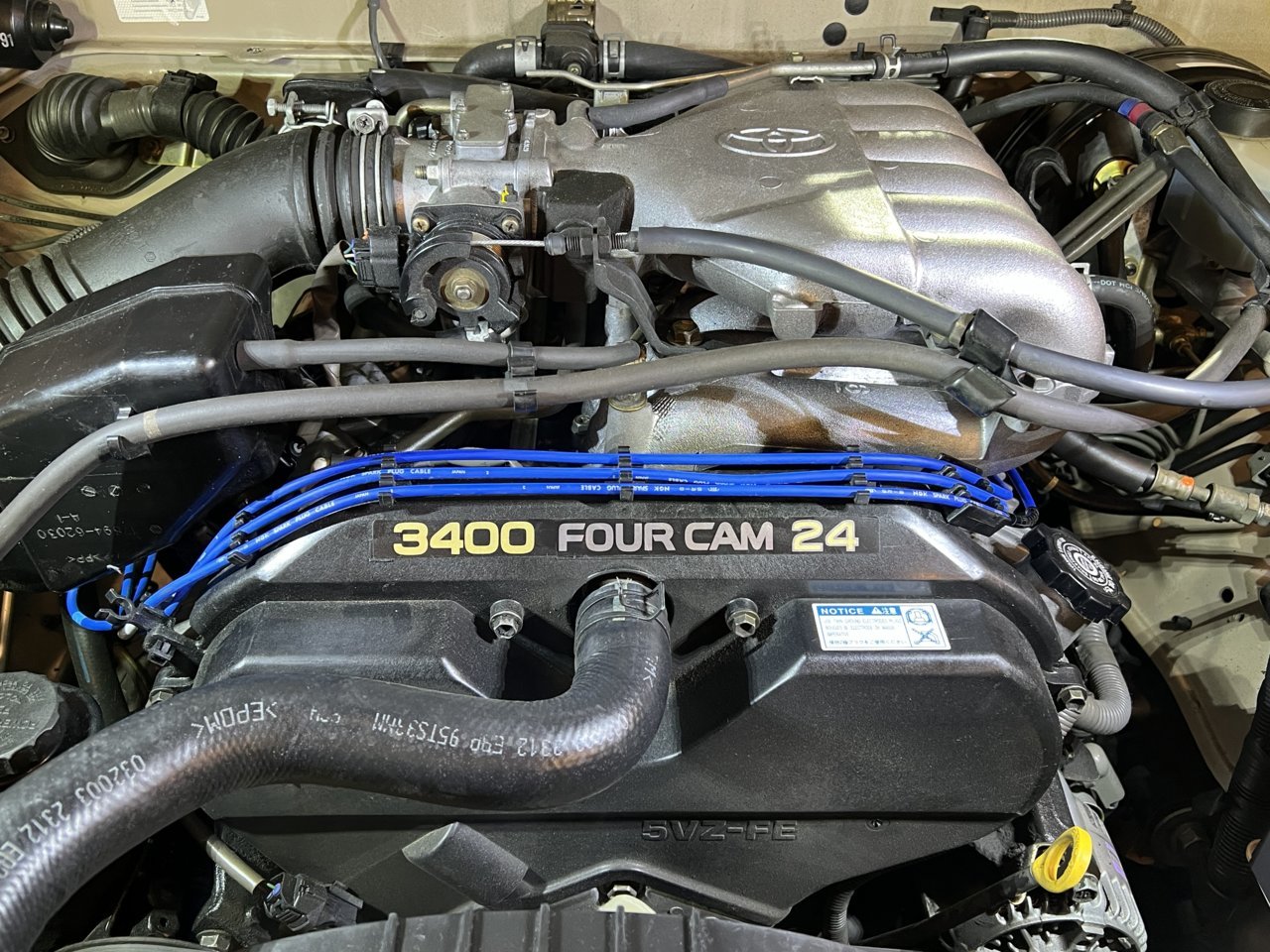

    Swapped the plug wires today. Replaced the 210k OEM Sumitomo wires with made in Japan NGK wires. NGKs are a longtime favorite for classic Toyotas offering excellent quality at a reasonable price.
    NGK part number for the 3.4 is RC-TE66
    Since the 3.4 uses 3 coils with wasted spark, there are only 3 plug wires. I suggest replacing one wire at a time to make routing easiest.
    My OEM wires were brittle and had the clips break in removal. Interestingly the new wires made no difference in the startup time. Not bad for nearly 20 years old and 210k miles on the original wires.
    I’ve used NGK wires on my other 22RE Toyotas and they have been perfect. On this set the #3 wire was slightly long compared to OEM. I’d still buy them again, but was a little surprised.
    Next thing to check for quicker startup would be fuel filter. It turns over 1-2 times more than I feel it should periodically. According to the local Toyota techs, they never change the fuel filter as it is a lifetime part, even at 200k miles. I’m betting that has more to do with what could go wrong on the old fuel lines though in taking it apart.

    I'm loving the attention to detail here and the OEM parts.
    Those wires should have a lifetime warranty on them too, depending on where you bought them. I put them on around 140k miles and at my last spark plug change around 265k I had them replaced because the boot that seals to the valve cover was starting to separate.
    I did my fuel filter around 180k miles or so I believe. I don't think I noticed much of a change in startup time. It was hard to say if it was a difference or if I wanted to feel like there was a difference after doing the fuel filter. I'd probably still change it at your mileage just to be safe. 292k miles on mine currently and it starts right up.

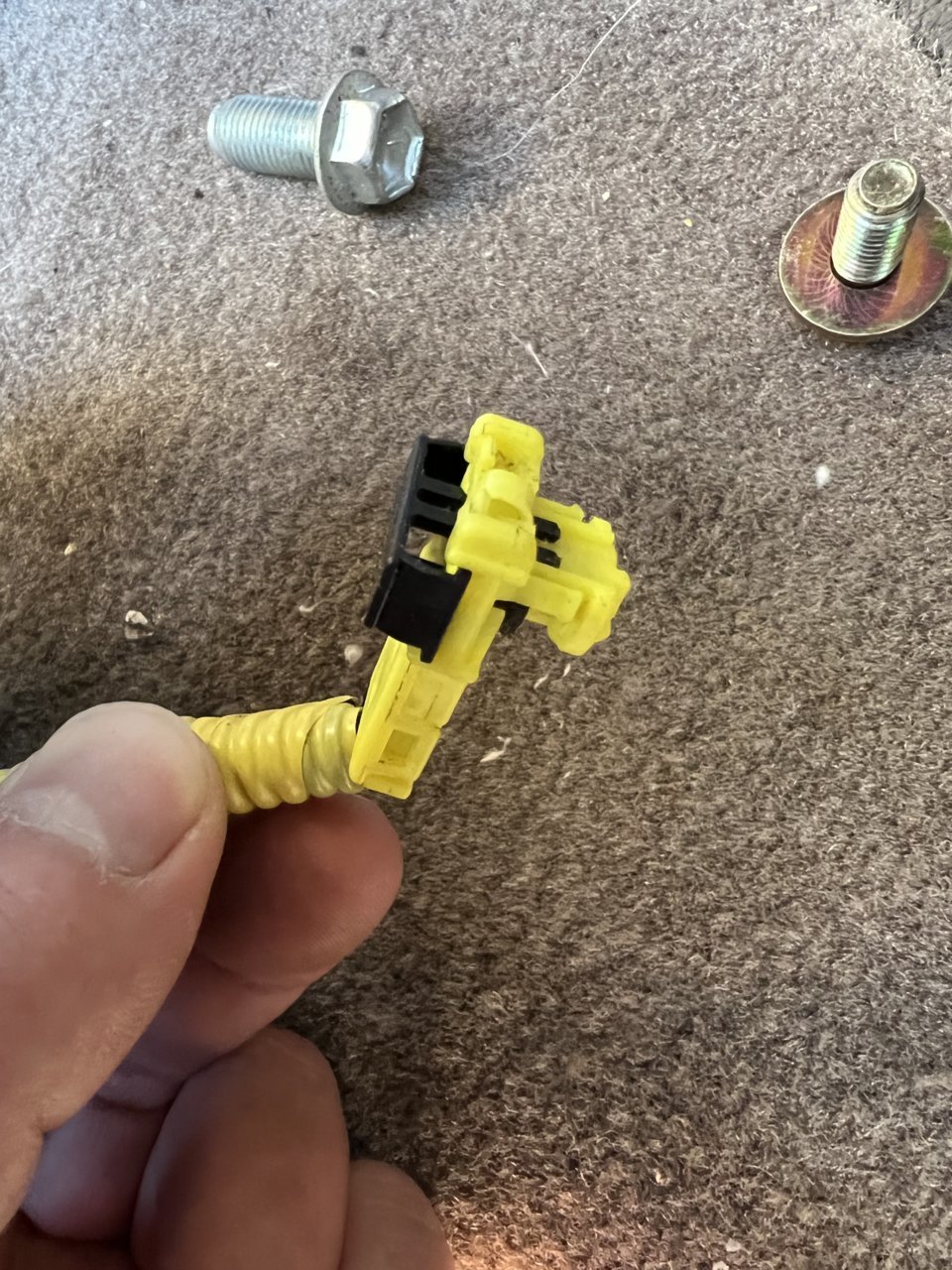

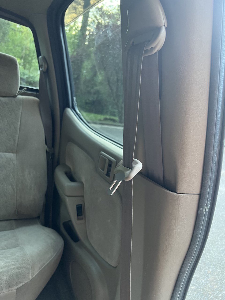

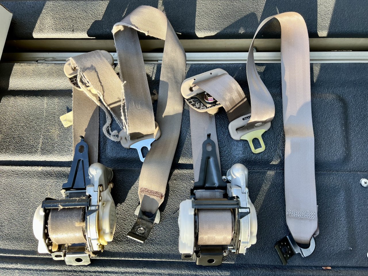

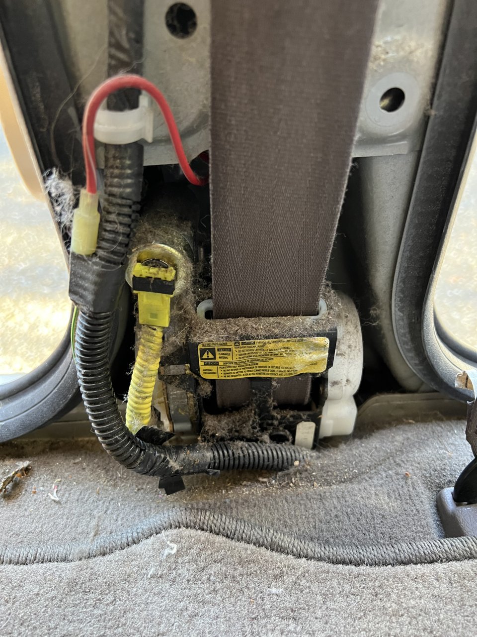

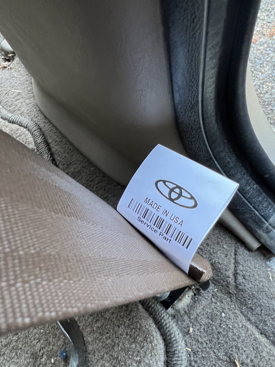

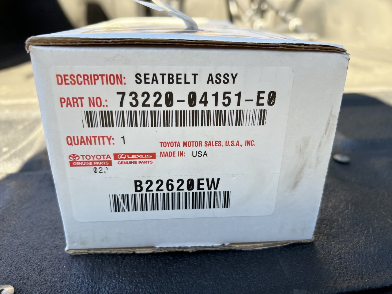

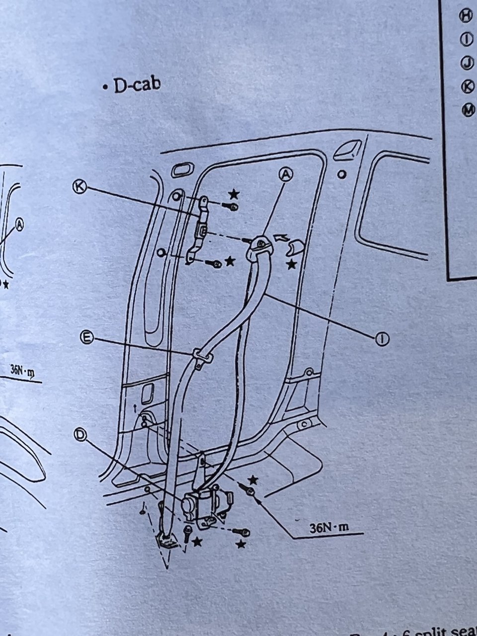

    Replaced the driver side seatbelt assembly today. The original was badly frayed and no longer retracted without help. While it still “worked”, it is one of those things you interact with every time you drive and to me it was worth replacing to work properly.
    OEM part number for 03-04 Double cab left front in Oak color: 73220-04151-E0
    (Yes 03-04 have a different PN than <02, I suspect due to the electrical connector)
    Turns out many dealers will not ship this part as it is deemed hazardous due to the explosive charge, or will charge you a ridiculous fee. I hunted around on https://parts.toyota.com/ for a local dealer that had the best price so I could pickup in person.
    ^The site allows you to compare online prices at dealers near you.
    Instructions with torque specs are included in the box.
    1) Disconnect the battery. Seat belts have an explosive charge in them to recoil in an accident. You want the power to be off.
    2) Remove the trim panel by first removing both lower door sills (which cover the base of the trim panel. The trim panel pulls straight off. I’m always paranoid on old plastic parts of breaking clips, but all remained intact.
    3) The seatbelt assembly has 4 15mm bolts holding it in place, 2 on the assembly, one at the belt adjustment on the B-pillar and one at the end of the belt on the floor.
    4) The electrical connector is removed by pulling the black collar back like so. There is one additional wiring harness strap to disconnect and the assembly is free.
    Old vs new. I should have not stood in the sunlight, the new buckle is chrome like the old.
    Install is just the reverse. Per the instructions, the torque specs are 32 ft-lbs on all bolts except the smaller bolt just above the roller assembly at 27 ft-lbs. *Converted torque specs, OEM is in Nm and kgfcm.
    After you’re finished, reconnect the battery, reset the clock and radio presets. And enjoy a properly functioning seat belt.
    Doesn’t look like much, but so nice when things function like they are supposed to.
    Only noticeable sign it has been replaced.
