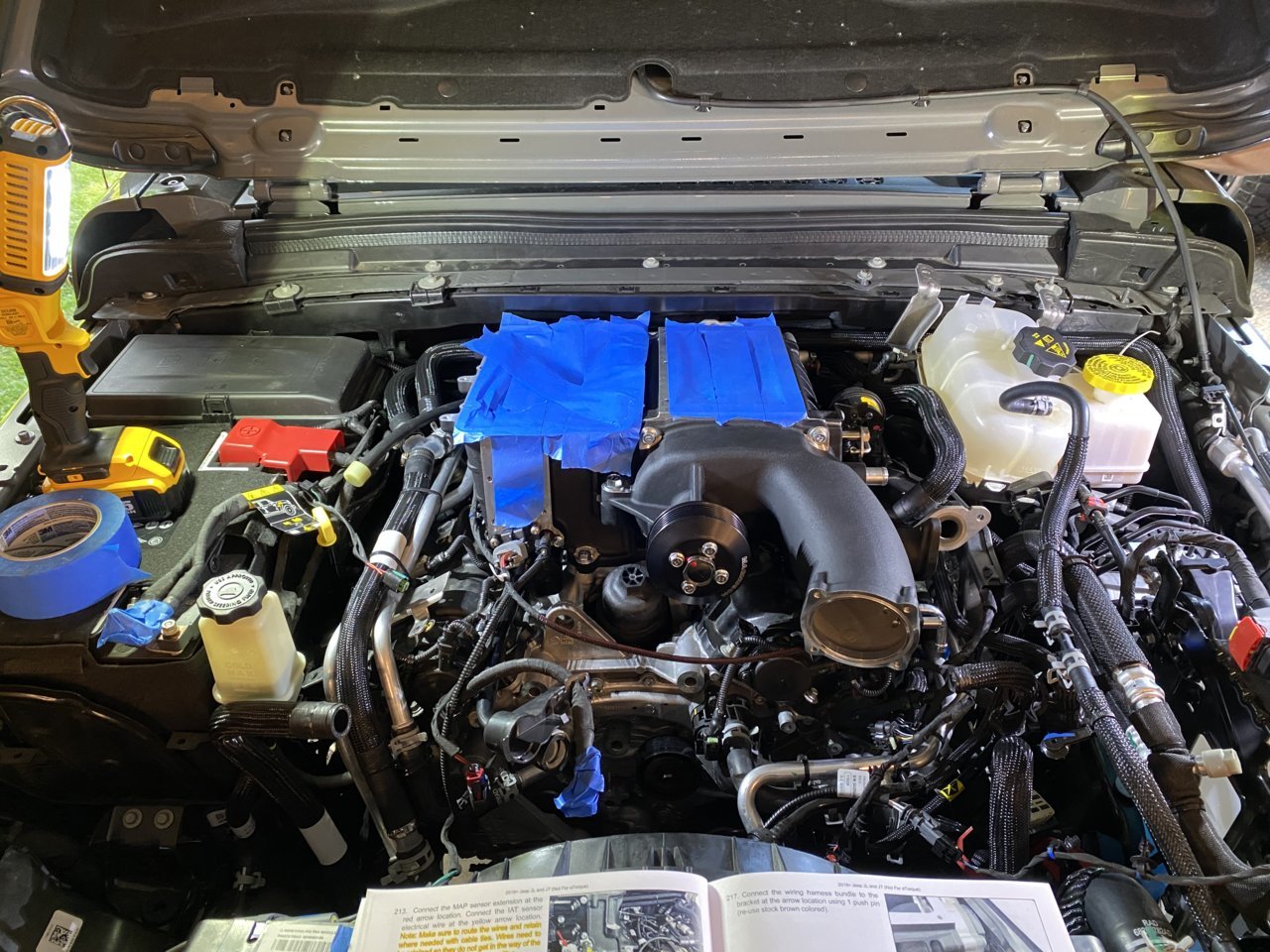

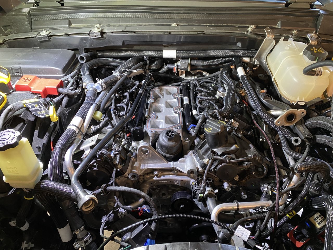

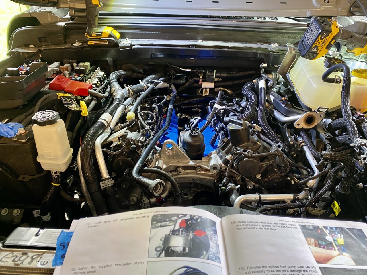

    Not quite 2/3s of the way through the install today. Lower intake manifold is now out which includes the fuel rail. Only one major flaw in the directions so far, but wasn’t too bad to work through. We’ve been tagging and bagging parts from every step separately.

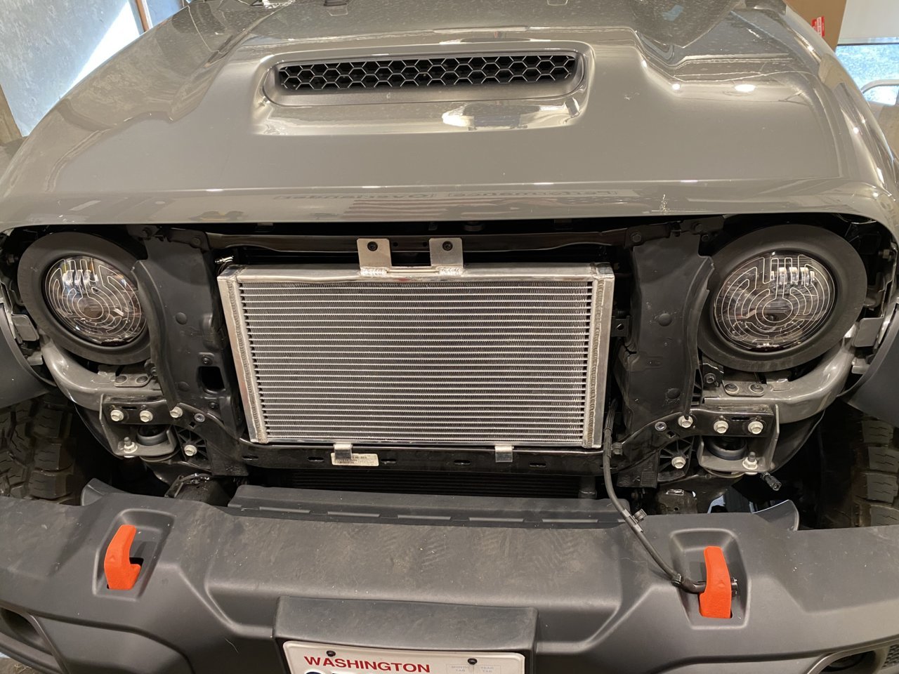

    While it doesn’t look like much, there has been a good amount of part installation today. Modified coolant hoses, several sensor wiring extensions, SC pump and wiring plus the new ordered plugs. Started disassembly of the front core area to install the intercooler. So far everything has been top notch in quality and execution.

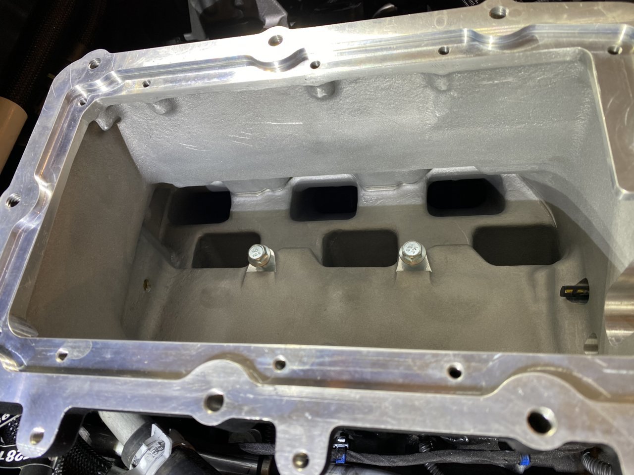

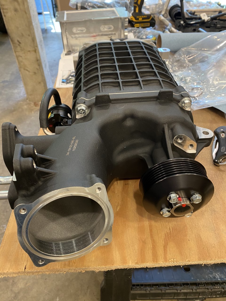

    Today major components started going in. Thanks for the hand @Kidwidataco

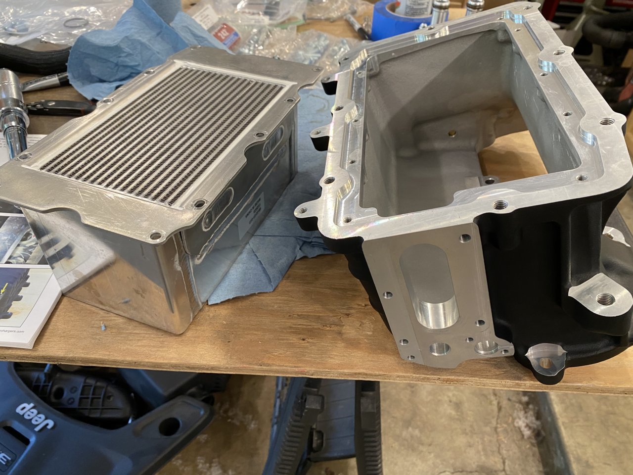

    New cast aluminum lower intake, replaces the OEM plastic unit, with new high flow Bosch injectors and fuel rail mounted. (Should have taken photo before install)
    Front intercooler. Did put a minor bend in it on the passenger side pushing it down to secure it in place.
    :annoyed:
    Upper intake and SC intercooler
    Mounting the upper intake. Don’t drop the bolts.

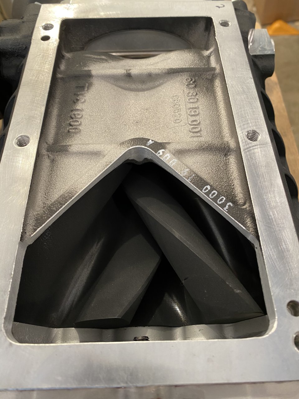

    The TVS1900
    SC lobes
    SC installed in place.
    Found a few more minor areas for improvement in the instructions, and was missing two standard hose clamps for the front intercooler and coolant pump install (fortunately I had spares on hand).
    Currently 79% done.

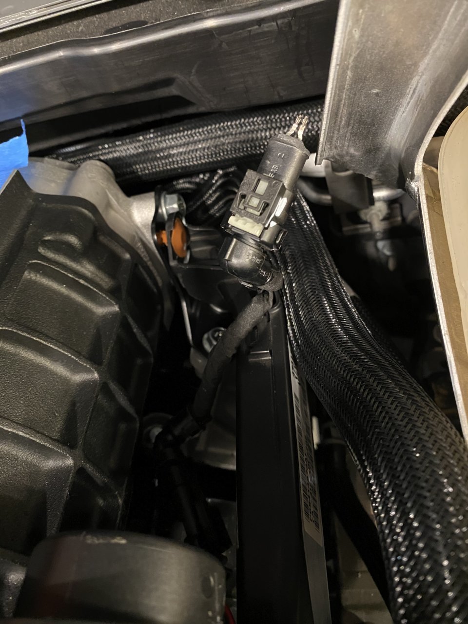

    I could use the help of fellow JL/JT owners to do me a favor! I have a severed plug at the back of the driver side engine bay. It is unclear what this connected to as nothing seems to be in the vicinity, it did have a ~1” white wire protruding from it. This plug is on top of the driver side plastic encased wiring harness near the firewall. It may be under the OEM plastic engine cover on an unmodified Jeep. If someone with a JL/JT 3.6 could confirm this connects to something, that would be helpful.

    I can’t identify the exact plug.

    Huge shout out to @Anderson who helped diagnose the severed connector on his JT. Turns out it is an EGR sensor, must have been damaged trying to pull the harness out of the way for the SC housing supporting bracket install.
    I’d just like to reiterate what an awesome community this is.
    Sensor with sheared off wires.
