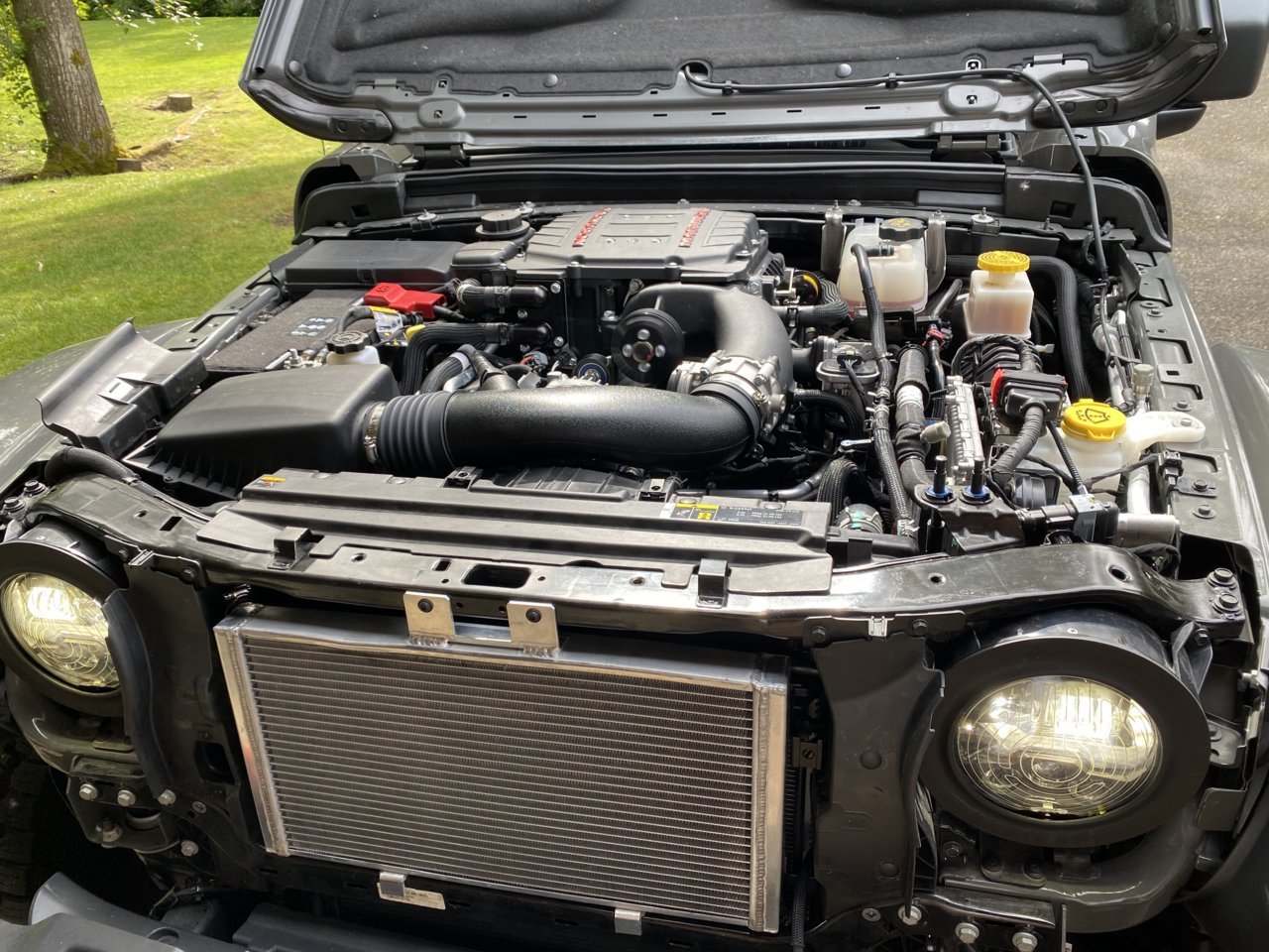

    On the JT, Jeep engineers had to make the grill openings larger than the JL for adequate cooling (primarily for towing). The frontal cooling area is pretty constrained on the JL/JT front core support, and adding a massive supercharger intercooler in front isn't doing any favors.
    Being supercharged on 37s, plus typically wheeling in hot steep terrain, adequate transmission cooling is a concern. This plug and play improved cooler looks very appealing.
    Some testing info here.
    https://www.mishimoto.com/jeep-gladiator-performance-transmission-cooler-2020.html
    On my supercharged Tacoma I swapped to a CSF FJ performance radiator. I haven't seen anything that extreme for the JL/JT platform, but Cold Case offers this all aluminum performance radiator. It improves over the original with full aluminum construction (no insulating failure prone plastic end tanks), larger tubes and more cooling fin surface area.
    https://www.coldcaseradiators.com/product/18-20-jeep-wrangler-jl-aluminum-performance-radiator
    I will likely pick up both soon.

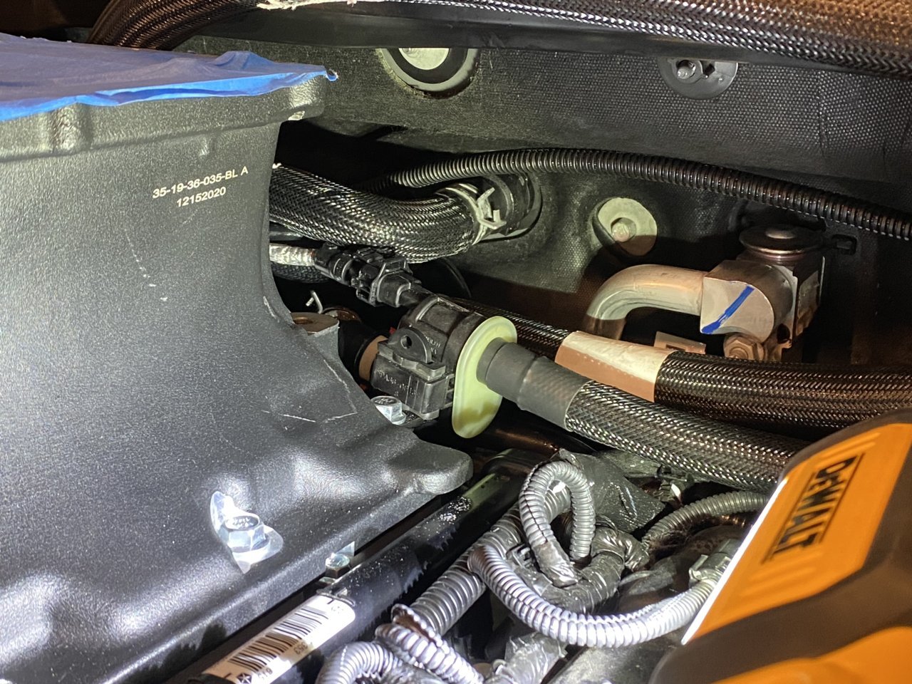

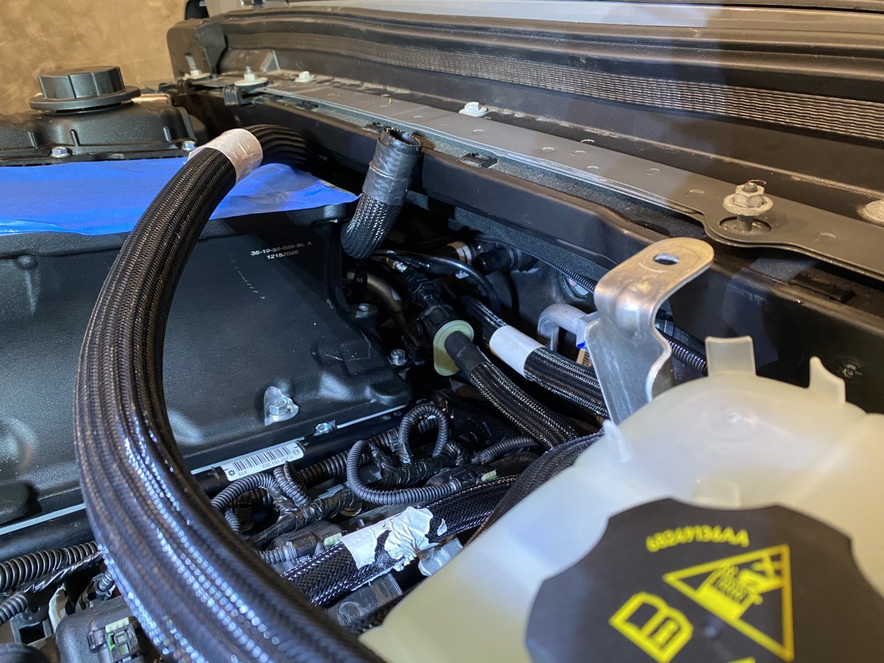

    Supercharger back out for coolant leak repair.F067FE2B-6C3C-47BB-8E0D-0198AE2AE2F0.jpg
    Here is the offending hose that did not get the hose clamp transferred from the OEM hose, feeding the driver side heater core tube at the firewall. Hose pulled up to attach OEM hose clamp. You can see how inaccessible the firewall location is.
    Hose clamp and hose reattached properly. Fortunately was able to do this without pulling the intercooler and upper intake assembly, even though it was a PITA to get the clamp positioned correctly in tight quarters.
    Back up and running leak free.

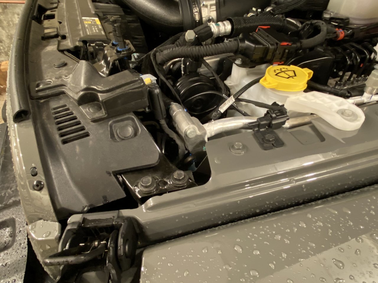

    The Magnuson kit relocated the external temp sensor from the front grill to the top of the fender next to the washer fluid reservoir. It is on the same harness as the horns. However in this location it is reading 20-30 degrees higher than outside ambient and not much use. I’ll need to investigate coming up with a better solution, because this doesn’t work.
