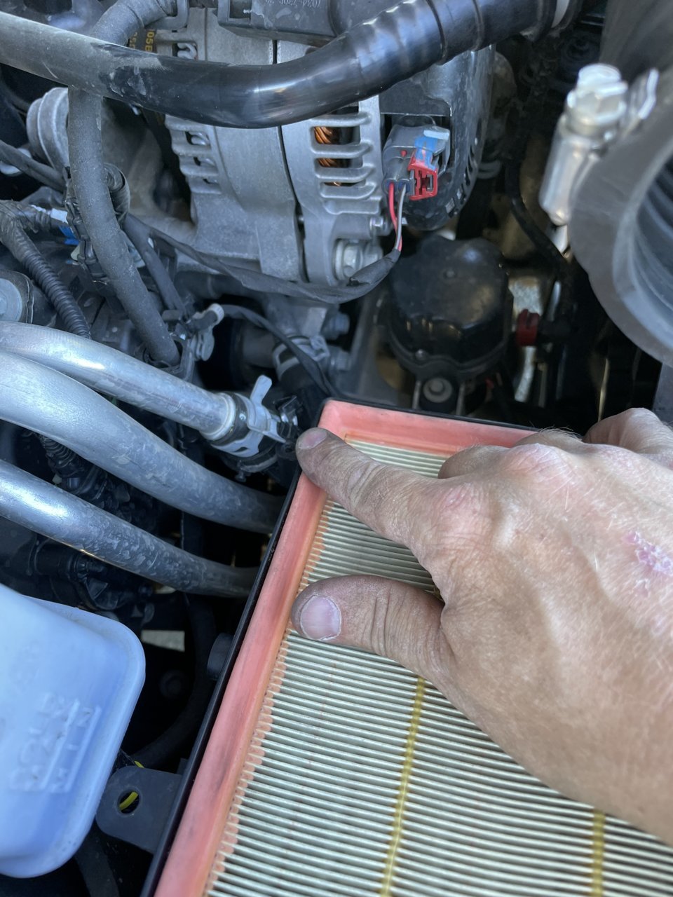

    I was routing some electrical under the hood today and this required me to remove my air box. This ensued a “Oh Jeep, why? moment…
    The assembly has never been sealed quite correctly, now I know why. That hose clamp is clocked in exactly the wrong spot, thus interfering with the clamping process of the air filter box top. I’ve been trying to figure out the irrational idle, I think I found it. Checking the filter media made me think of a performance filter. I pop on TW and check my current favorite thread and viola! a link is provided to the correct filter I was looking into.
    Electrical upgrade completed.

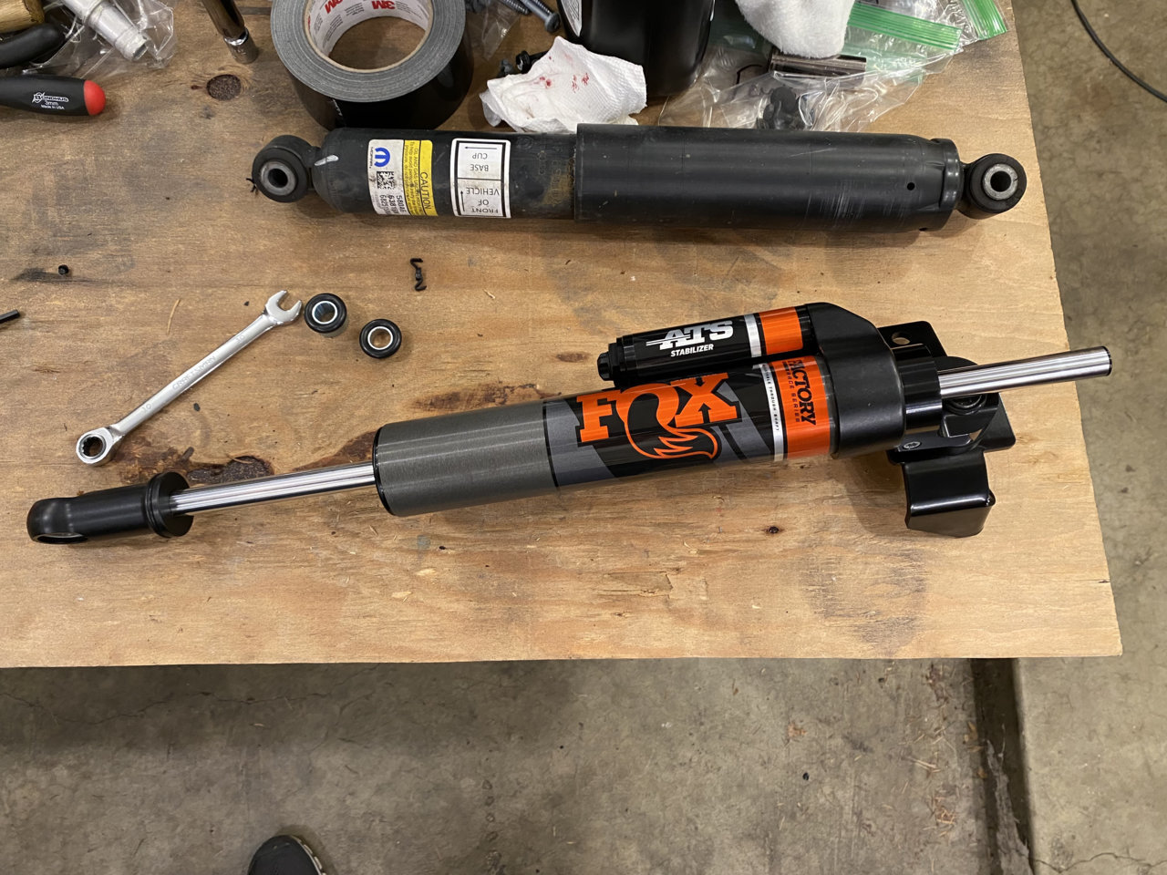

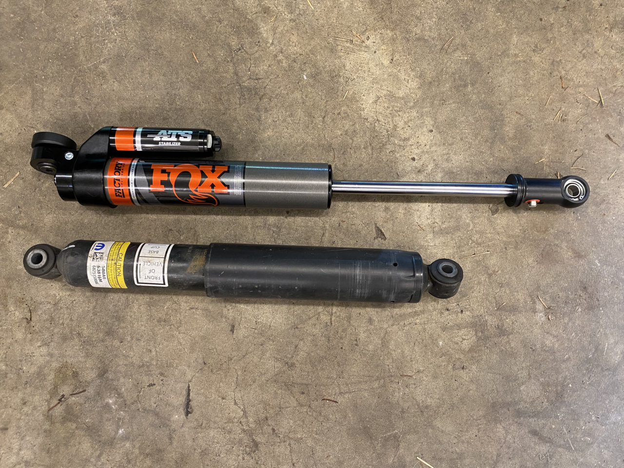

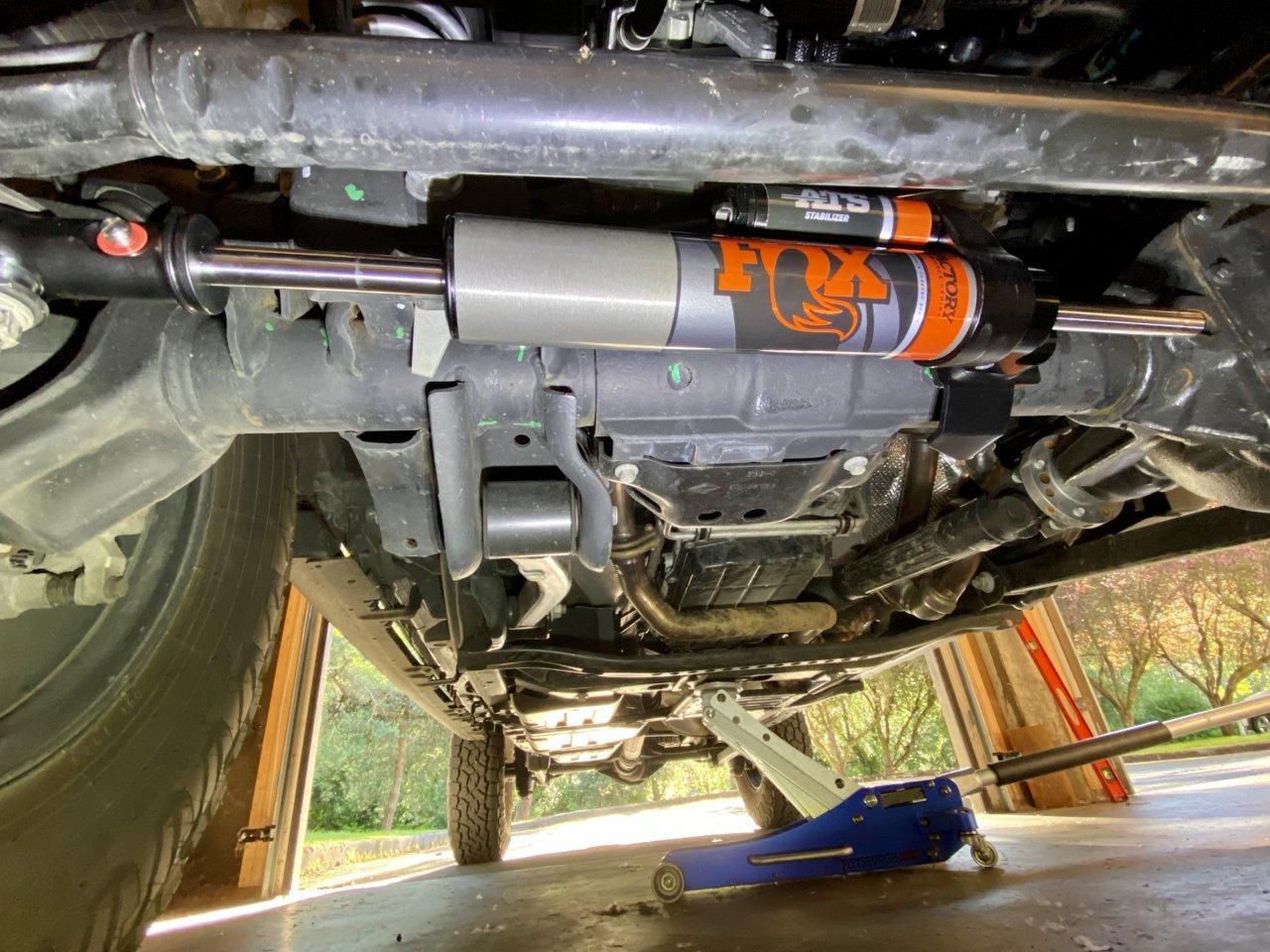

    Fox Factory Race Series 2.0 ATS Stabilizer
    The new Fox Race Series 2.0 ATS installed today. The through shaft design is quite different than the OEM stabilizer, which is supposed to allow for linear dampening throughout the entire steering range, rather than non-linear compression dampening only in one direction with the OEM unit. The solid front axle can feel a little numb on the steering, my hope was this will help the steering feel some. And of course my OCD wants the stabilizer to match the rest of the Fox Race Series shocks.
    The new unit is longer due to the through piston design.
    24 points of adjustment for dampening using the set screw on the left. Currently set to 20/24 firm to start and will evaluate from there.
    Pro tip for install. This kit replaces the OEM stabilizer bracket. On the new bracket, install the top mounting bracket bolts first, then the bottom. I did the reverse, couldn’t get things lined up completely square and ended up causing me to need a M10x1.5 tap.
    Looking forward to trying it out and dialing it in.

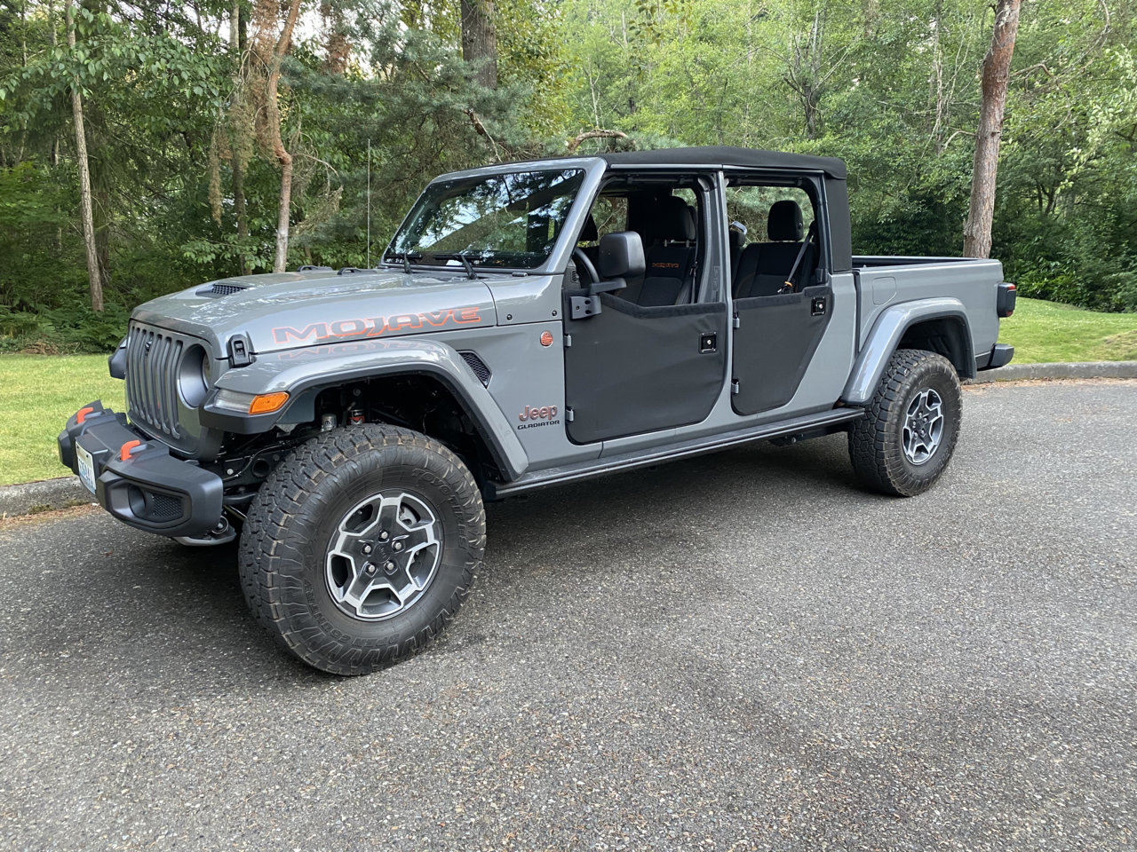

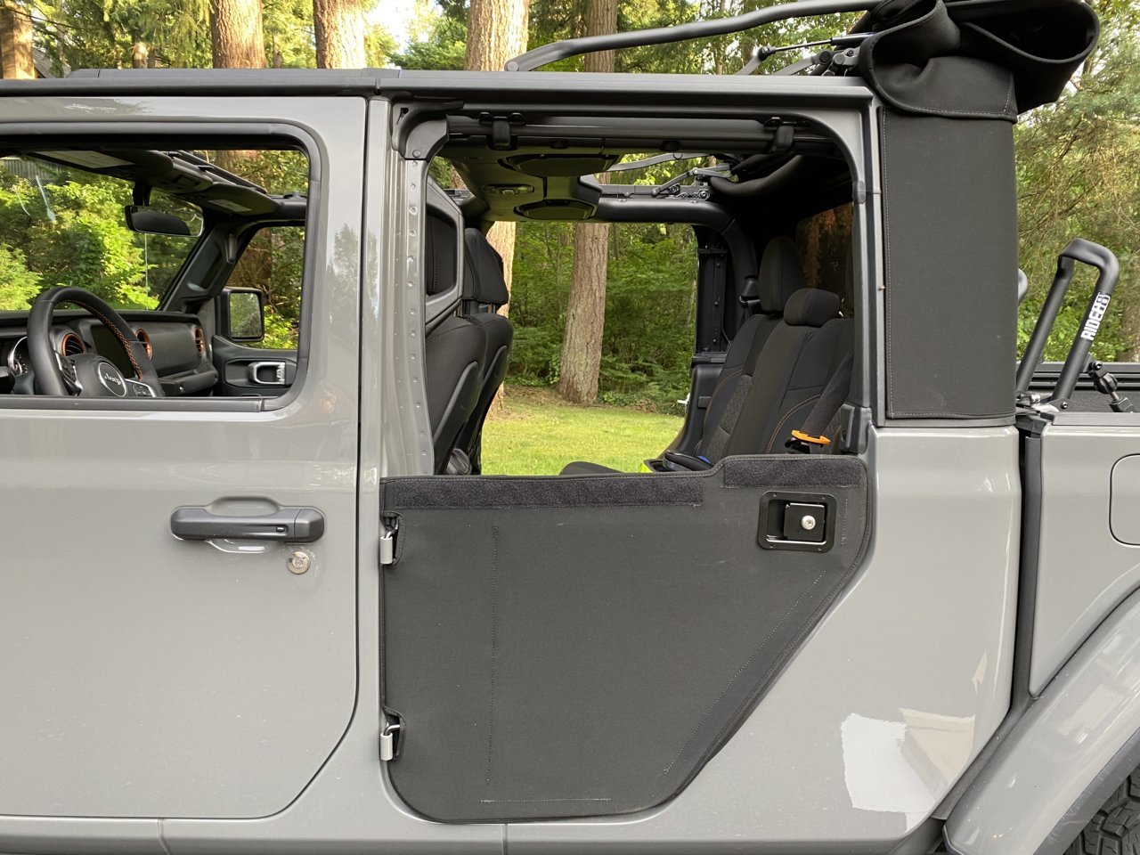

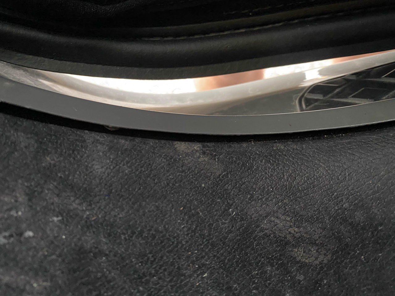

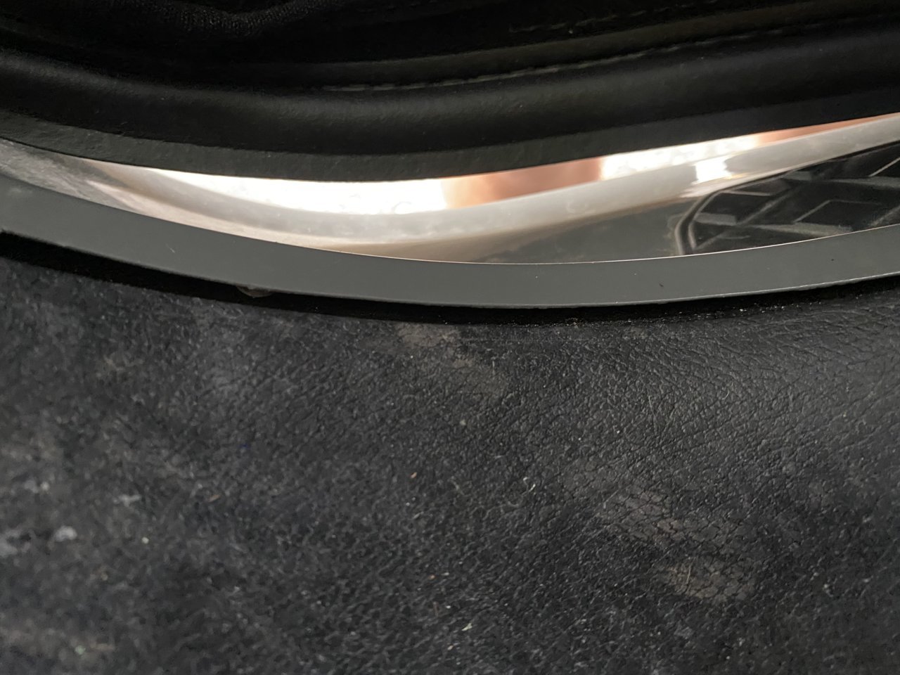

    I had Bestop 2 piece soft doors on my TJ and they were fantastic, offering convenient doorless, half door or full door quickly with minimal effort. Severely disappointed in the fit on the JL/JT version. Huge gapping in areas and major overlap in others. I’d swear this was a knock off brand based on fit. Not at all the quality I was expecting from Jeep’s OEM supplier.

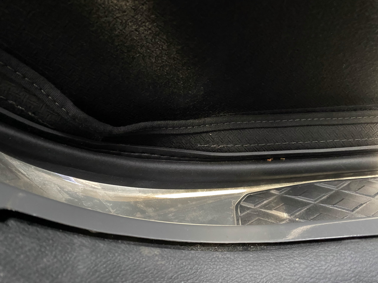

    Is the second photo the gap between the bottom of the door and floor?

    Yes, and the gap extends around to the lower front door hinge. You can easily stick your hand through the gap. While the rear of the door (rear of truck) has overlap and the weatherstripping gets awkwardly pinched out of the door, looking poor. These are their premium doors that go for almost $1400.

    Oh, and I am waiting on a review on the Fox Steering damper. I like the design, but not sure of longevity. Plus, Ive never had great luck with Fox durability in daily driven applications. I now have 19k on the Gladiator(work truck) and I still feel like the Rubicon shocks are under valved.

    I haven't seen them in person yet. But I do agree that would likely be the ideal product I am looking for, with much better fit and finish. I haven't seen them available for order outside of an initial vehicle order option yet though. And curious if they will be able to be optioned with paint, or if it will be raw and on your own for painting.
    I was able to get a bit better fit on the Bestop doors, adjusting the lower hinge mount, reducing the velcro tightness to add to more weather stripping depth in some areas while tightening it in others to reduce it. Then just bending the door by hand to get the bottom to seal better. It is significantly improved. But still not on par for the quality I expect at this price point.

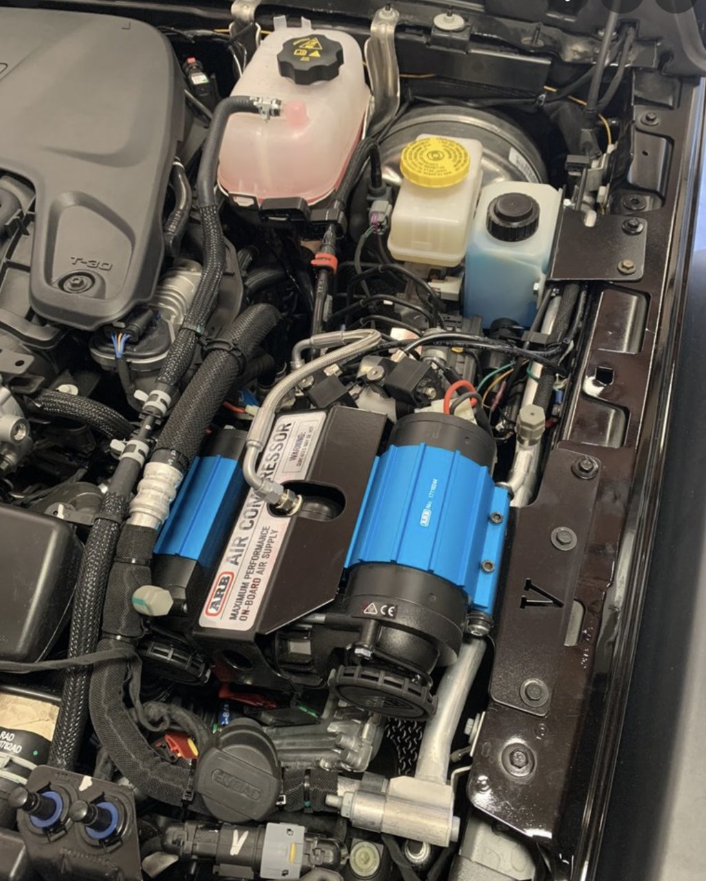

    Agreed the RIPP unit looks quite nice, with notably larger capacity, that looks like a very solid unit. I'm looking at mounting my ARB twin under the hood, and with the supercharger that has made that much more complicated. Currently looking at the Varozza 4x4 mount: https://varozza-4x4-outfitters.myshopify.com/products/jeep-jl-jt-arb-twin-compressor-mount
    This relocates the washer fluid to where many catch cans go. I think the Mishimoto one might still fit, though it is much smaller, but I also have the SC coolant lines to run in the same location. All other dual underhood mount locations I've seen are occupied by the SC coolant pump, or the SC coolant reservoir. Smaller washer fluid reservoir shown next to the brake booster. Even with this setup I'll have to cut the OEM harness and relocate both the temp sensor and horns, since the SC kit places them right where the ARB compressor sits.
