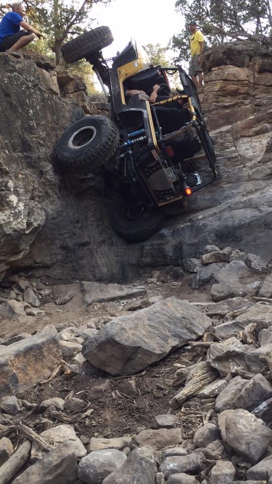

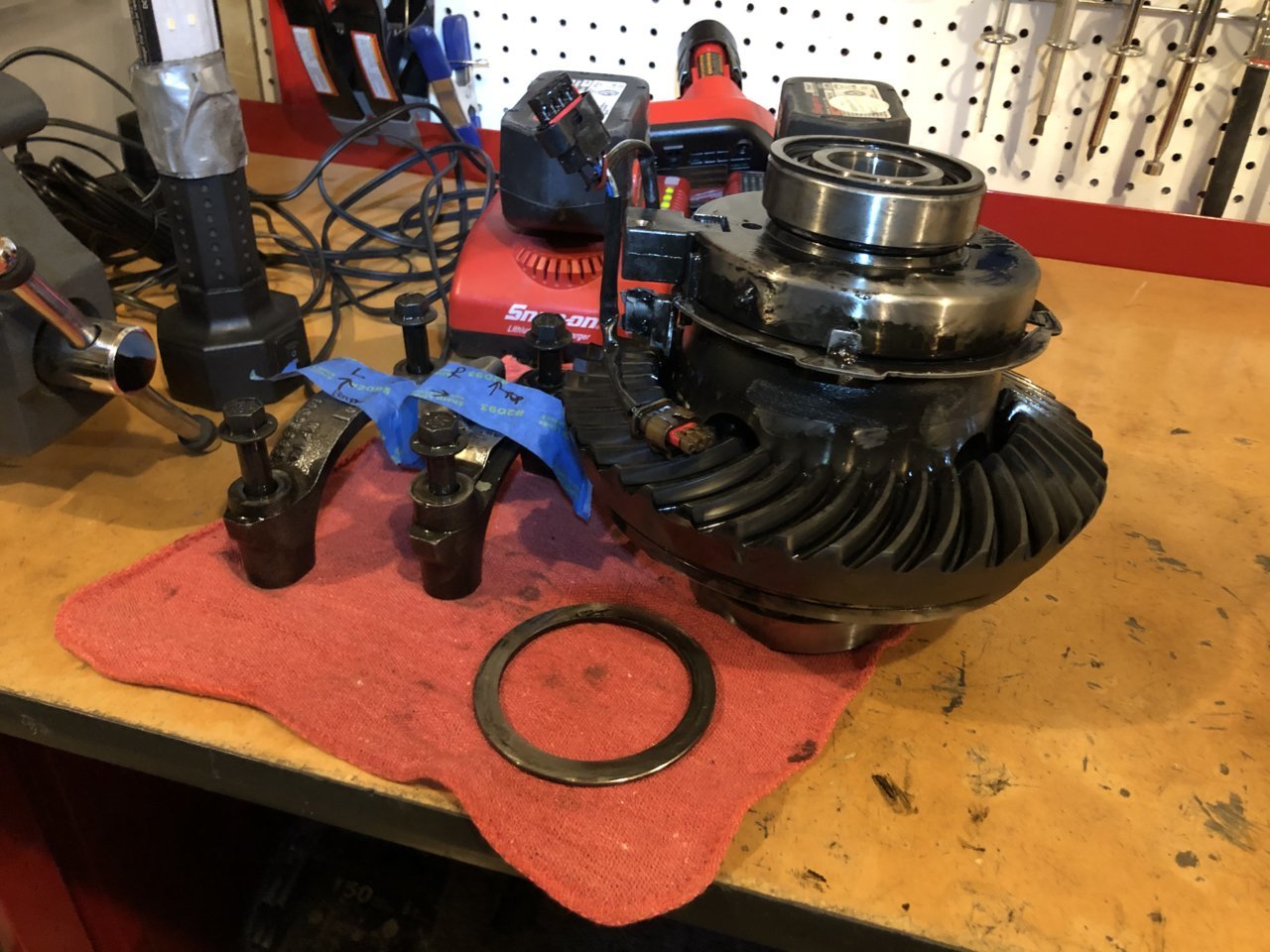

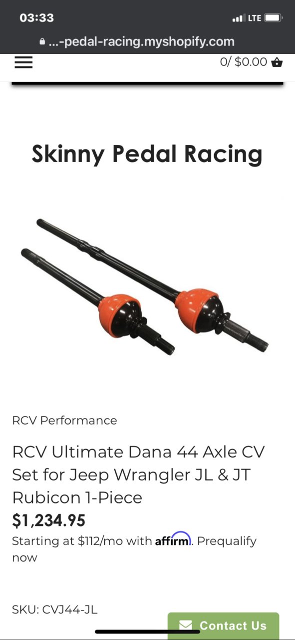

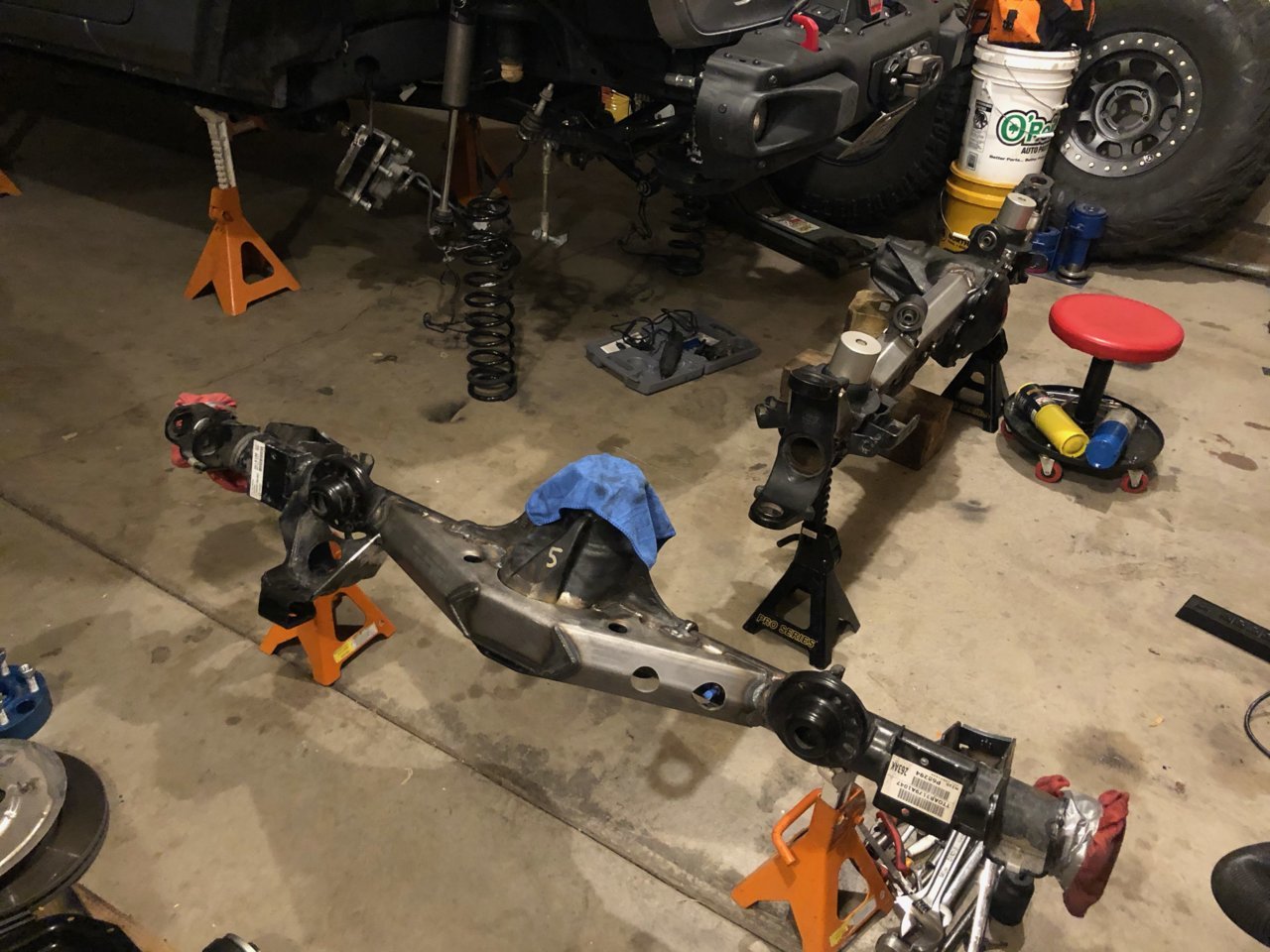

    Any more drivetrain mods coming?
    We tore into my buddies JL pretty good.
    115095B8-EE84-4BAA-A5B1-D0DA1FC3EC74.jpg 3DCCBD66-03D4-4572-AB8E-0E6290A93302.jpg F4E820CD-022F-4F56-BFB7-3199182F2670.jpg 56ACFD2D-D150-48B4-8AE1-6F61A0A5A5C3.jpg AC466FD6-0738-4B92-85AF-B9877533683A.jpg 4F91E792-1989-4F14-AB02-C25432AEDD2F.jpg D531DBB6-B0B0-4128-B01A-9B59DEFB7D24.jpg

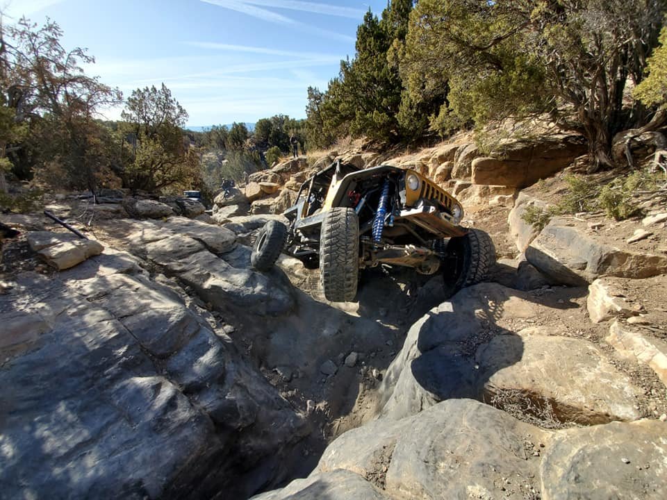

    The western slope of Colorado is a blast as well.
    Let us know if you do. We can load up our junk on trailers and scratch and dent our stuff, and then take you on some more reasonable trails…faster ones. Hell, you can even wheel my junk. I’ll drink Colorado Wobbly Pop.

    Nice! The Mojave already has HD cast iron knuckles from the factory. I plan on a regear to 4.56 with the 37s, which should weigh 91.5lbs per corner. That would return the effective gear ratio, factoring the tire, to stock. Of course with a regear it is the right time to add a front locker, which is tempting. It would also be the right time to add chromoly shafts. Those RCV ones are quite nice! Nicer than the ones I was looking at. Undecided how much I want to sink into the axles though, and if chromoly is really justifiable for what I do.

    I wonder why the Rubicon comes with the aluminum knuckles? Must be trying to shave weight. If you are not "rock crawling" it most likely wouldn't be an issue anyway..ever. I did have a ProRock knuckle break once in a very difficult trail. That learned me a few things about having double sheer. I was right in this location with my brothers Ultra4 car that was beat.
    We went with 4.88's with the 37's. That JL moves along pretty good (4 cyl turbo). With the V-6 SC, 4.56 gears will be great. It just blows my mind what kind of output you can get with the V-6. Adding a locker is a toss up. If you are not climbing rock faces and ledges...do you want the added cost, maintenance, and the needed stronger axles?
    The only time I think body damage is acceptable is if you are on trails like the pictures above. Even then I get all worked up on damage like that to clean rigs. Guess I have had trailer queens for far to long.:rofl: The guys I have been out with from TW get after it and don't cry when it happens. Pretty sure I was more upset than they were.
    Our group also doesn't take people where we know they will break or get damage. I like having fun, not wrenching all day on broke ass rigs.

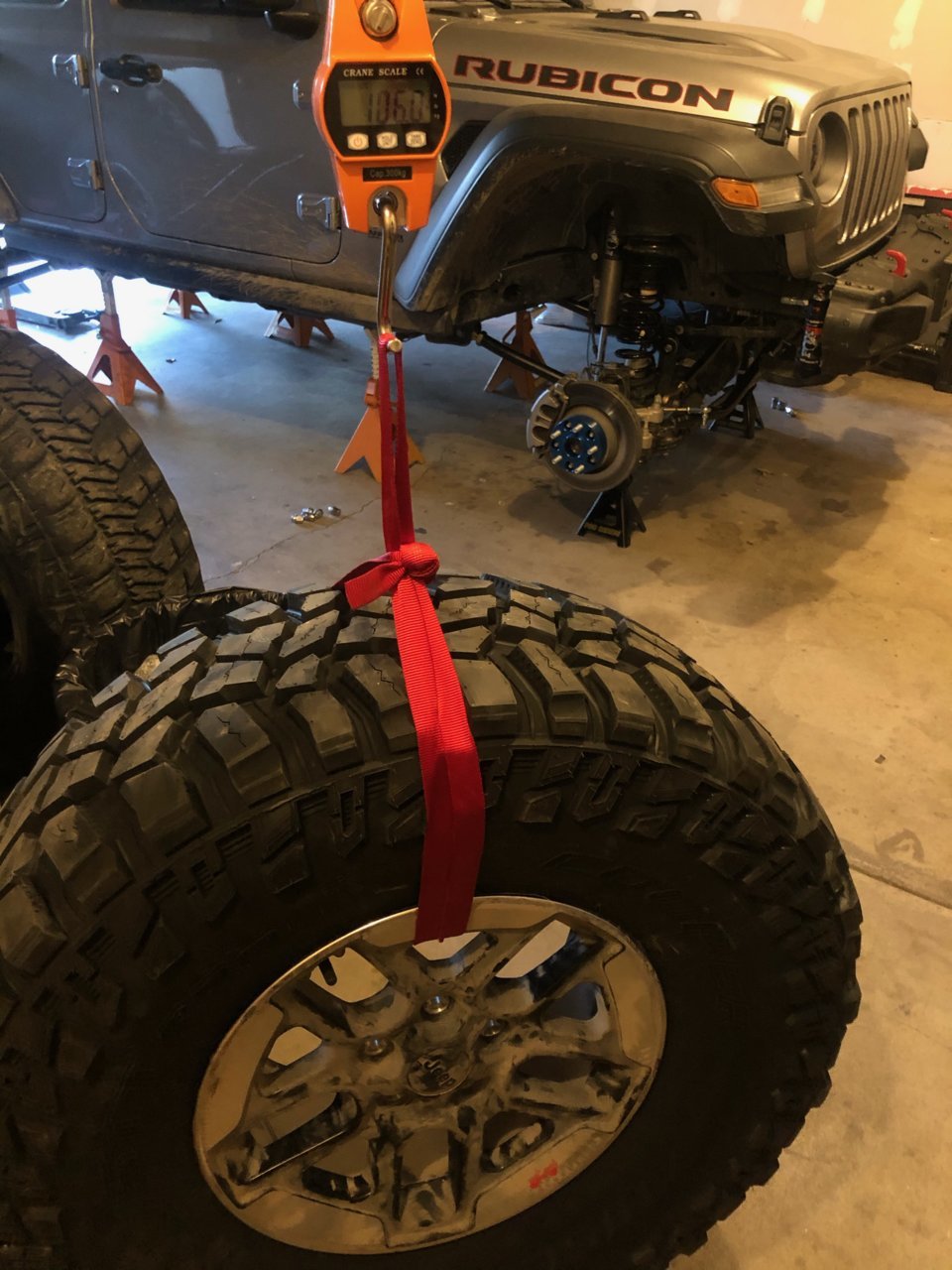

    Maybe you've already bought your wheels, but in case you are still shopping:
    The AEV Savegre II is 31 pounds (so a little lighter than the AEV Pintler which is listed at 35 pounds). Both have a +25mm offset, which AEV recommends for 12.5" wide tires (35s or 37s) on Gladiators, and both have a load rating of 2,400 pounds. Both are priced at $260 per wheel.
    One you haven't mentioned is the Method 703 which has the same offset as the AEV wheels (+25mm). These weigh 30 pounds; and the load rating is 2,650 pounds. These are around $275 per wheel. One pound lighter, and a little stronger than the Savegre.
    Yeah, the Volk racing wheels you mention are super light (18 pounds), which is awesome. On the downside, they are not as strong a wheel as the Savegre or Method 703 - Volk doesn't seem to publish the load rating, which is a little concerning. You talk a lot about speed, and you are going with aluminum skids, so it doesn't sound like you plan on building a heavy JT. Are you going to tow much? If not, maybe you can get away with the Volks. The +16mm offset should be okay since you want to run an 11.5" tire, not a 12.5" - but what if you end up deciding to go up to a 37-inch tire? Are there any 37x11.5 tires? If you have to go 37x12.5, you'll be getting poke with the Volk wheels. Another downside, as you mention, is price: they are about $750 per wheel. That would really suck if you moved up to a 37x12.5 and wanted to sell the Volk wheels to get a wheel with +25mm offset.
    I guess it comes down to how badly you want a light wheel: there is a significant strength and price penalty for those Volks, and they give you a little less flexibility with your tire sizes. That was my .06 cents - up from .02 due to current inflation ;)

    Pulled the trigger on Method 313 flow-formed wheels in 17x8.5 with +25 offset, at 23.5lbs. Same dimension specs as AEV at a much lighter weight point, and most importantly lighter than stock. Load rating is also 2650lbs. I did decide to go to 37s for a variety of reasons, and will be running the new Ford Raptor OEM 37x12.5r17 KO2s, designed to be lighter and C-load. Just waiting for them to be released to the public. Net gain for the wheel/tire combo from stock 33s to 37s should be around 4lbs per corner.
    Vehicle performance is important to me, and that means minimizing weight everywhere possible. I want a built rig that can excel on the trail and still perform on the street. The 1/4" aluminum skids will be drastically stronger than the stock skids, lift the underbelly into the truck to provide higher clearance, provide a continuous smooth surface and replace those laughable stamped cross members with vastly improved stronger steel ones. Net gain on the skids is +10lbs, to replace tin foil with seriously strong full length continuous armor protection. I ran 1/4" aluminum skids on my Tacoma, while that certainly isn't acceptable for the most extreme wheelers, it is plenty for what I do.

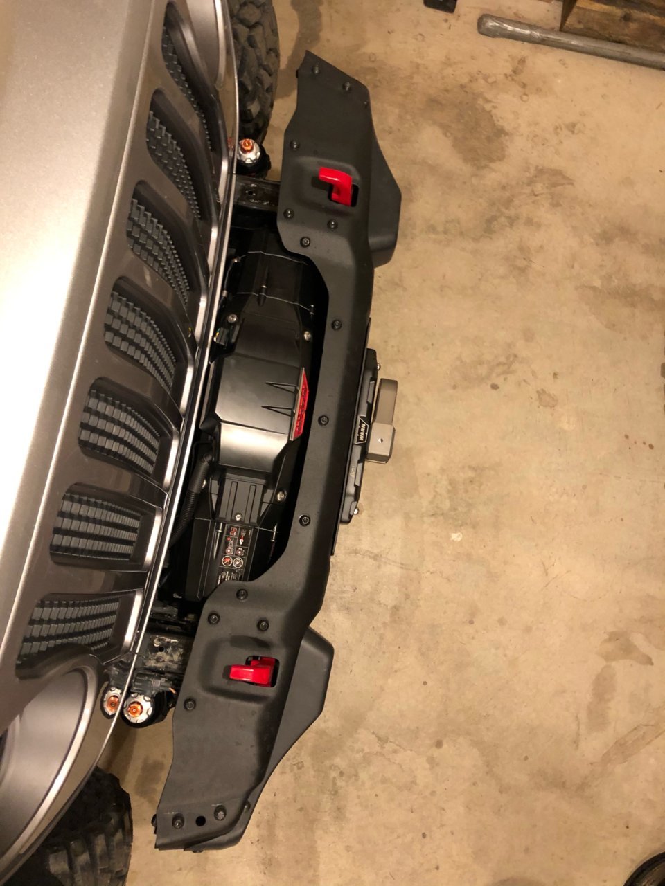

    Is that BAMF’s front bumper? Looking to pull the trigger before midnight to take advantage of the 15% off sale. Got anymore pics you could PM me?

    Yes, it’s the first BAMF bumper on the market. Technically speaking, it’s a prototype, as he has made a few small enhancements since mine was made.
    [EDIT] Woops, thought you meant the Tacoma front Bumper… It is a BAMF bumper. Jerry still hasn’t designed the skid plate for the sway bar disconnect, but that should be coming soon. [/EDIT]
    The sale price is totally worth it, and I hope you pulled the trigger.

    It’s all good. I didn’t pull the trigger. It’s a good price on sale or not. It’s between BAMF and Metalcloak’s frame built bumper. Both good options, and based off my previous dealings with both companies, both good companies to support.
