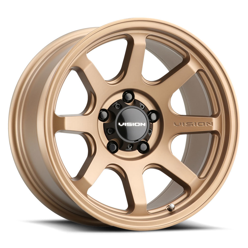

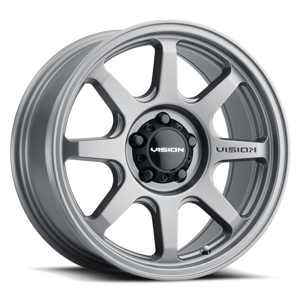

    These Vision Flow 351 wheels look very interesting:
    Mojave stock 17x7.5 +37 24.4lbs
    Method 313s 17x8.5 +25 23.5lb
    Vision Flow 351 17x8 +30 23lbs
    https://www.visionwheel.com/wheel/14765/VisionWheel/351 Flow?finishID=3293
    Im confirming with Vision if that weight spec is accurate, as I’ve seen different numbers than the manufacture on other sites. I’d prefer an 8” wheel over an 8.5” and find the .5” width diff from min KO2 width spec acceptable. +30 will push them out just a little over stock but keep the tread under the fender, question will be is it enough to prevent rubbing? Slight twist is Jeep hubs are 71.5mm and those are 78.1, but there are 78.1->71.5 hubcebtric adapters. I think it might work and could be a solid win, if the weight spec is confirmed. Question then will be matte silver or bronze with the sting grey.

    I vote bronze.
